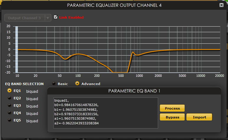

Bushmeister my question was meant to be how much EQ you used, if you could post a screen shot of your mindsp settings it would give me a better idea of what you needed to apply to get the response you posted 🙂
Thanks for the sims!
Here is a screen shot of the EQ applied for the woofers.

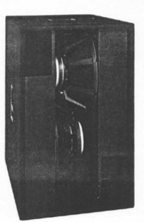

You could cut a round hole in your cabinet and mount it on a sonotube (or PVC pipe) stand to increase the volume, lower the Fcb and reduce distortion. With a foam weather strip gasket between the two, the weight of the cabinet would probably be sufficient to eliminate air leaks. You would then have enough volume to make bass reflex tunings viable, increasing sensitivity and reducing distortion further.

Unfortunately my cabinet is only 18 inches wide - so 15" woofer is max.
If depth is not a concern, you could easily fit one or two slot loaded 18" in a 15" wide cabinet, similar to the EV MTL2. This arrangement can also be done as push-pull to reduce even order HD, and gain some cabinet volume lost to the plenum (slot).
Another advantage of the dual driver set up is cancellation of mechanical force, the cabinet won't wobble or "walk" at high LF drive levels as a front loaded driver will.

Nice idea Art. However I would like to keep the sub box to the same depth and width of the synergy horn cab to help them look purpose built as a couple. So thats 18" wide and 17" deep.
Probably not enough room to slot load, but to be honest a sealed well braced 80l cab with something like the faital pro 15hp1030 and 500w, is more than enough for my needs. 🙂
