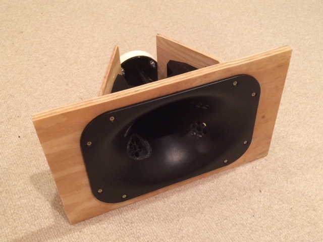

Baffle board completed
I hate cutting plywood. 3/4in ply is used for the baffle board 11.125 wide x 18.25 high. I just could not make the the 17in high goal however below 19in still qualifies as a "book". 🙂

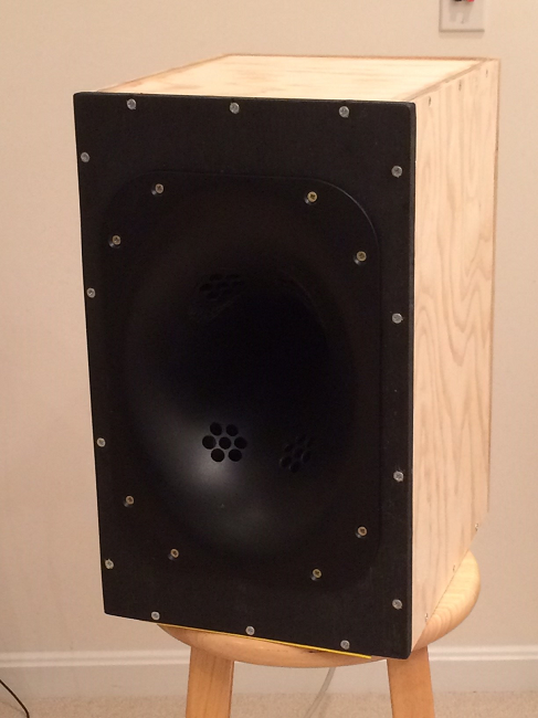

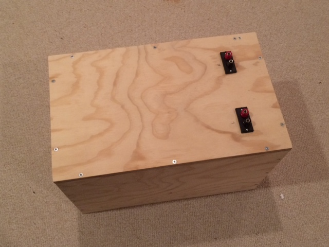

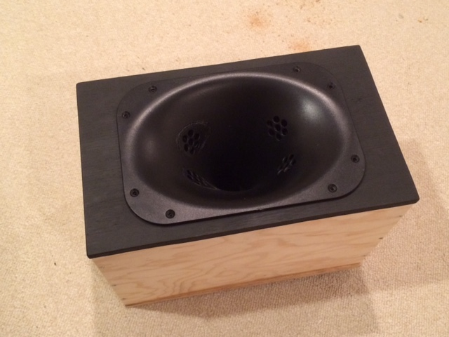

More progress, baffle painted and binding posts installed. Once paint dries, install baffle to box, horn reinstall, add fiberglass, work on bracing driver boards to box. Lot's of little steps still need to be done so may be a while still before complete.

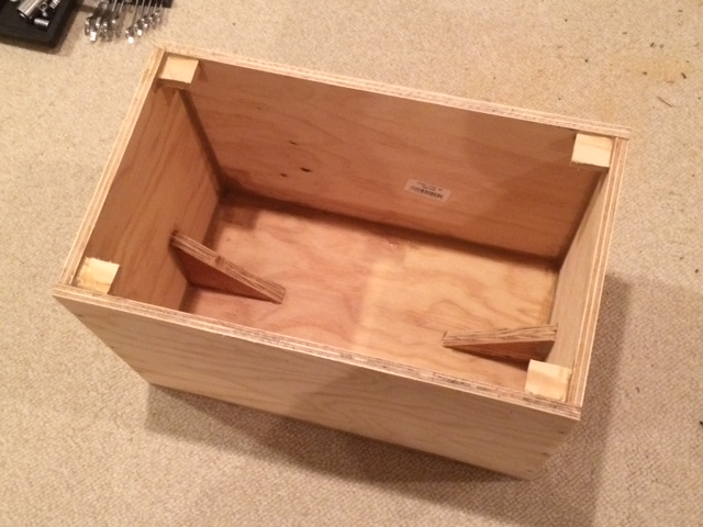

I had a setback with the starfish. It turns out the real 3d scan is so complex that I could not convert to a solid body to manipulate. You can print it as is but not manipulate. So I have to make my own starfish from scratch.
The box volume is about 30 liters and I wonder how the bass response is going to be. In any event, the bass extension and Q an always be modified with a LT.
I don't have sorbothane and fear some cabinet vibrations are going to get the better of me on this build.
I am not sure if I will ever get the headphone effect as I don't have it in me to make a stereo pair. Just too much work to make the box.
