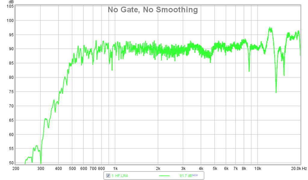

X, what does it look like gated before the first reflection and not smoothed at all?
And another way of viewing/plotting the FR, no gate and ERB smoothing, as that is said to follow the way we listen/hear.

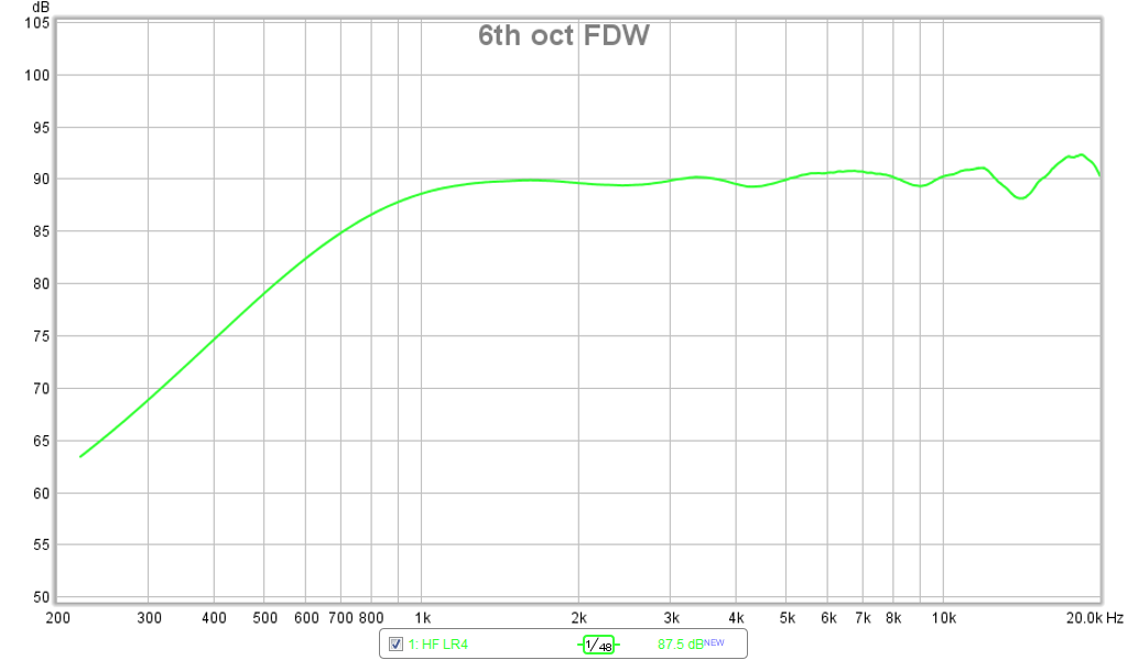

I used to EQ with the 4ms gated response as well as ungated response. Having now tried the 1/6th oct FDW to base my EQ on - I have to say this way provides a more accurate and robust EQ that is good for a wider range of polar angles. I think the FDW method helps to prevent over-correction of stuff that shouldn't be corrected.

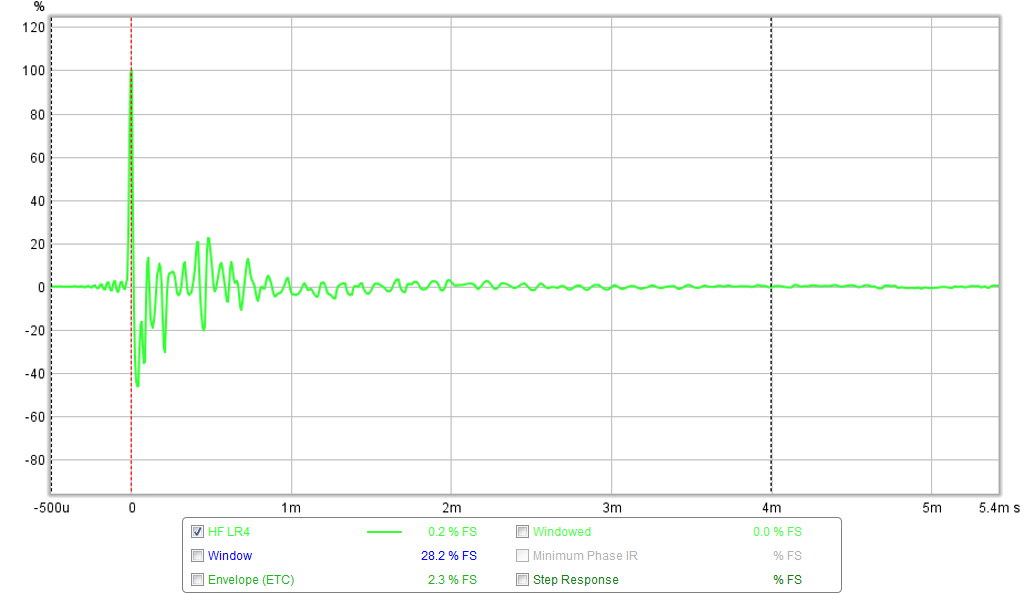

Here is the IR to show that there is no reflection before 4ms:
Here is the data with no gating, no smoothing:

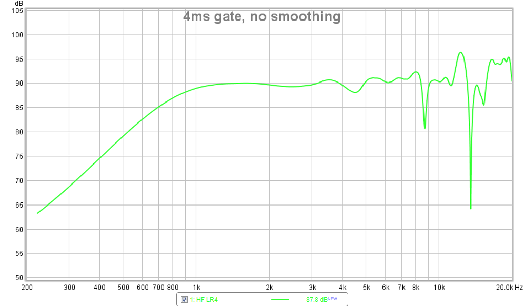

With 4ms gate and no smoothing:

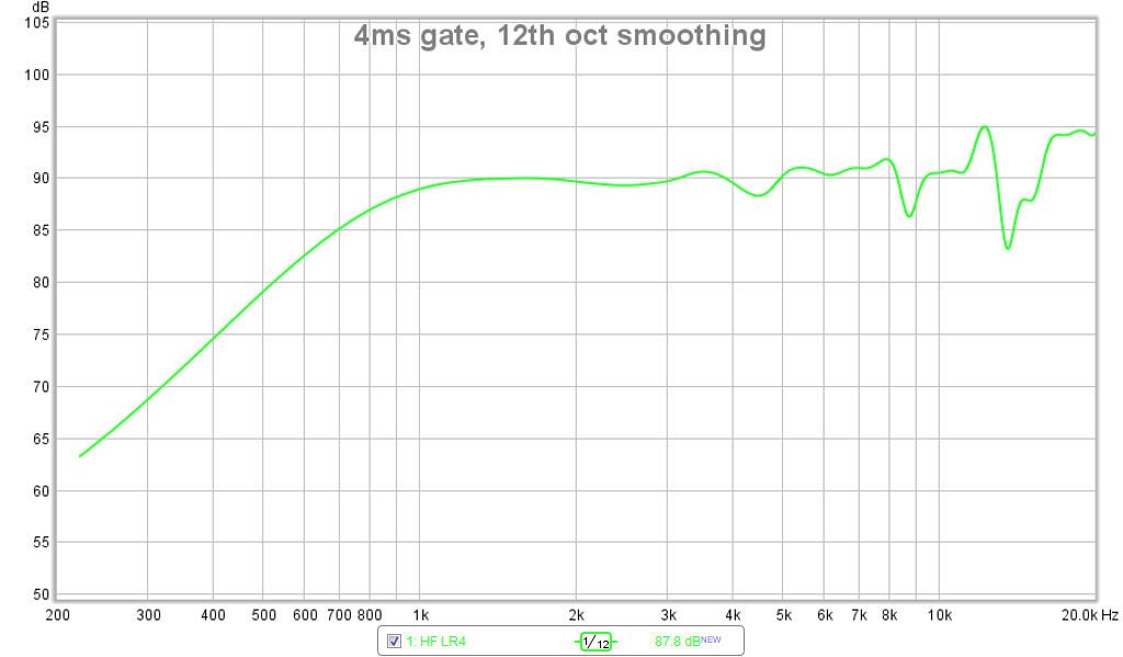

With 4ms gate and 1/12th octave smoothing:
With 6th octave FDW:
