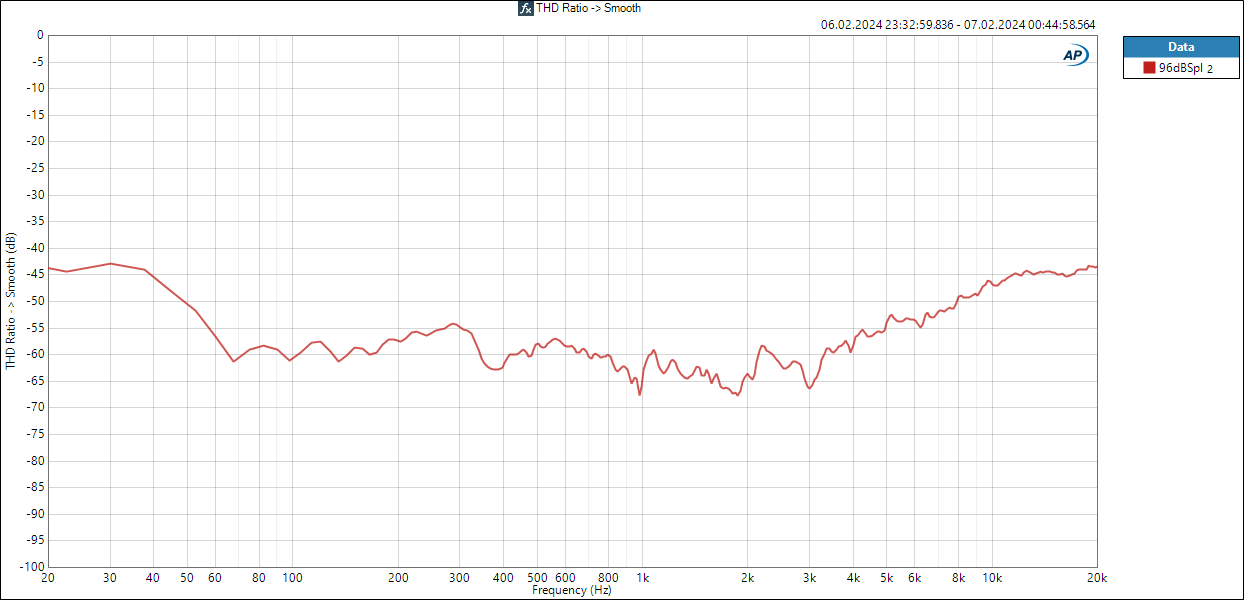

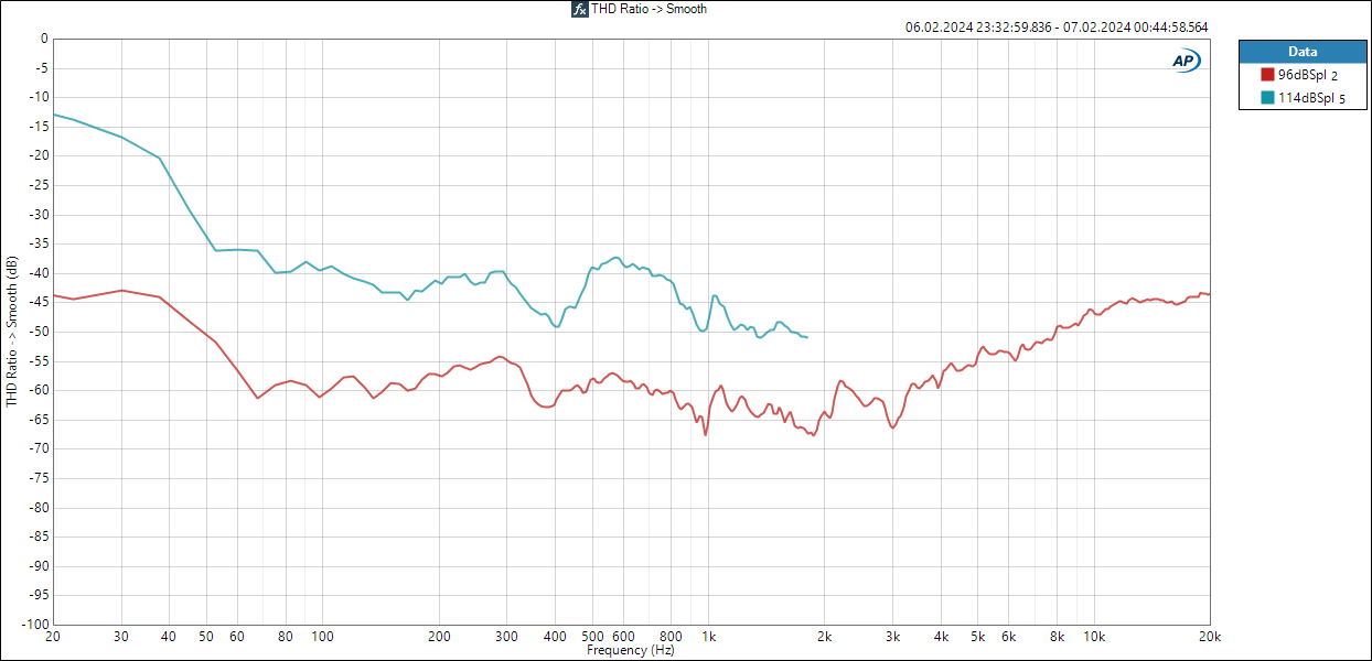

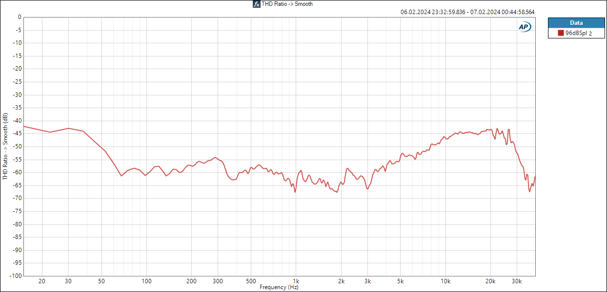

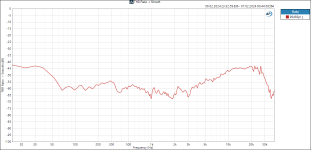

Just in comparison - this is THD of my prototype with 2x 12" close, 1x M74A and 1x T25B:

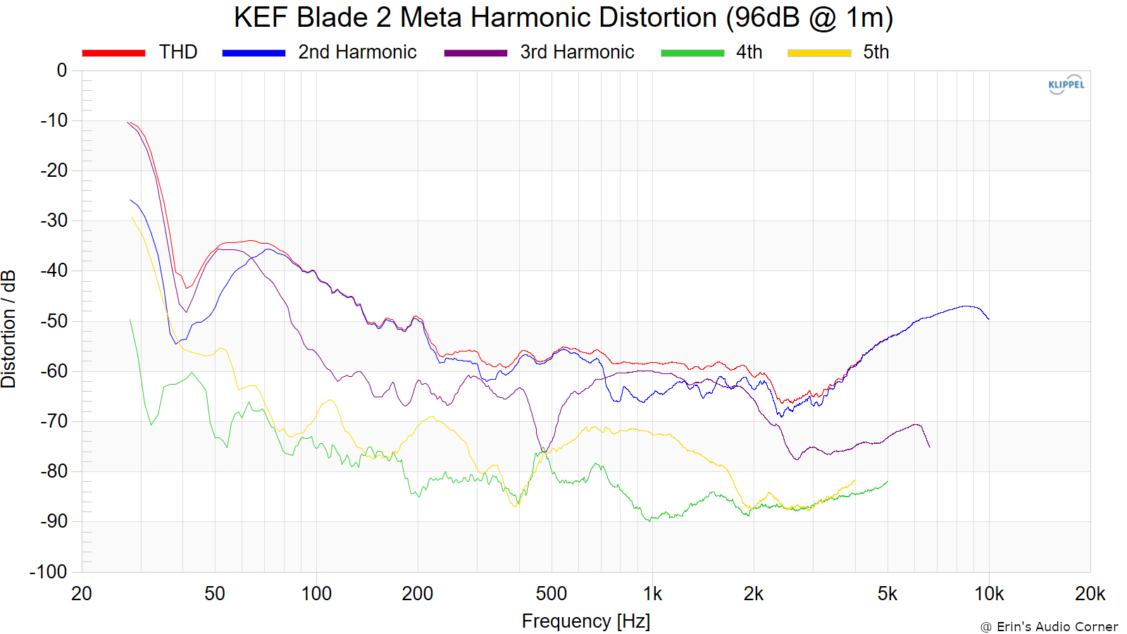

compared to one of the lowest THD speakers measured at ASR:
At 114dBSpl the LF drivers start to compress but not the single 3". And this are sine sweeps, not music with crest factor. So you can expect 120dB long term SPL from 2 M74A and plenty dB of peak over that.

If you're on it, maybe you can compare the price tag as well 😎😁compared to one of the lowest THD speakers measured at ASR:
