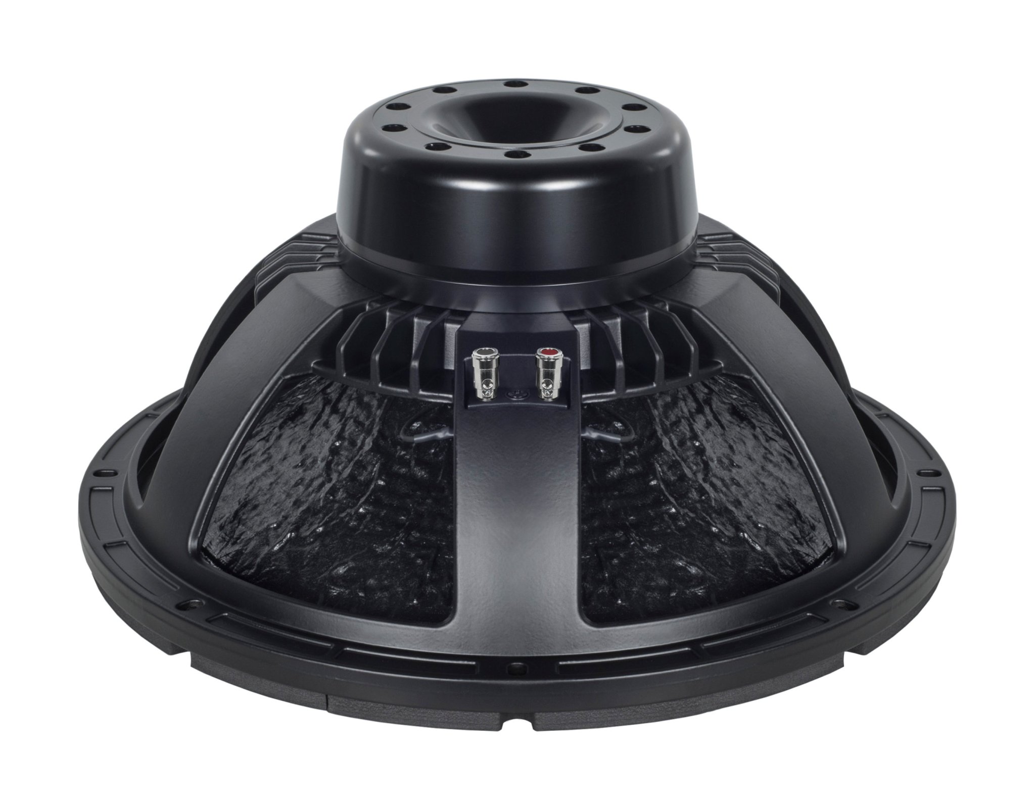

The shielding reduces the heat dissipation. How much depends on the construction of the shielding cup. When you compare the size of a shielded driver with its otherwise identical twin without shielding, the former is often noticeable bigger which means that the shielding cup encloses at least some air, which is equal to thermal insulation. I doubt there were drivers killed by that because the need of high power and being able to put it right next to a tube screen (which is in size somewhat limited -> audience size/number).
I referenced the subsequent discussion after publishing the concept where a mod with the pickup plate changed to two layers and with the vent blowing onto the second plate. The standoffs changed to radial fins to further collect the heat from the vent output. The drivers action does not create a continuous pump but rather an oscillating a bit of air vortex around that pickup area. This is a solid way to implement a heat sink to external air for any driver size and a practical way design a "4mm plate stuck to the magnet and going to the outside". At some point one must then measure, cut and attach. Generalising does not make a part
To have fins directly in the vent or air stream optimizes the cooling but creates other problems. The vortex got the positive effect of air exchange but the air speed of the port creates noise on those fins. It strongly depends on its construction and use, so it's difficult to generally say if it's good or bad. But the circumstances are what's really important. For a subwoofer it's not the goal to drive it permanently to its power limits, if you need it louder, it's a lot easier to just put more of them, that doesn't matter because you can't locate them by ear and you want them to live as long as possible. For the midrange that's a completely different animal because you have often just a limited size and an exact position you need them to be.
For a subwoofer it's a bad idea to maximize just the thermal side, the driver has to endure mechanical stress too and the manufacturer usually balances both already. Modern PA drivers are often already optimized to have air exchange so some vents (ie below the spider) could be increased in size which would reduce losses but they benefit more from the air exchange. If you put a collar around the magnet, these vents don't work like they have been engineered, same goes for the bores which ventilate the voice coil. An Example:
15BG100
That's a thermally highly optimized driver which will not profit but suffer from a collar. It can handle 2kW power. And if you give it a collar, and it would increase the cooling further, then it will probably die from a mechanical failure. To recone it (or replace it) you have to disassemble it from the collar and it takes several times longer to do that. Now the replacement driver got maybe a different tolerance or they changed the basket or magnet just half a mm and your collar doesn't fit the new driver anymore. Or maybe the driver isn't in production anymore but your collar only fits this specific driver, which makes your collar obsolete as well and you have to build a completely new enclosure instead of being able to switch to another driver.
Midrange drivers don't have such extremely hard mechanical work to do, they rarely do more than 2mm excursion (and that's why you don't look for high excursion in a mid driver), which means, the point of failure will likely be the VC (unless the cone gets smashed in etc). That's the reason it's a good idea for a mid driver but not that great for a subwoofer.
