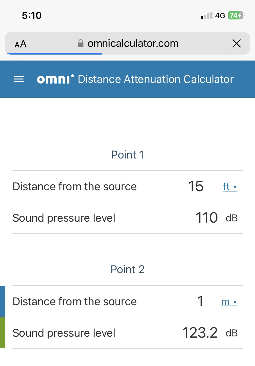

I should have also mentioned the 110 dB number I gave was at about 10 - 15 ft distance, not 1 m. That tacks on several dB to the equation, likely closer to 120 dB.
For a 8” MW to hit (7” estimated cone area) to hit 110dB for 300Hz @ 15ft = 123dB @ 1m
Ya'll lost me here: 110 dB @ 15'/3.28084' = 110 dB/4.572 m, so assuming a 90 dB/m eff. driver we need +20 dB = 10^(20/10) = ~100 W/4.572 m
Reactions: 1 user
Joined 2005
@GM
https://www.omnicalculator.com/physics/distance-attenuation

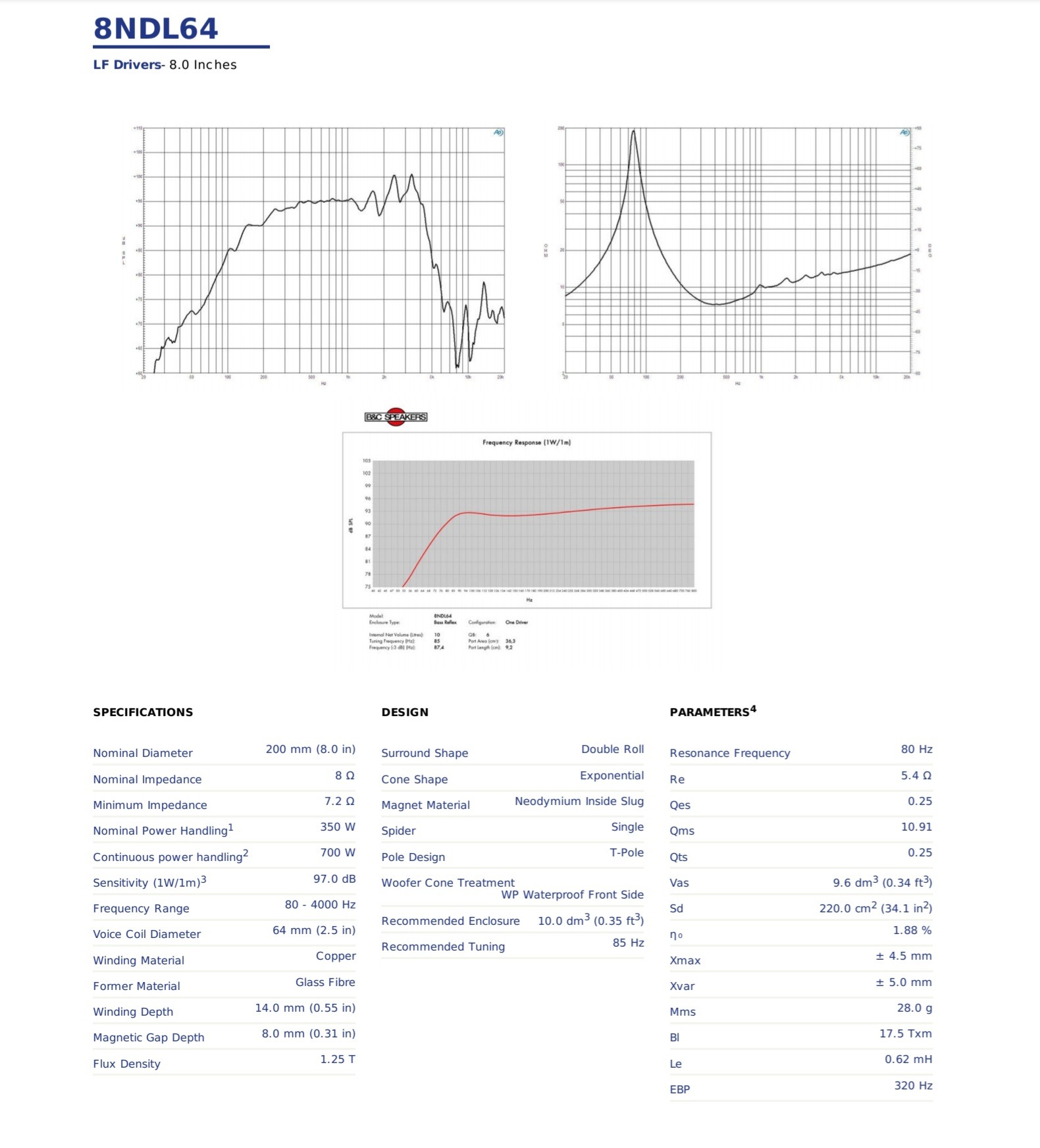

The B&C 8NDL64 has a larger VC, smooth FR and higher efficiency with good xmax. The impedance curve has some significant wiggles in it which may indicate potential resonance problems.
