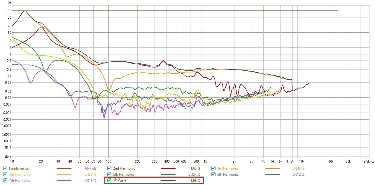

I did some further tests over the weekend with the 8NDL51 in a small 15 ltr sealed box and 30 ltr vented tuned to 60 hz. In free air the driver sounds pretty bad under 200 hz but it cleans right up installed in either enclosure. The vent noise generated by 105 dB/1m 60 to 200 hz sine waves disappears into the noise floor almost 30 dB down on the sealed box and a few dB less on the vented box.
Mounted in a proper enclosure, the 8NDL51 sounds overall very clean and accurate. Free air is whole different story, but I found that even just with the air load of a large baffle itself, the excursion noise quiets down significantly by almost 20 dB. In absolute free air, held only in my hands by the frame without a baffle, it sounds pretty bad.
This driver was obviously not designed for OB use. The smaller vent holes in the back plate and behind the VC gap move air very effectively at higher excursion. I guess that's how this driver was designed to work.
Again. I can't emphasize enough how well this 8" does with all sorts of material. It just sounds superb. Some other drivers may measure better, but they don't necessarily sound better. I've listened to dozens of 8" midbass drivers and most of them don't hold a candle to the 8NDL51 in various aspects. I'd like to test the 8NDL64, but I suspect it will fair just as bad in free air. I also tested the Eminence KL3012LF to compare results with a larger driver, which barely made any noise handheld in free air under the same conditions as the 8NDL51.

Other drivers don't measure better, not even ScanSpeaks ridiculous 8" Ellipticor.
It's pretty pointless to measure/use drivers outside of their intended application (a vented enclosure in this case).
Depends what you mean by the term 'measure better'.
Not too hard to find something that measures better in regards to:
Less cone breakup over the bandwidth.
more linear inductance.
Less resonances in the drivers bandwidth.
Easier to filter and better behaved response.
IMD.
Well behaved Impulse, ETC, time domain behavior.
That it does well in terms of THD sure.
Bl(x), Le(x) etc. i never saw measured.
So it is all debatable really.

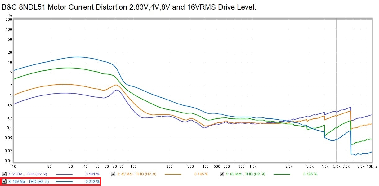

The only (potential) major drawback of the 8NDL51 is the straight pole it uses, but its copper covered for less, even Le that makes up for it. My reservation with a straight pole driver is the higher mid band distortion.
Suboptimal design of the motor structure leads to nonlinearities, including inductance and flux modulation, which causes current distortion.
Motor current distortion of the SB Audience NERO-15MWN700D @ 16V:
8NDL51:
(Measurements courtesy of Scott Hinson)
Reactions: profiguy
