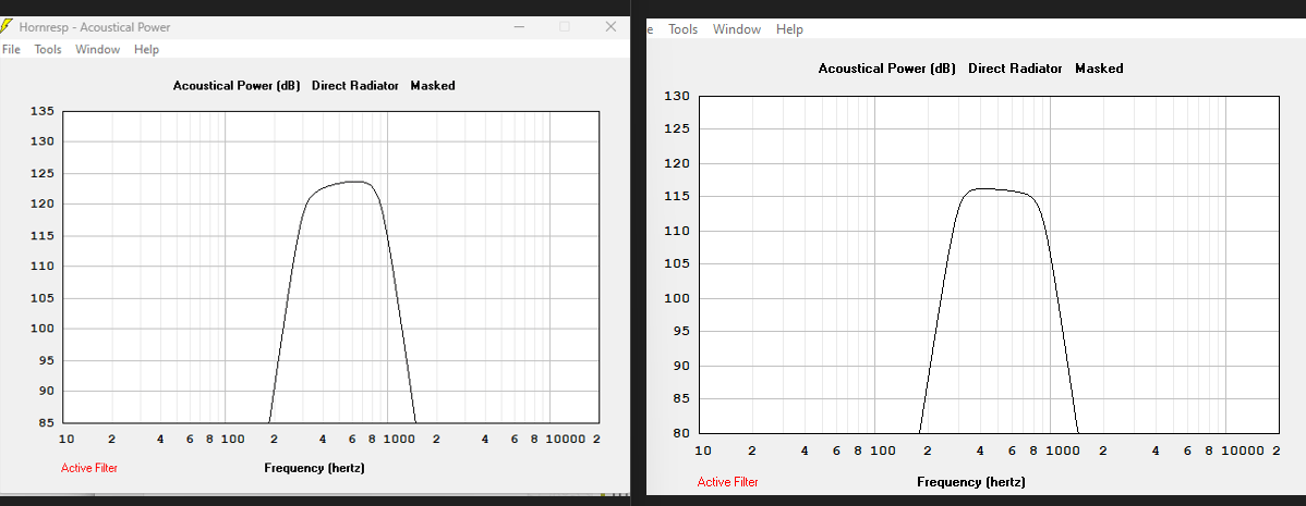

Yes, the Beyma 8MC800Nd is only available 8 ohms. VC is 2.5".
It is quite a jump up from the 8NDL51 in terms of power handing / SPL.
Very quick and nasty sims, 20L closed box....steep BW 8th orders at 300Hz and 900Hz.
Both at their max power handling (halfway between continuous and program)
Beyma on the left, B&C the right.
