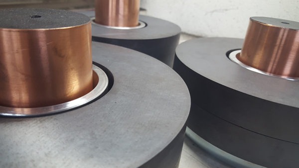

Quite a nice motor there. Aluminium sleeve on the outside of the coil, copper on the inside. I'm betting on ultra low distortion.

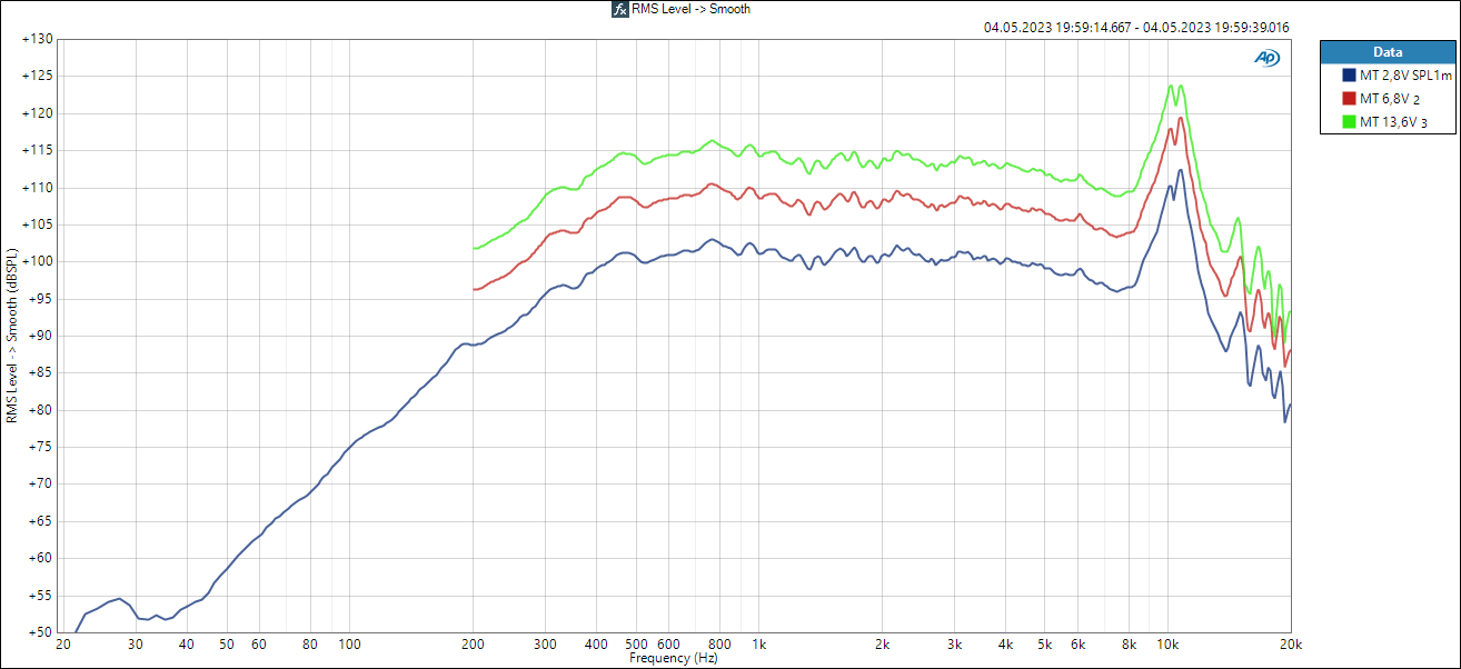

@tktran303 There is a M74 thread here with lots of measurements and more. This measurement is from 2 M74A.

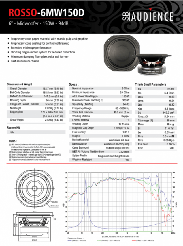

@diyiggy If you're referring to the SB 6MW150D, it has a carbon fiber and paper pulp mix cone. Its very clean up to 2.5k and has a quiet motor with venting everywhere. Its a tough little driver with good power handling and minimal power compression.

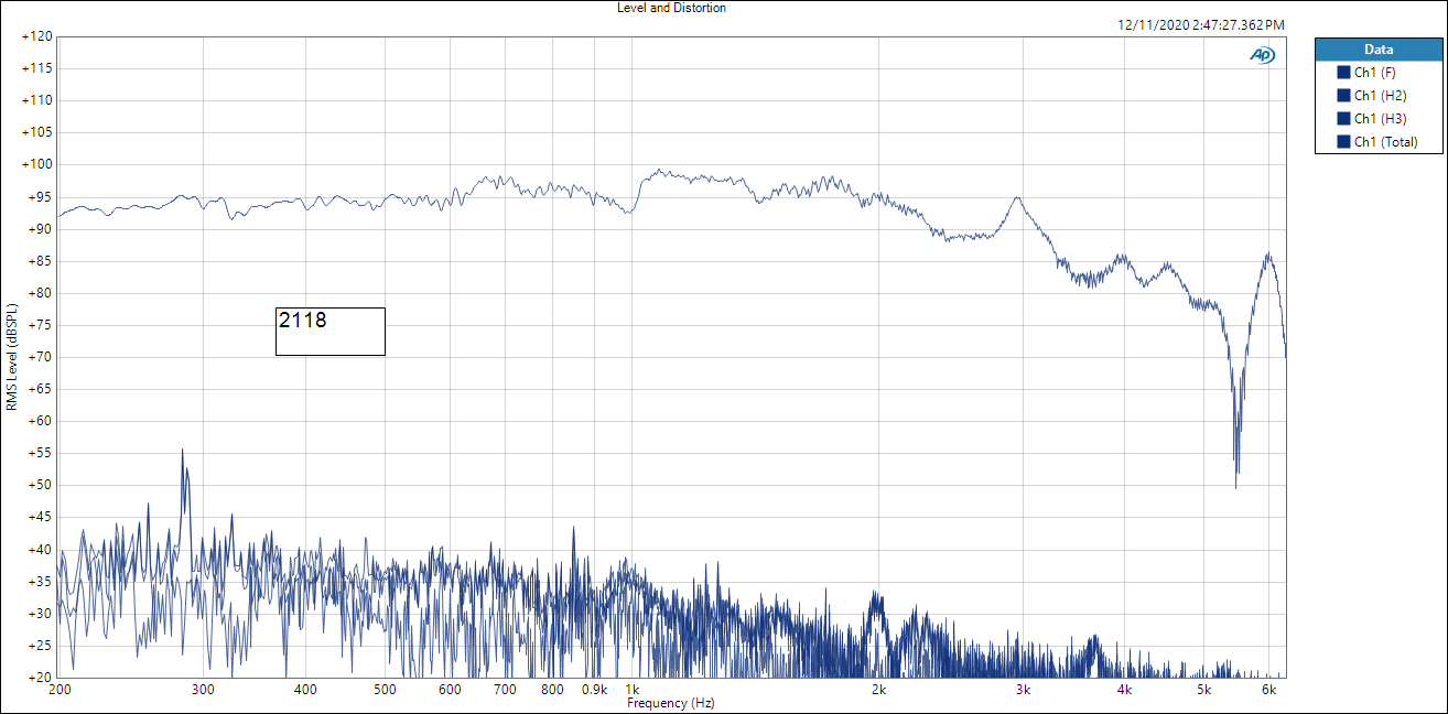

For 8 inch look at JBL2118H

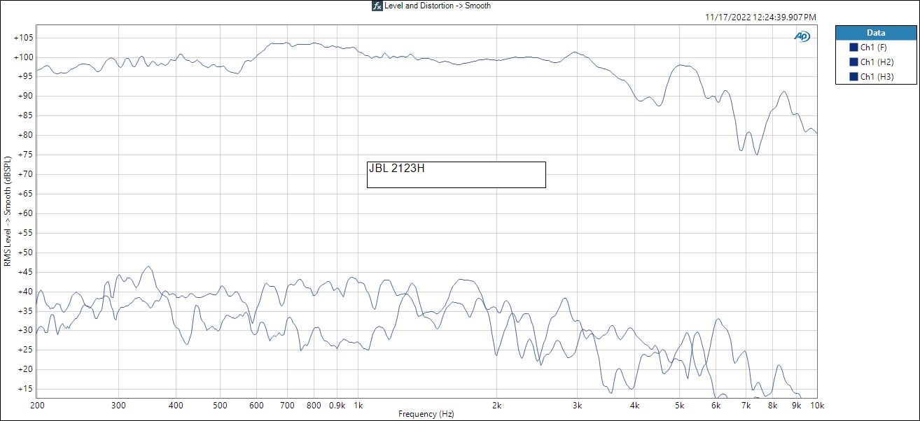

For 10 inch look at JBL2123H
for these "large" mid drivers X-Max is not an issue. Pluss distortion is very low.

Two very competitive devices by today's standards. Some people use the 2118 without a crossover, I preferred it with a simple 2nd order.
