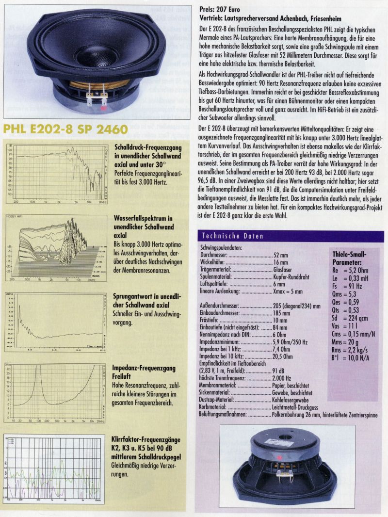

PHL Datasheets ... it's a pain. They really don't care about hobby users but it's fairly easy to get samples from them when you are a (serious) company.

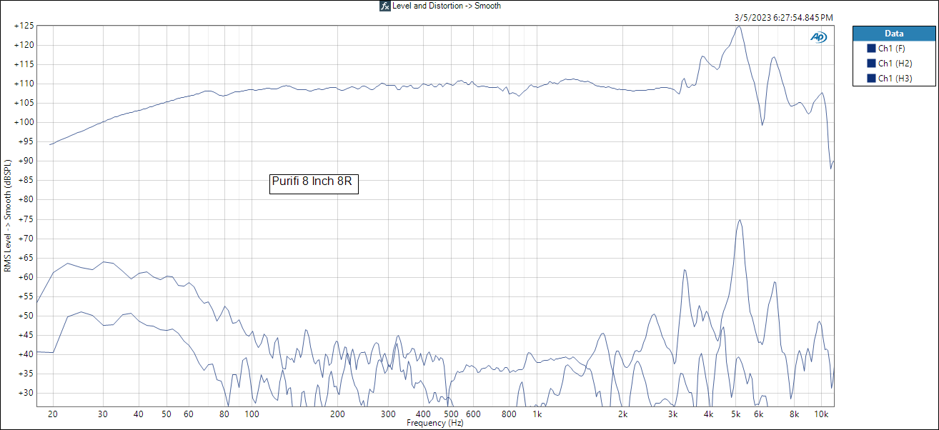

The @1m frequency response of them is very strange in all of the chassis (notches at 400 and 800Hz) and the @25cm is missing. THD seems pretty good but not the best they can do. But madisound has an incredible price for them. Maybe use 2 in a .5 configuration.

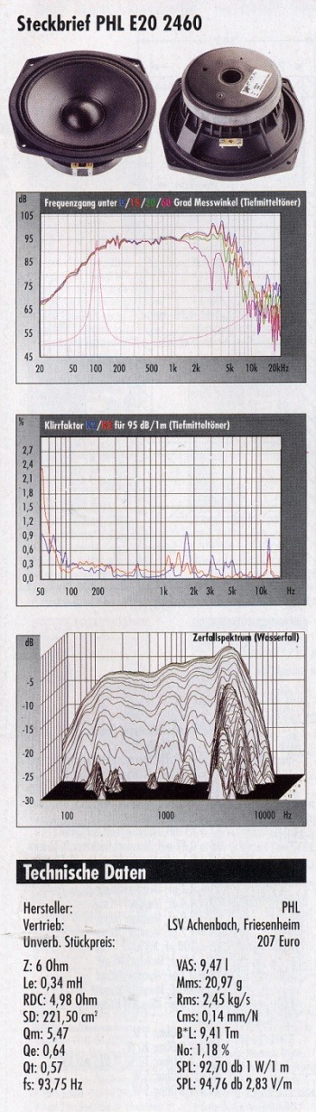

I tested PHL 2460 and 2710. 2460 has very low THD values, the lowest I measured with these 8" drivers. 2710 has less sensitivity and a little higher THD but can go loud at low frequencies, lot's of Xmax for such a driver.

PHL datasheets got a huge improvement in 21 or 22, including klippel measurements, but yes many of the transducer datasheets are miissing the new measurements still😒
And yes the old and new datashees has some wonky stuff going on in the 400-8/900 range.
That does not appear elsewhere ususally.
Yup the 2460 is the nicest one of the bunch of the older generation of drivers, as i mentioned in the first page.
Klang & Ton Germany, is the place to look for PHL measurements as they have done a bunch of them, like the 2460 i linked below.
They do have a few transducers that has some rather bad resonances in they're bandwidth, so confirm measurements before you buy.
As for the 2513NDS i added it below from they're web.
