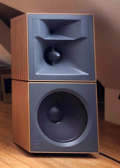

If there's enough width for something like that, why not go to 12 inches? There are some 12 inch drivers that you can run up to 900 Hz as well. Or how about something like this?:I've decided to run 2 x SB 6MW150D bass-mids in vertical arrangement, but placed next to (side of) the mid dome.
https://www.limmerhorns.de/042/

Would have been my 2nd suggestion, with DE360 it sounds for sure good and not PA like.If there's enough width for something like that, why not go to 12 inches? There are some 12 inch drivers that you can run up to 900 Hz as well. Or how about something like this?:

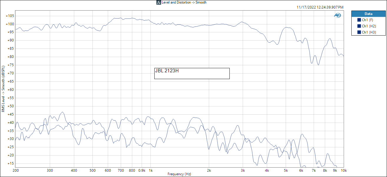

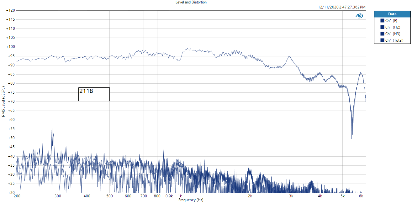

For 8 inch look at JBL2118H
For 10 inch look at JBL2123H
for these "large" mid drivers X-Max is not an issue. Pluss distortion is very low.
