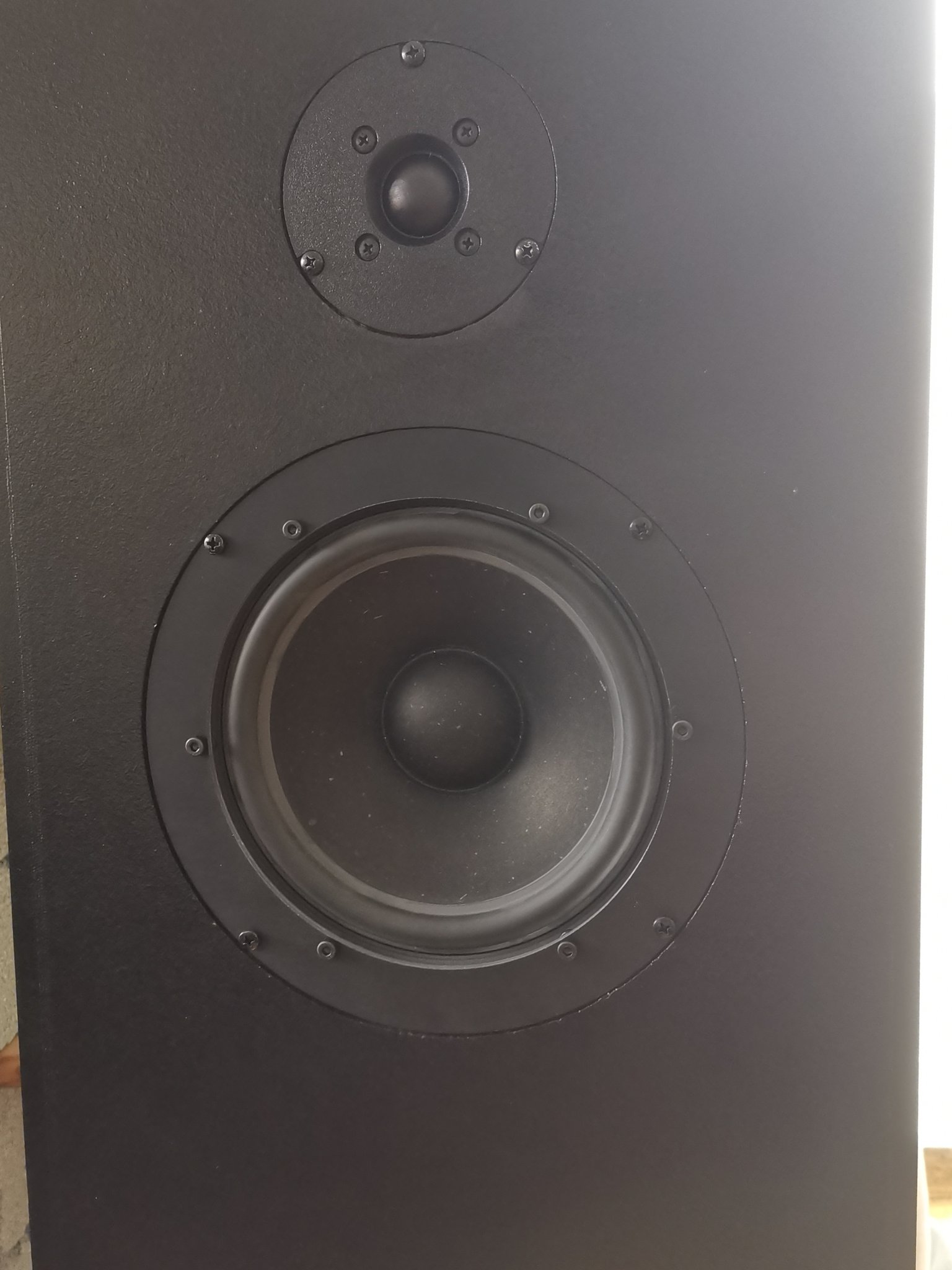

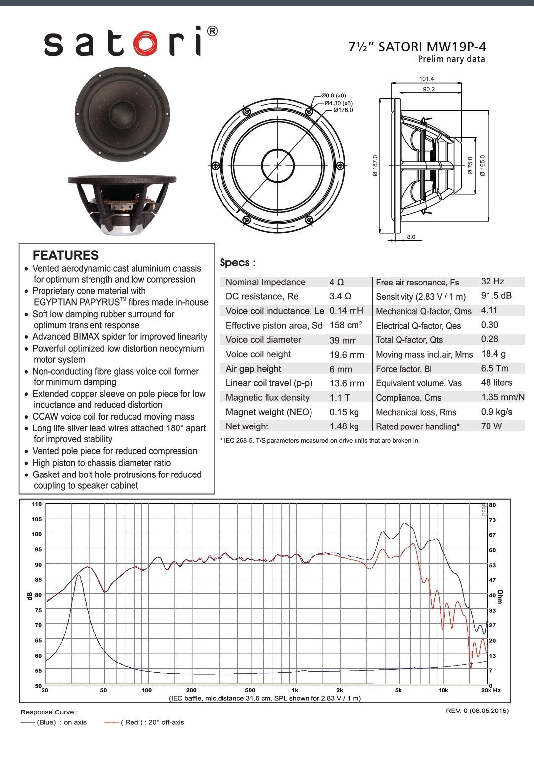

What about the SB Acoustics Satori MW19P-4? Yes it's 7.5", but if you already have an 8" cut out the you can rear mount them and use an adapter ring. I did

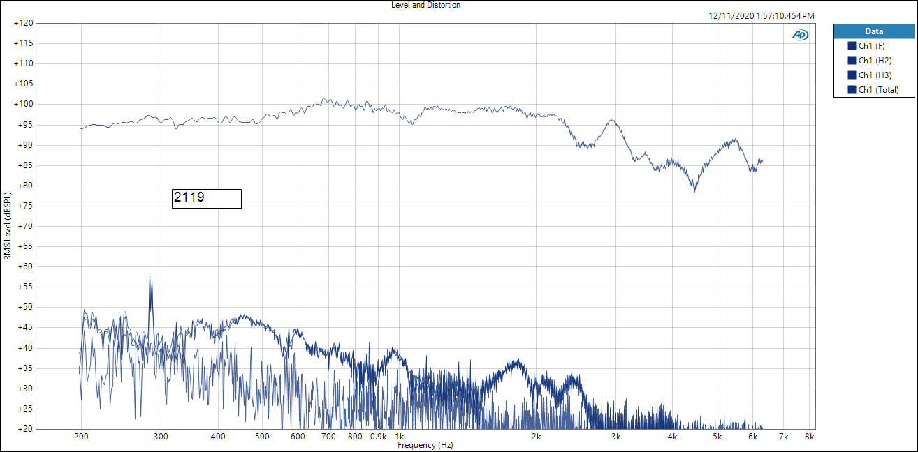

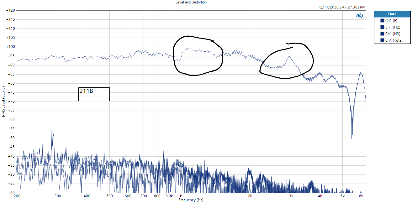

For 8 inch look at JBL2118H
for these "large" mid drivers X-Max is not an issue. Pluss distortion is very low.
Why not the 2119H? 🙂
The 2118H has often been notched, due to the 1k -> resonances/breakup.
The 2119H is better behaved in this region.
And has higher power handling.
of course the 2118 is easy to find used for decent prices.
The 2119 usually going for 300$ ish and rare in the used market.
