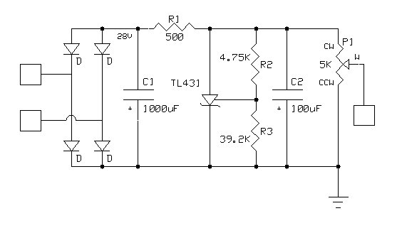

Recommended voltages for C1,C2, and C3?
Dan:eek:

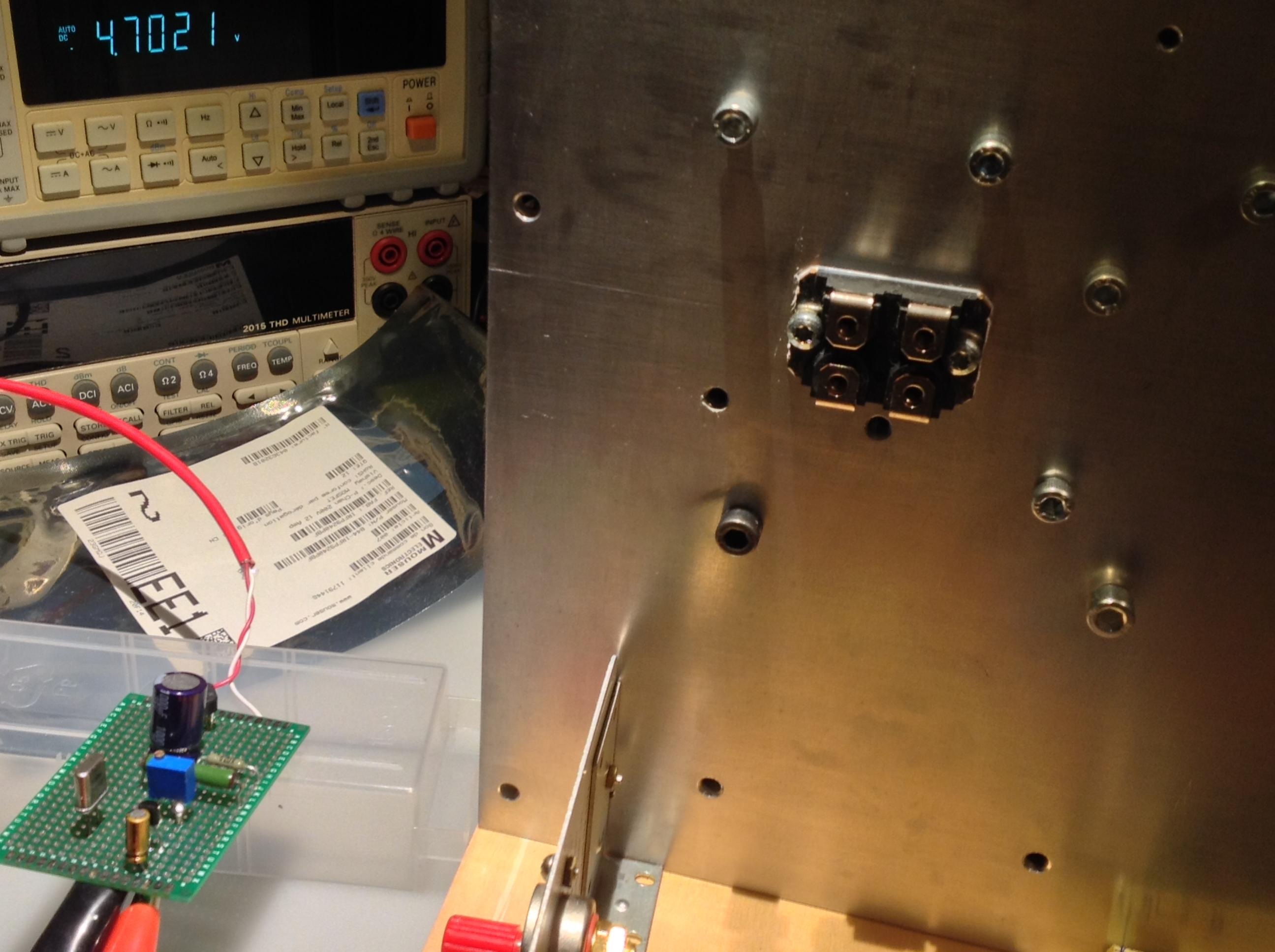

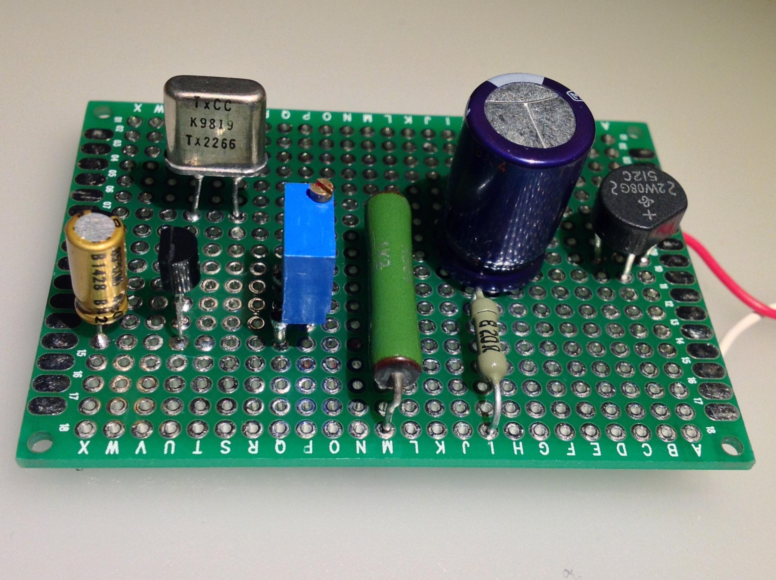

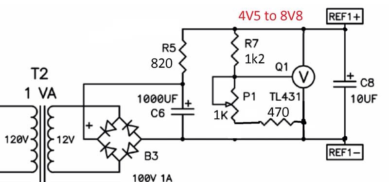

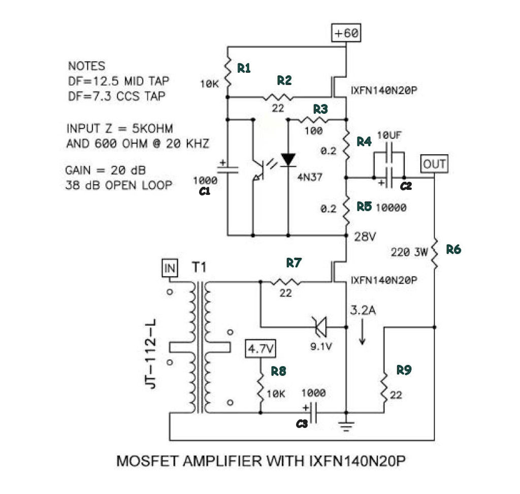

OK for IXYS amp build this one , is tested Zen Mod version and work like charm with multiturns trimmer :)

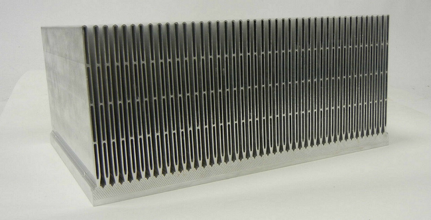

So much fun, I think I will join the party too. I can't have too many Class A amps.
I just purchased two large heat sinks from a Canadian ebay merchant. No worries about Canada Customs or brokerage fees.
The heat sinks are 11.75'' x 8.875'' x 5.25'' and weigh 20 pounds each.
I will build them with THF-51S in monoblocks. My Hammond inductor loaded VFET L'Amps sound great. CCS loaded THF-51S with much higher power should be fantastic.
Joined 2012
The heatsink will dissipate heat through convection and radiation. Convection may not be the best with the tight spaced fins but the large bulk of fins will radiate quite a bit of heat.
I will find out when I get the amps running. But I am encouraged by Soundhappy's amps with similar heatsinks.
