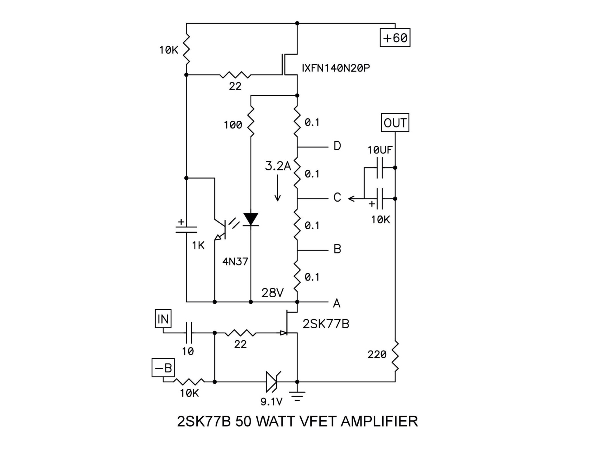

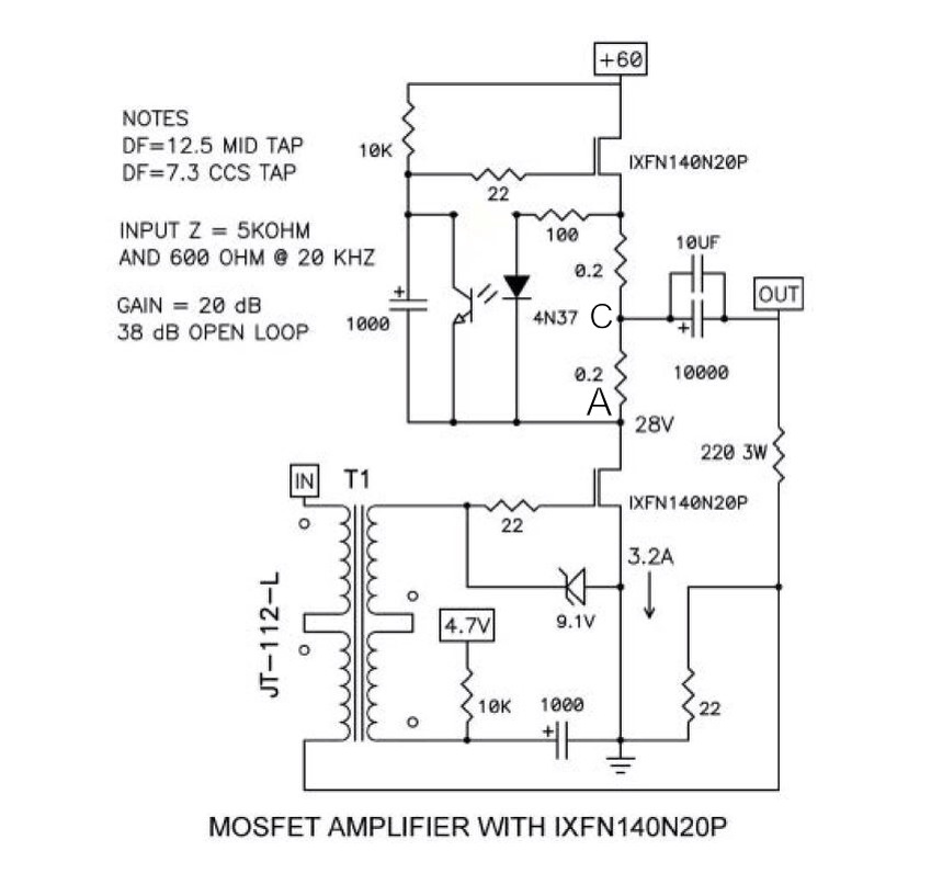

One more question, what voltage rating would be needed to use a rotary selector switch to change between the CCS taps? The highest rating I can find on Mouser w/ Grayhill switches is 28V DC. Would that be pushing it? Would that switch see the 28V DC before the output coupling cap?
use some big hog switch , rated for 15 or 20A min.
voltage is not a problem , problem is contact impedance (resistance) ..... and higher rated are having smaller losses at contact

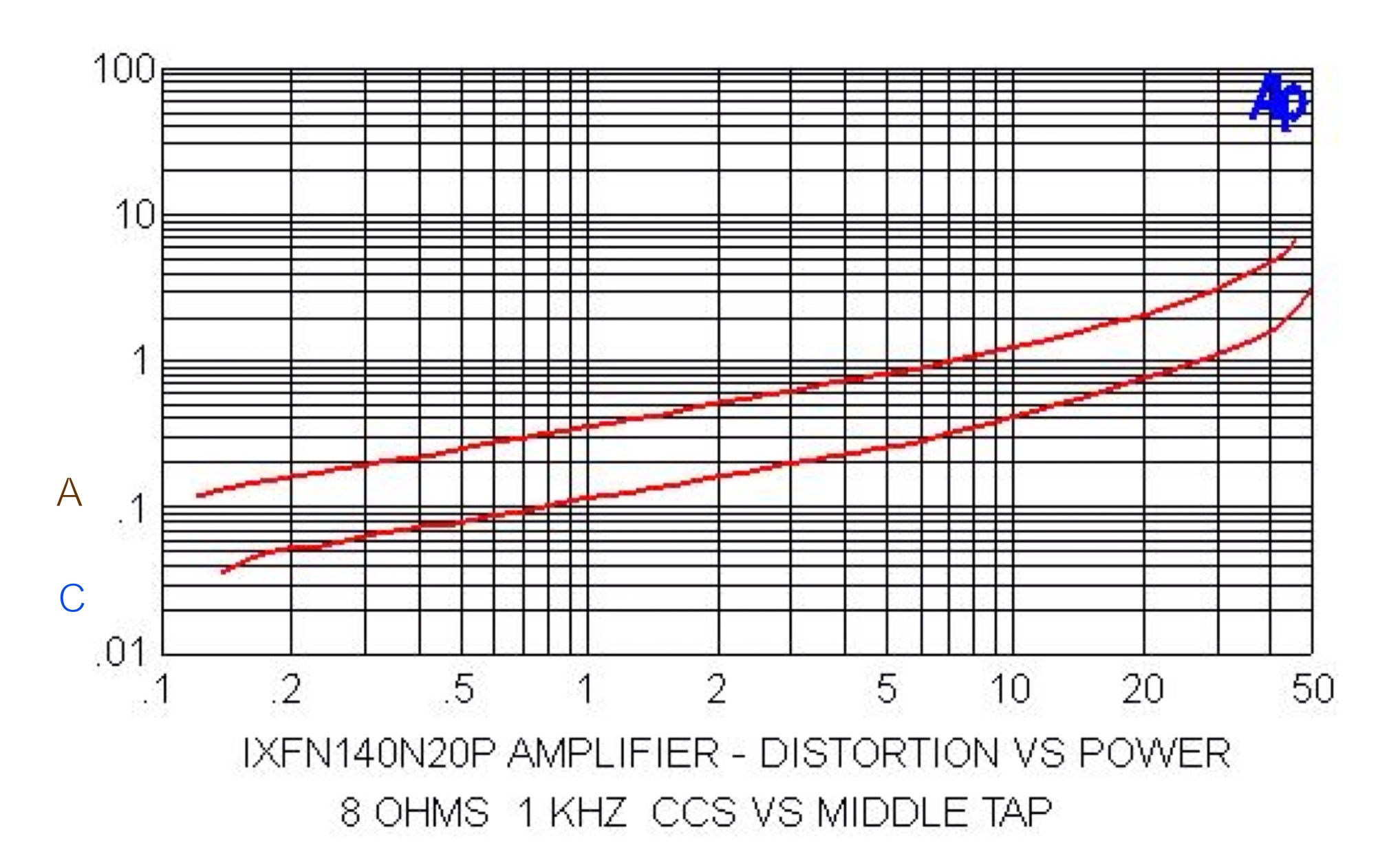

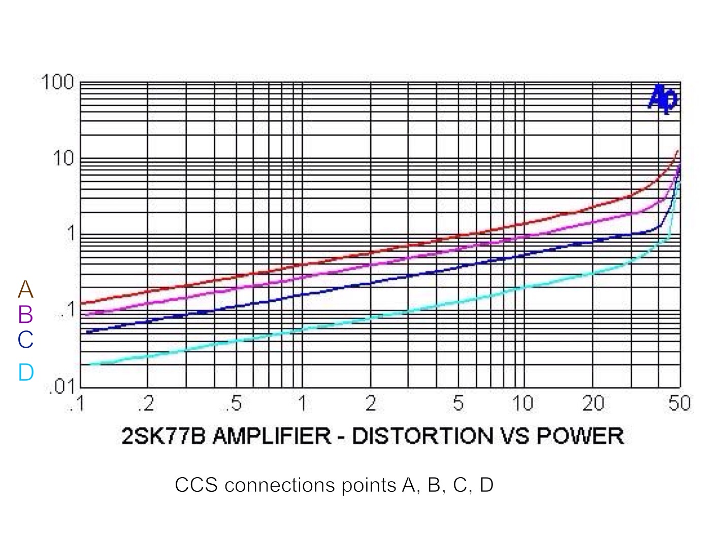

Point A and B have higher distortion numbers only C or D give better sound imho.
IXYS triode emulation distortion at the center tap C are very similar to 2SK77B

I'm actually going to be using the 2SK77B circuit w/ either a 2SK182 or THF-51S and wanted to listen to all 4 positions to pick what I liked best. No offense on your opinions Soundhappy, but since the lower taps are hearing mainly just the SIT with no mosfet contribution...I wanted to at least give those a try. I had seen your implementation, and it is perfect for selecting one of 2 positions, but wouldn't help w/ the 4 unless I cascaded 3 switches which would start to look a bit off 🙂

I could give that a try, or else I guess go with the "not as easy to change" method, and use a short large-gauge wire jumper.

you're going to change taps only in first listening tests , and hopefully leave it later in one position
so , spend switch money on something else , do it any other way for testing

Makes most sense to have a "jumperable" position on the board and then solder in the final position that I like.
and wanted to listen to all 4 positions to pick what I liked best..

I would not bias the bottom MOSFET in this way with these parts having such a great transconductance.
I did it only to show how smallest Vgs changes have big effects.
The only thing I would trust is Zen Mods servo solution!
He was so friendly to develop it for me, but I am afraid It will be autumn since I start the BAF2025 amp.
