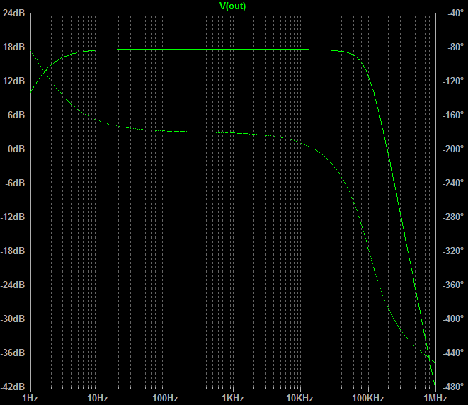

A small SIT and a Puck also has good potential. 🙂
