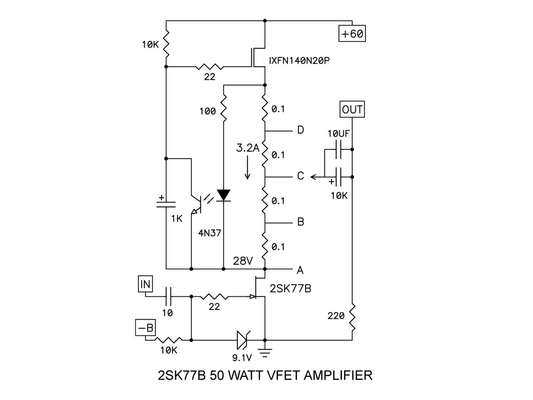

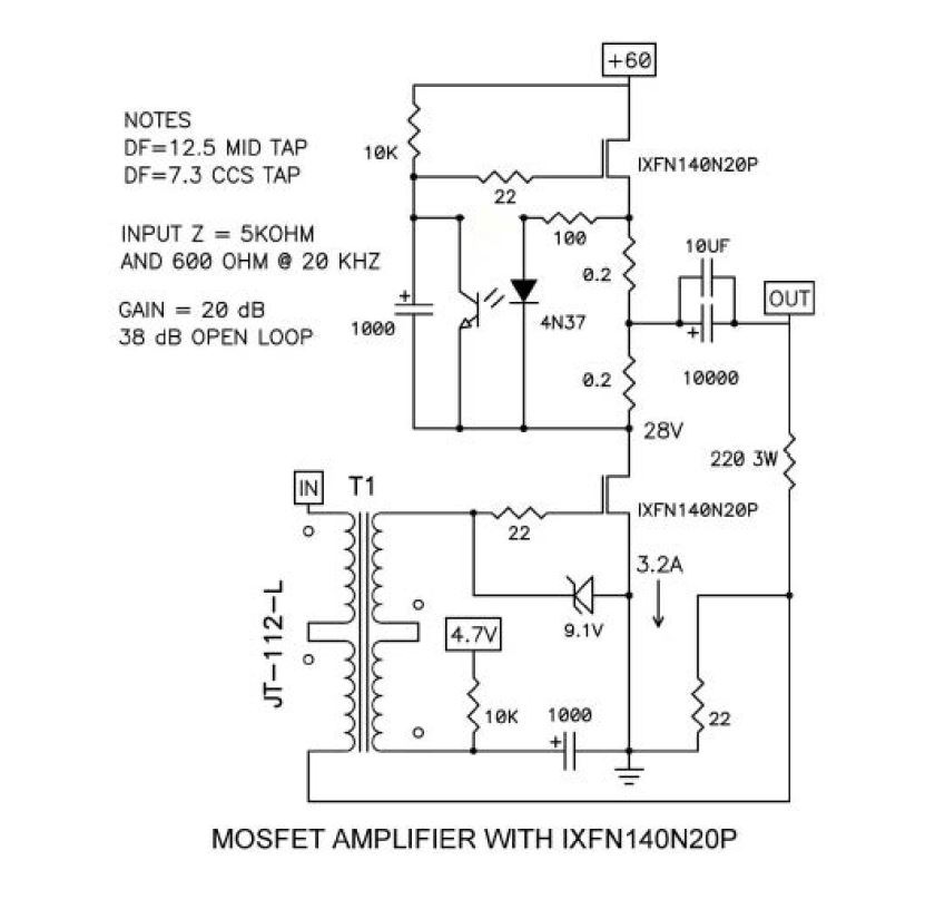

Any issue with installing the 4N37 from the underside of the PCB in a point to point setup?
When upside-down, the 4N37 pins match the schematic perfectly. I don't think it would cause a dissipation issue, but thought I'd ask.
thanks,
Vince
Me too I think installing the 4N37 in underside position is not an issue

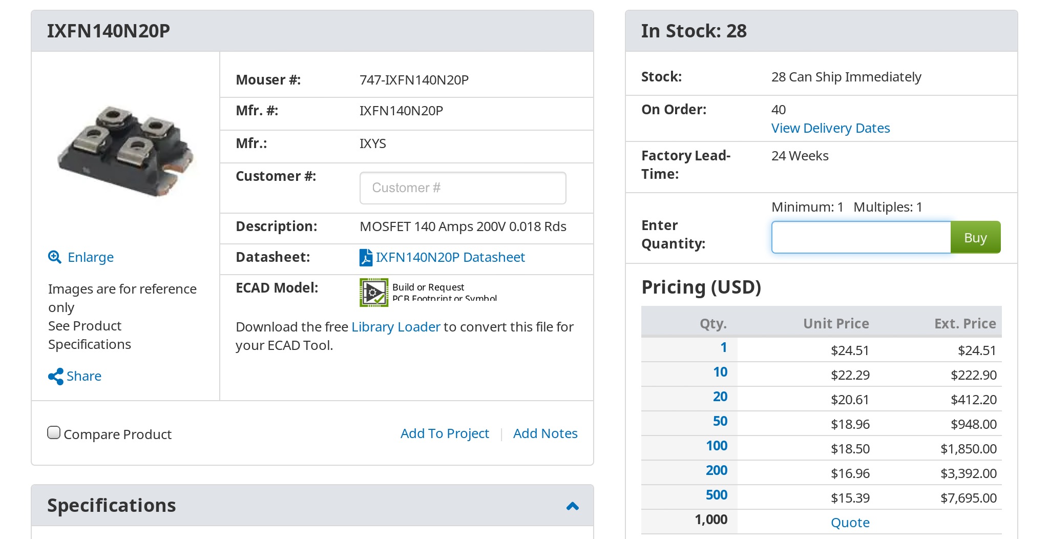

BTW IXYS price go up

If I were to lower the voltage of the circuit from 60v to 40v, would the drain of the mosfet be at half the circuit voltage, e.i., 18v-20v?
Is this similar to the ACA bias adjustment? Would I then monitor the drain voltage while adjusting the bias at the gate, arriving at around ~20v?

220R 3 Watt's feedback resistors, 22R at the drain
Happy, is the 22R, near the 220 3W, a 1/4w resistor?

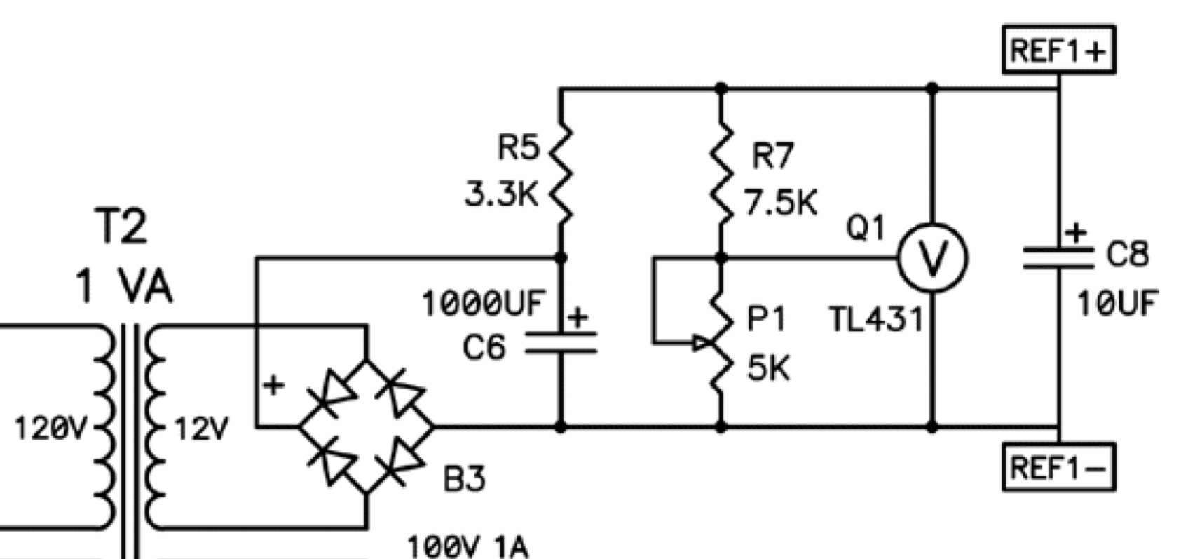

Are you using this circuit for the bias section?
How much of the bias for Your mosfet ?
Good question. Will be using a IRFP250. I believe it's based on how much voltage will appear at mosfet drain, which is around 18-20v, depending on symmetrical clipping. Not sure what the figure will be. Will have to monitor it while adjusting.
I have a prebuilt LM317 circuit to speed up the build process. The transformer has extra 12v and 18v secondaries, so voltage is not a problem.
Cool Vdi_nenna build with H2 , H3 switch on the CCS ?
Between D and C 0.1R resistors connection points.
