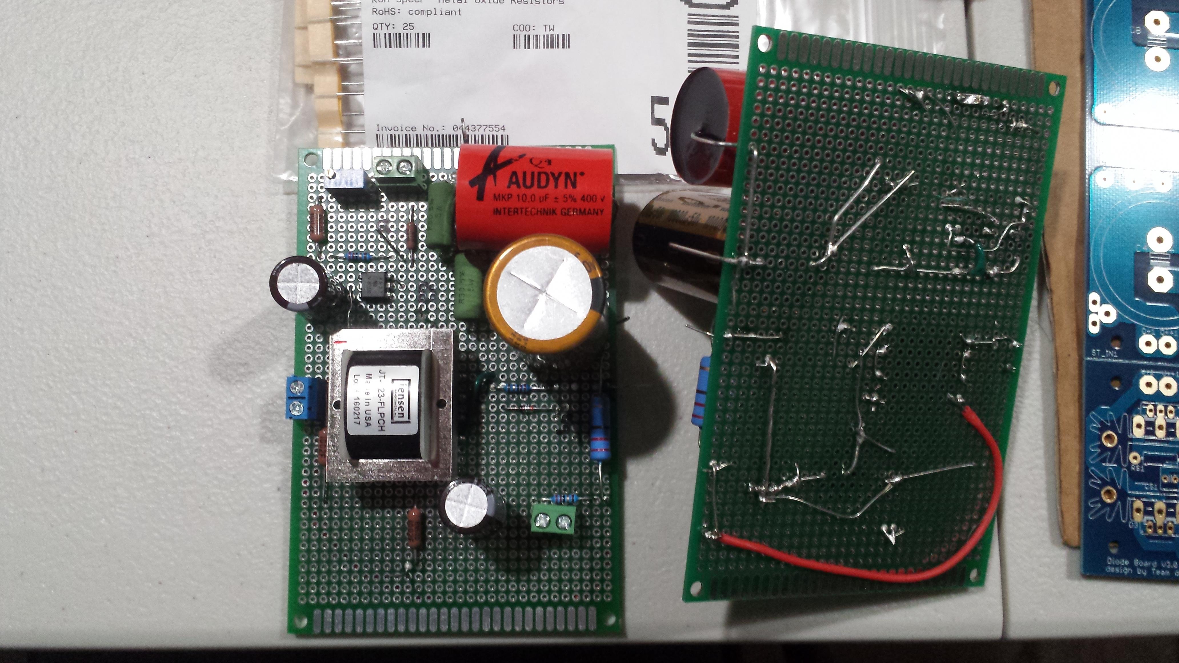

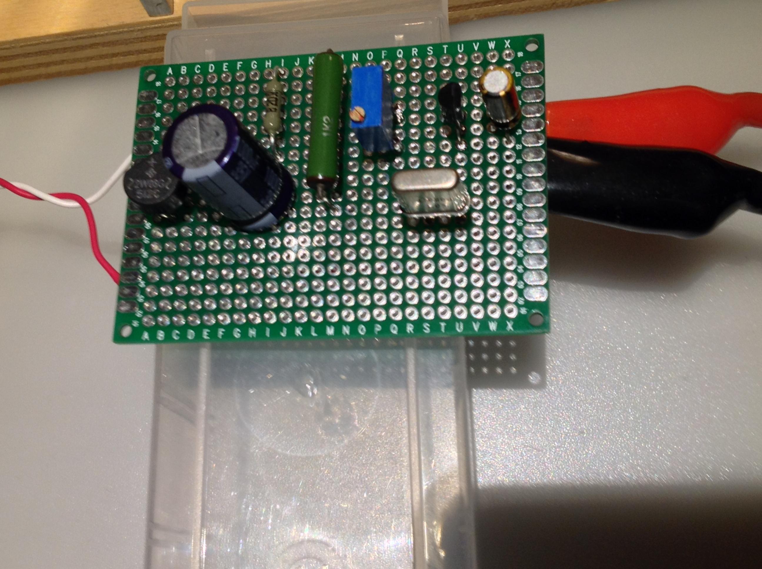

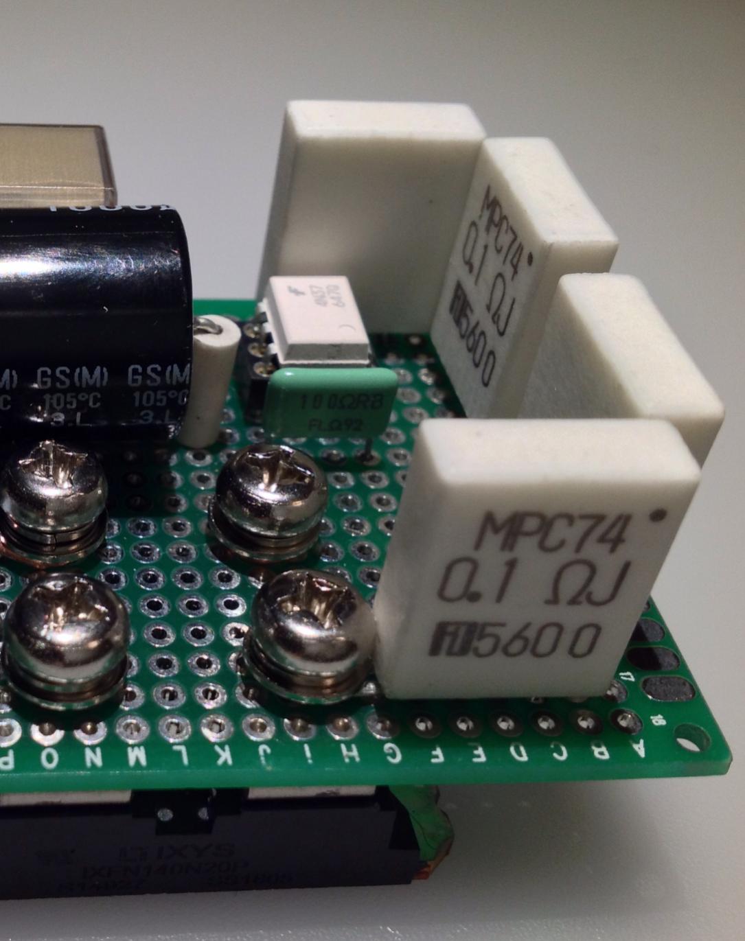

My progress. Should have used PCB boards with traces. P2P is tedious. 🙄
Haha P2P 😀

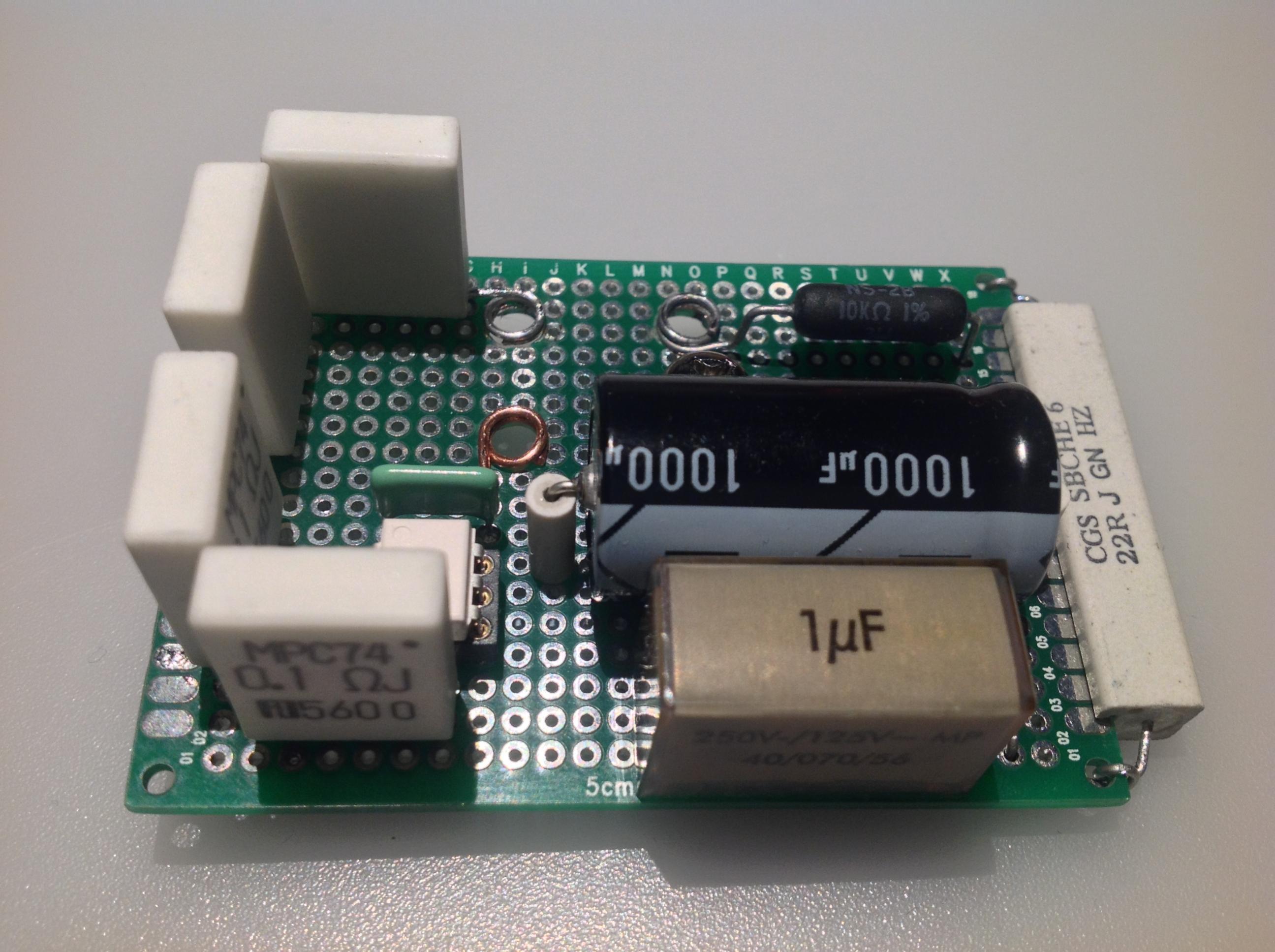

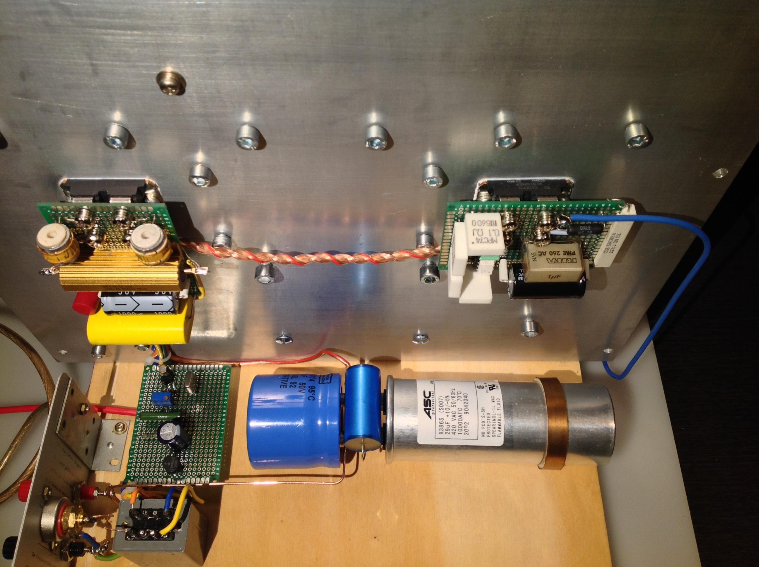

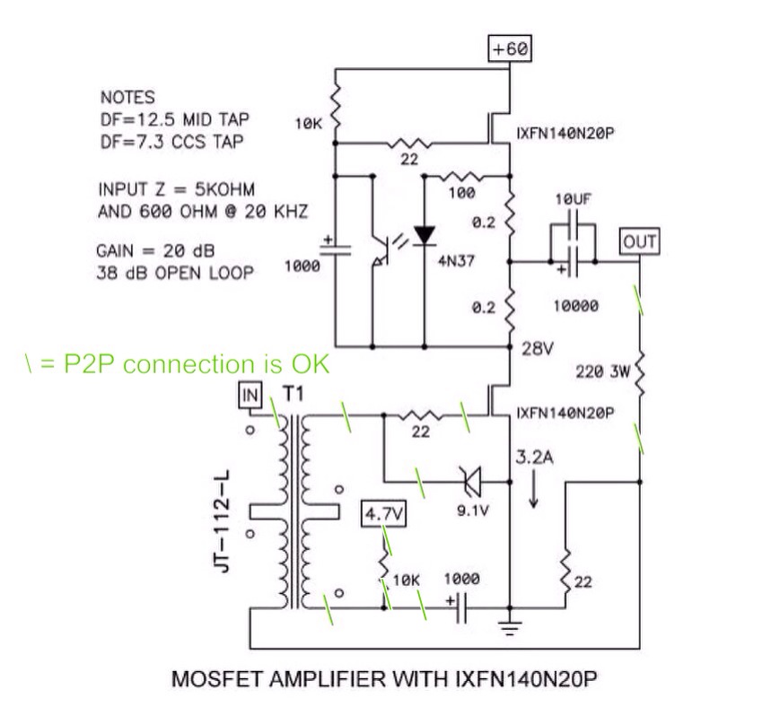

My was 3 small amp. sub circuits :
1 | CCS
2 | Audio path
3 | Bias voltage

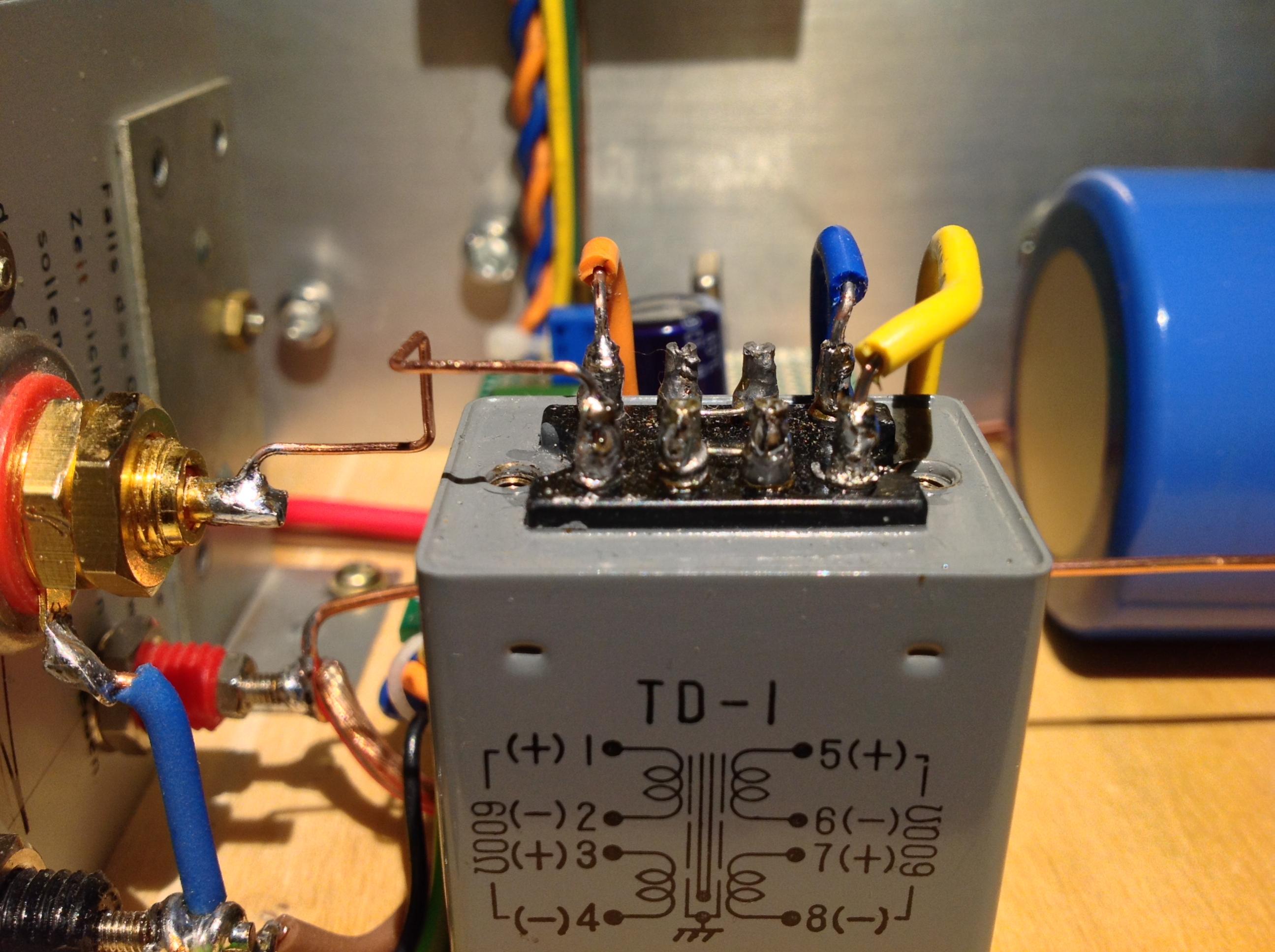

transformer was soldered directly to RCA input
Sometimes is good time on the bench.
Printed schematic on the paper then connection I finished is marked OK before the next one step.
I can visualise more easyly all P2P connections who is ready done 🙂 Have Fun

Well, that's just down right artistic. 🙂
😀 Thanks Vince!
Btw I do stereo P2P Korg preamp on one perfboard and was very complicated with 8 small jfet's etc.
I show this leater in the adequate thread

How is the 10000uF output cap value calculated? Is it the output impedance in parallel w/ the 220R resistor as an RC circuit? If so, that would give a rolloff (-3db) around 14hz on the CCS tap and 24hz on the middle tap, correct? But this measures flat out to 10hz. I guess I'm missing something. Just want to know where it comes from.
*Edit, I guess it would be 220R + 22R in series and then parallel w/ the output impedance. Doesn't affect the numbers though.
