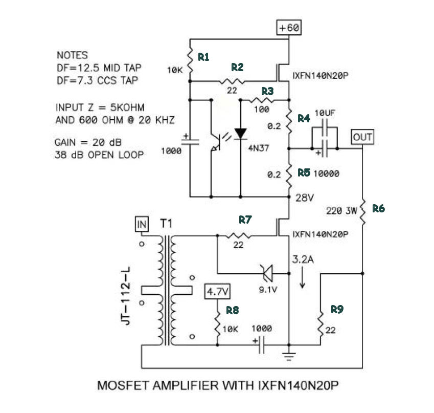

50w Single-Ended BAF2015 Schade Enabled

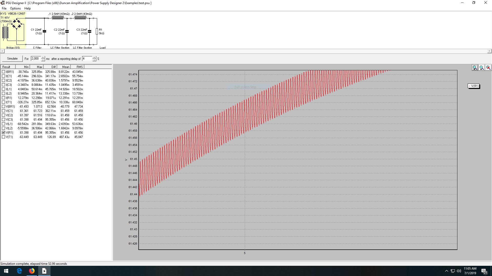

C1,C2, and C3 are actually 22,000uF. The PS Designer doesn't seem to report them well.
Anyways I'm going down the old school road with a monster toriod and lot's of CLCLC.
Dan
So.............looks like R1 to R3 and R7 to R9 are 1/2 watt. R4 and R5 are 10watt and the sole survivor R6 is 3 watt.
Dan
P.S. I wouldn't mind finding some CPCC10's. Nice and compact. Speaking of compact. These look nice too. TNP10SAR200JE Ohmite | Mouser Canada
Too bad someone didn't do a PCB. With the right components this could be simple, compact, and neat. Everything Father Pass looks for in a design?
