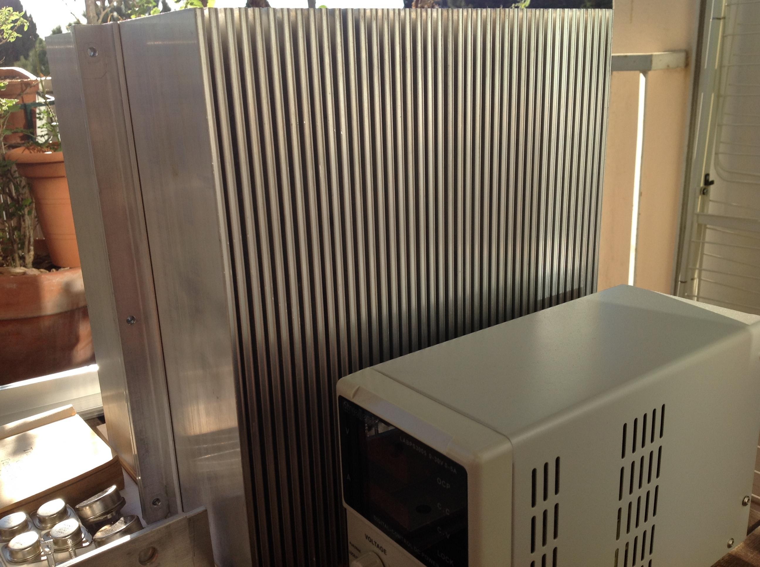

I did some research and radiation may not be very effective. However, the large mass will absorb more heat while raising the heatsink temperature less than with a lighter weight heat sink, and there will still be some convection current. It might not be the most efficient heatsink but I am thinking that the large size for the amount of applied heat will result in reasonable heatsink temperature.
The fins are similar to the fins in Soundhappy's heatsinks (see post #593).
The heat sinks weigh 20 pounds each so I am hoping that they are adequate for 200Watts.
Soundhappy,
What are the dimensions and weight of your heat sinks?
Hello Ben Mah
Lenght | 33.5 cm = 13.18 inches
Width | 30.5 cm = 12 inches
Depth | 13 cm = 5.11 inches
Weight ~ 15 kg = 33 pounds each

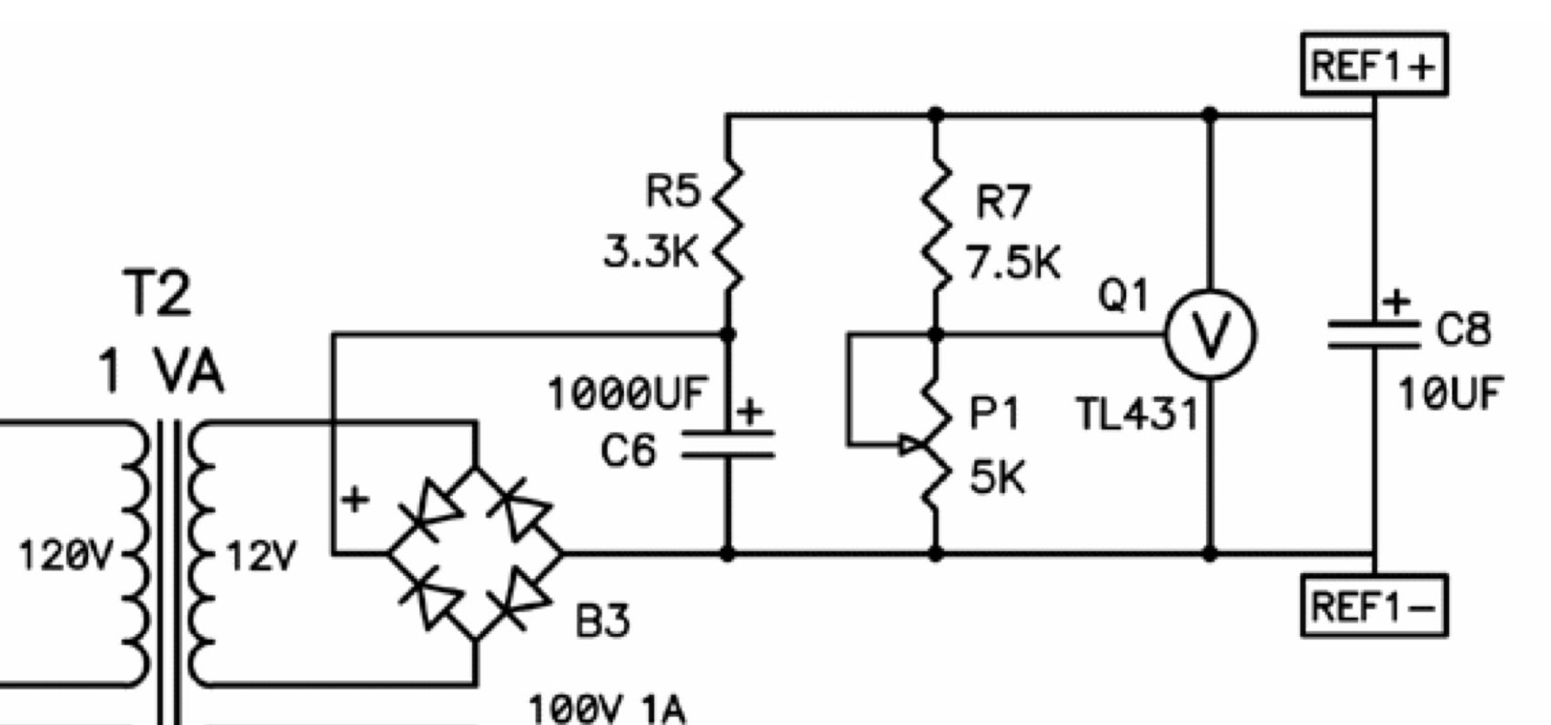

IXYS bias circuit if 5K trimmers are ready waits in the drawers is a great Mr. Pass version :wrench:

Hi Soundhappy,
Thank you for the information.
The heatsinks that I purchased are about 2/3 the size of yours. Hopefully they will be adequate.
How hot do your heatsinks get (ambient and heat sink temperatures)?
I can always add fans if necessary.
Thanks for your input.
I will build the amps as monoblocks in aluminum enclosures, with lots of ventilation holes in the boxes. The boxes will only be about 300mm deep x 230mm high x 170mm wide, so not large, but they will absorb some of the heat. The amps will have lots of free space around them.

It's important to get bias voltage before B+ in case of use depletion transistors SIT's so current do stay in safe range.
With Mr. Pass bias circuit this is happen naturaly because small electrolitics charge quickly
and PSU electrolitics are much bigger and slow = time delay

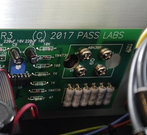

To-264 are cost economic but they don't have look of Digital-Do-Main 2SK77B 😀
Schade version SIT simulation with hockey puck IXFN have similar triode curves,
all parameters and yes that " style" package.
I like it very much Sir Rothacher pcb's solution show on the photos above.Thx to Audiohobby.com.
