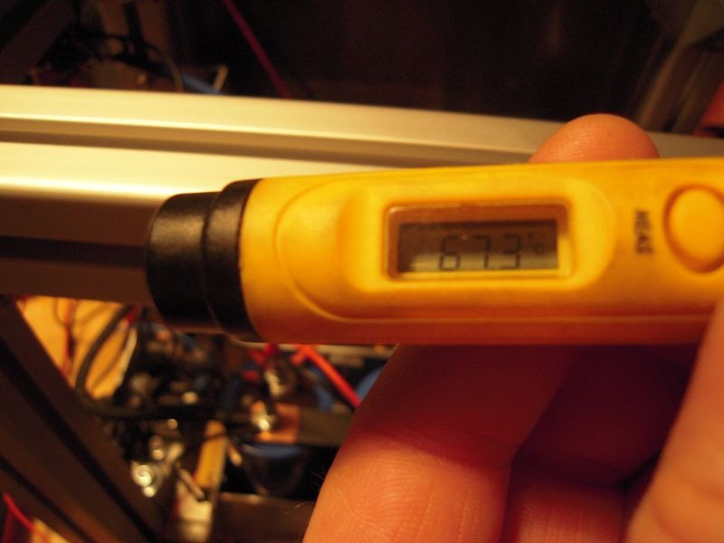

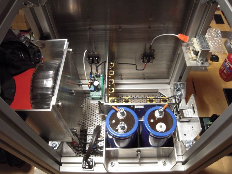

If you want to build a 50W-SE-Schade-Monoblock and you want to bias it up to 3.1 A, then you are asking for heat
and a lot of aluminum to transfer that heat away.
My ones are working now for the last two years without any problems. Heatsink is made of a 8mm thick aluminum plate as heatspreader,
Modushop 5U - 300mm deep and 3U - 300mm deep heatsinks. And still around 67° C outside the heatsinks where the MosFet is mounted
inside. I can't go over 3.2 A bias - then the bias runs away...
Test it - and enjoy a 'warm' sound
Cheers
Dirk

Heat is an understatement. My heatsinks are about 20 inches long (front to back), about 12 inches high, and the fins are about 2.25" tall. These heatsinks that were sitting on my shelf are huge compared to anything else I've built so I took a chance. I may have gotten away with it but after my heatsinks hit 60C I chickened out and put in a couple of small fans. I put a ton of work into this including making my own PCBs so I didn't want to see it go up in smoke.
