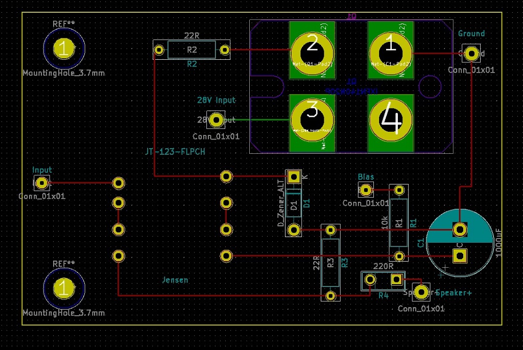

Still tinkering with KiCAD and trying to make some Schade PCBs.
Dan
I think there may be an error in your board. I believe that pin 5 (collector), not pin 6, of the 4N37 should be connected to the capacitor and 22R resistor.

Since this is my first time doing PCBs who would like to check my designs for flaws?
Dan
I think there may be an error in your board. I believe that pin 5 (collector), not pin 6, of the 4N37 should be connected to the capacitor and 22R resistor.[/QUO
Very good point!

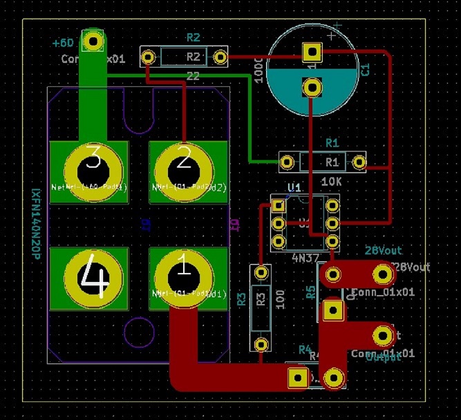

Not necessarily fixes of flaws, but merely some suggestions - I'm also just a diyer, definitely not educated in electronics but have done some reading, never designed a printed circuit board, but I have wired point to point circuits on boards:
1. Take J2 off the end of resistor R5 instead of off pin 4 of 4N37.
2. You can keep traces on the bottom of the board if you move the trace that is between the IXFN drain (3) and R1. From drain (3), run trace from the lower side of (3) horizontally between (1) and (2), and then turn up to R1 (on the bottom of the board).
3. For +60V power, enter board to the left of R2 and above drain (3), and go directly to (3).
4. It is my understanding that a ground return should be provided next to the power wire (twisted) to minimize loop area and therefore noise. So I suggest you bring your 60V and ground wires twisted together to the board. If all of the circuit traces are on the bottom of the board, you can then put a ground on the top side, entering next to the 60V, then down over the IXFN, and then horizontally across and exit near J2 and J3. You might need to enlarge the space for R4 and R5 anyways so then there is room to bring a wide ground trace across under the resistors to the right side of the board. You can then continue ground wires with the power and signal out wires at J2 and J3, again twisted together to minimize loop area.

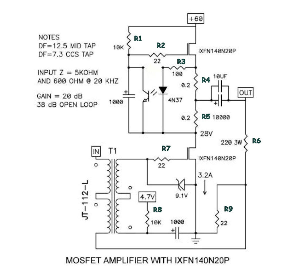

max swing/(R9+R6)=Ipp
say 60Vpp ( just to have round figure)
60Vpp/(220+22)R= 248mA
P=I^2 x R , but you need to translate Ipp to Irms , so to speak (recalculate AC to DC ,effectively) so Ipp/2/1.41 = 87mA
dissipation in resistors:
for 220R= 87mA^2 x 220R=1W69
for 22R = 0W169
so , 220R - use 3Watter
for 22R - use whateverWatter

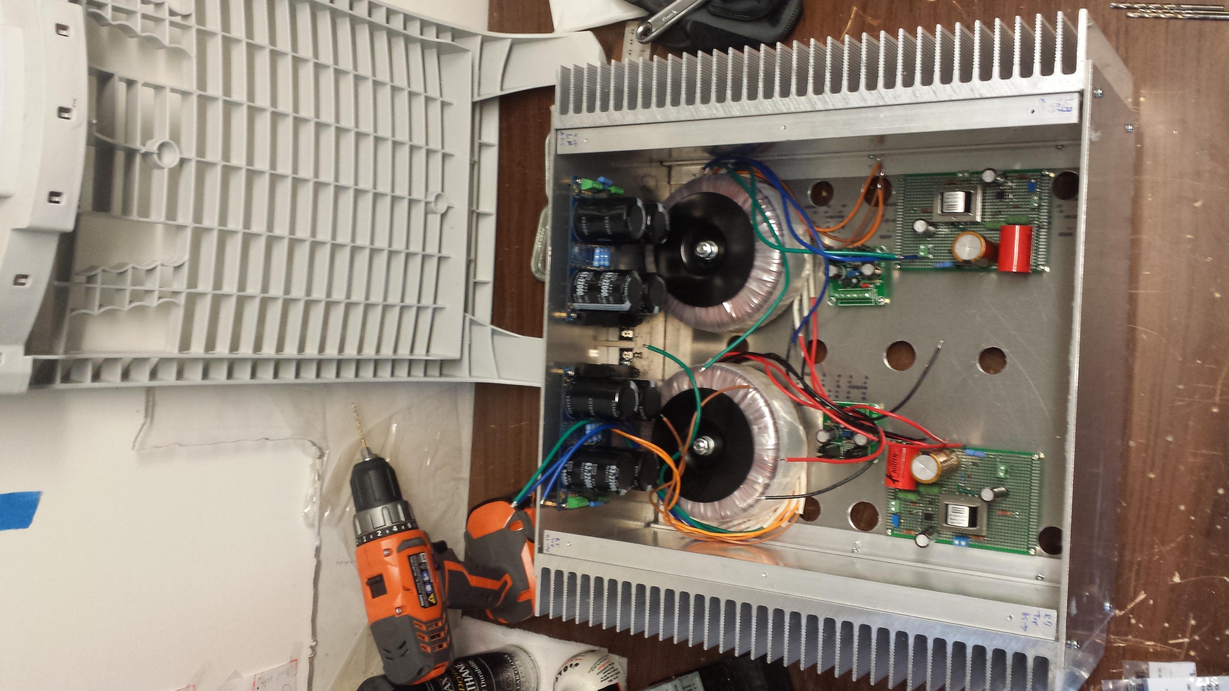

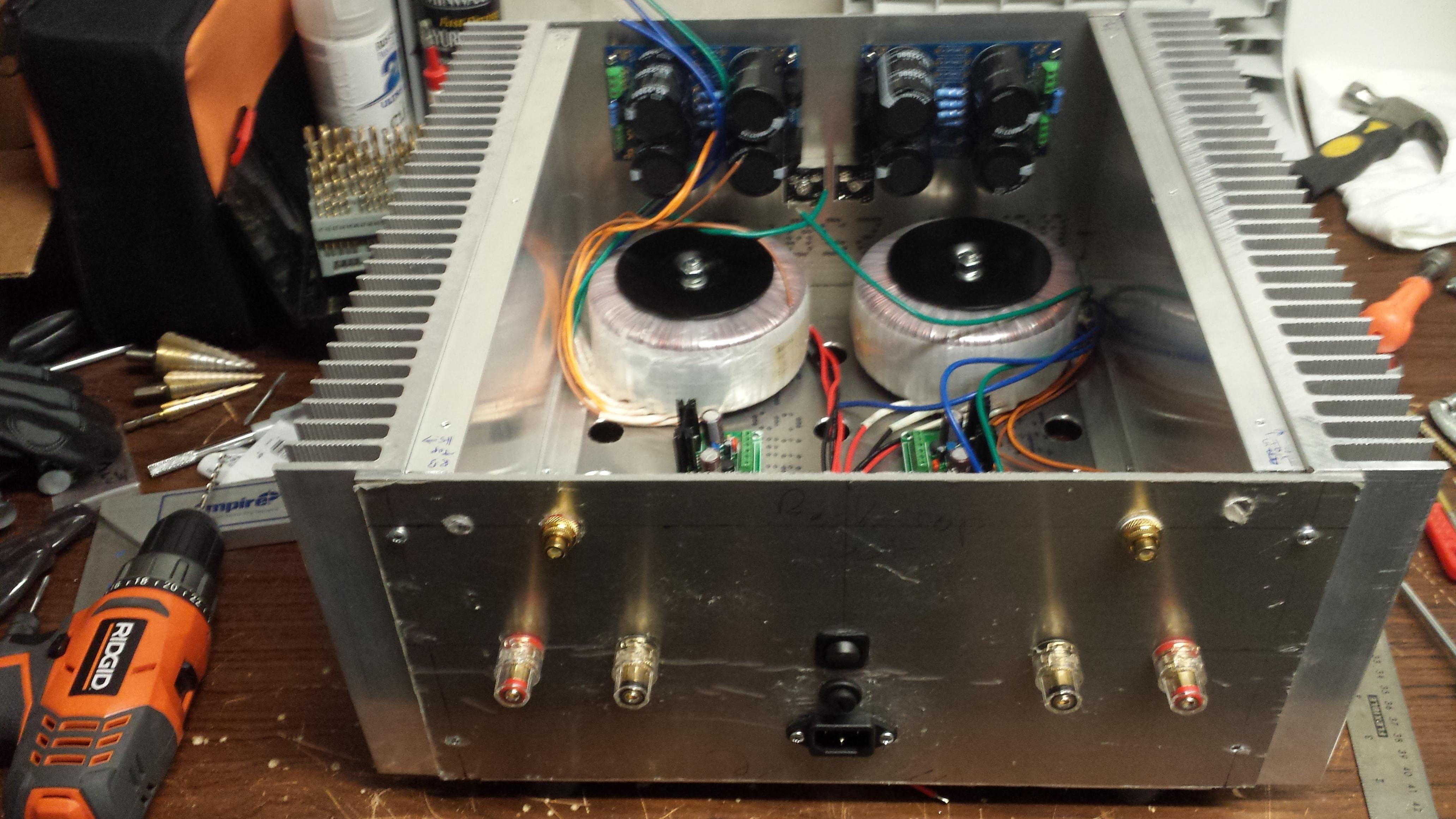

Finally made some progress. Put together to see how it all fits. Panels still have plastic coating.
Case is always the toughest part.
Built this one with just a cordless drill. 😉
That amplifier looks like serious business! I like the aluminum plate used for the panels.
You may have talked about this earlier, but are you going to use the heat sinks passively or with fans? I seem to recall dissipation is ~180W a side, a lot for even the biggest passive heat sinks.
This is a smaller 25w version.

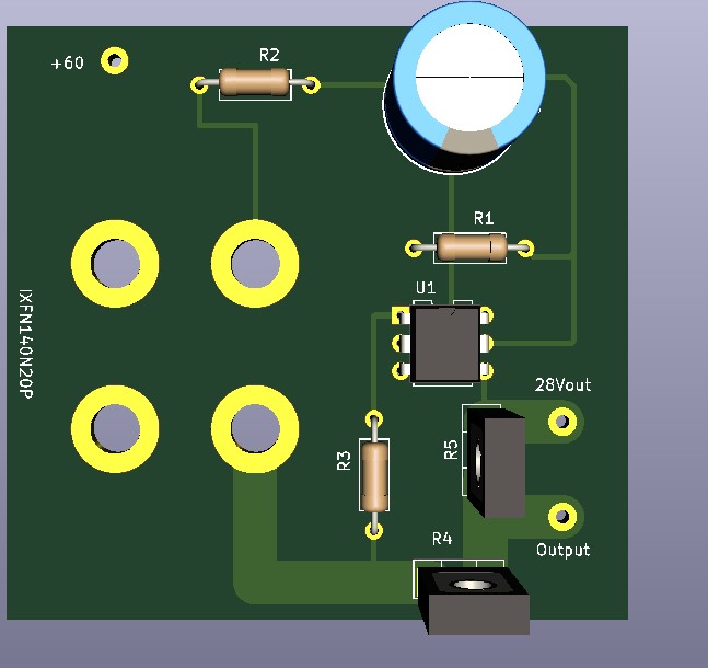

Trying to figure this out so I can determine what trace width I need on the PCBs I’m designing.

How's this?
