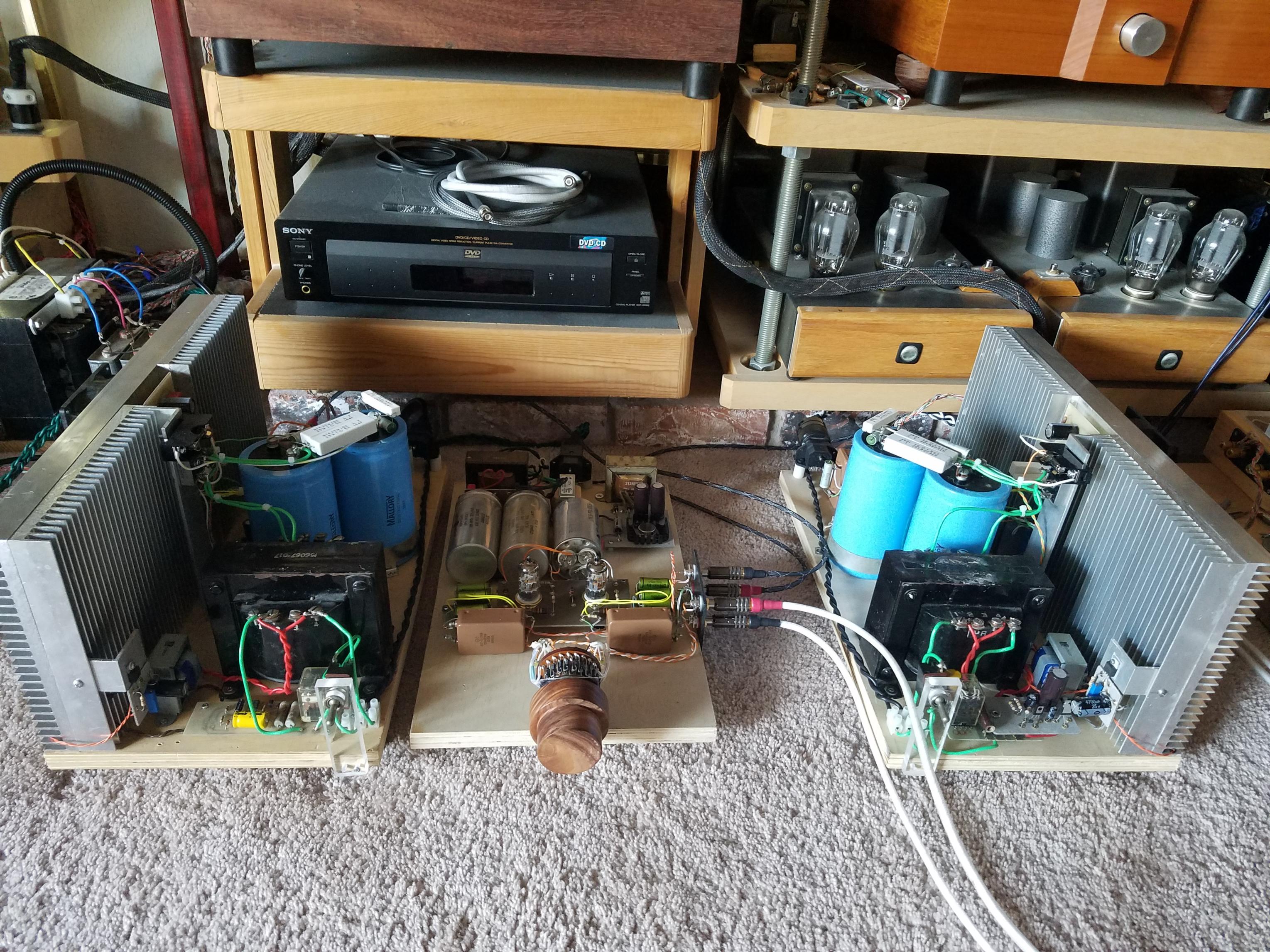

Rebuilt the amp with bigger heatsinks. The monoblocks have been running stable and with fans running at low speed, heatsink is moderately warm to the touch. I am currently driving it with a 6922 tube preamp. I've listened to it for the last few days, I am very happy with the results. Money and time well spent.
Have you compared it to another amplifiers? Does it handle complex music passages well, like metal music or symphony? No smearing of deatail?
It is hard to compare this amp to other amps because this amp needs a gutsy pre to drive. None of my other preamps is capable to drive it. I breadboarded the 6922 pre mainly for driving this amp and it is not my favorite pre for other power amps. So my impression was mainly for the amp and 6922 pre combination.
I have yet to throw some symphony music at it, but from what I hear so far, the tonal balance top to bottom is really good, there is ample of detail and the mid is nice I can listen to it for hours without feeling fatigue.
Yep, those are definitely 'bigger heatsinks'!
