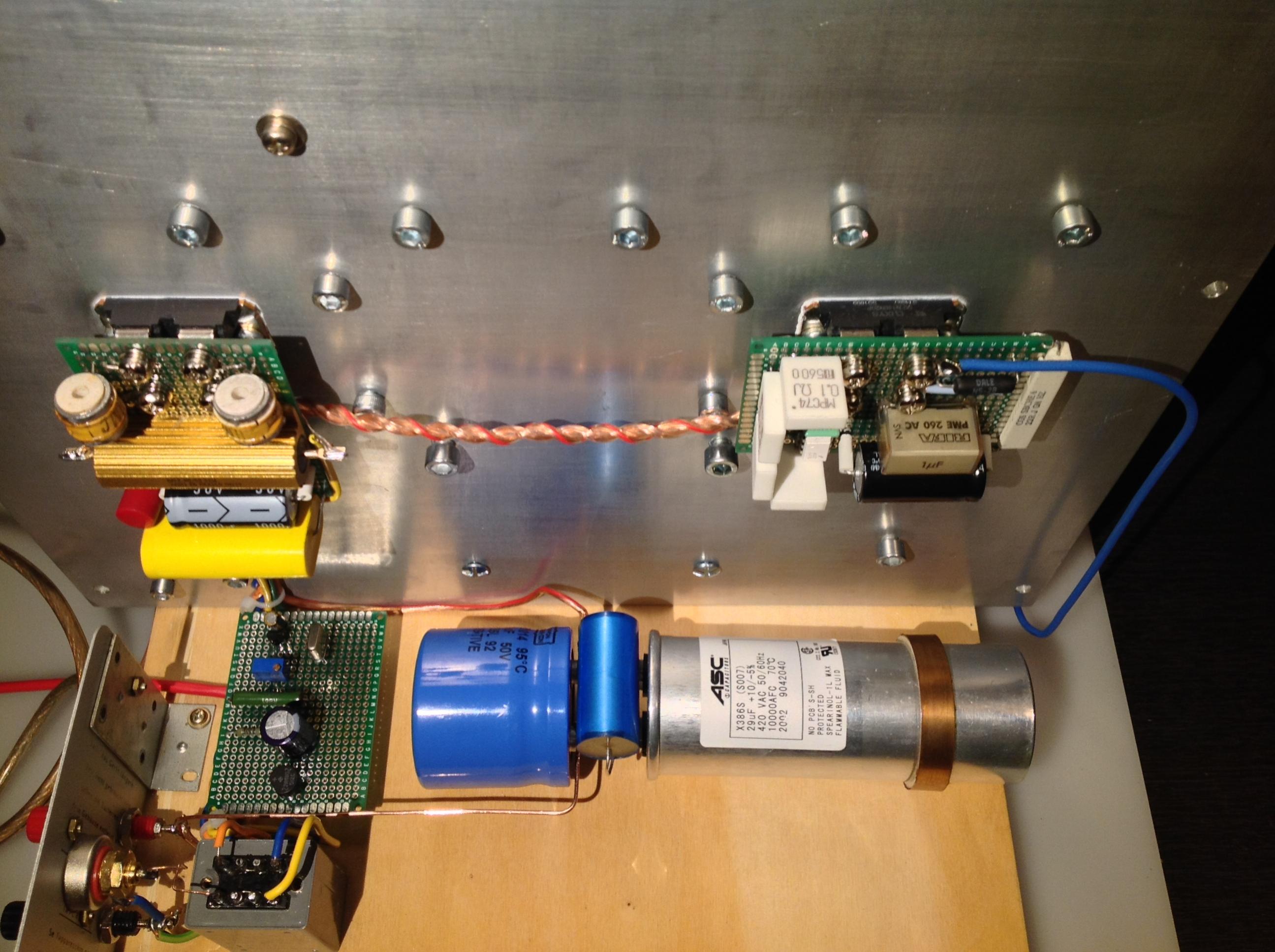

Thank you Soundhappy and Vdi_nenna for your advices. I finally fixed the problem. I reversed the secnondary connection of the input transformer, now no more oscilations.
But I am facing another issue and need your expert advice again, please.

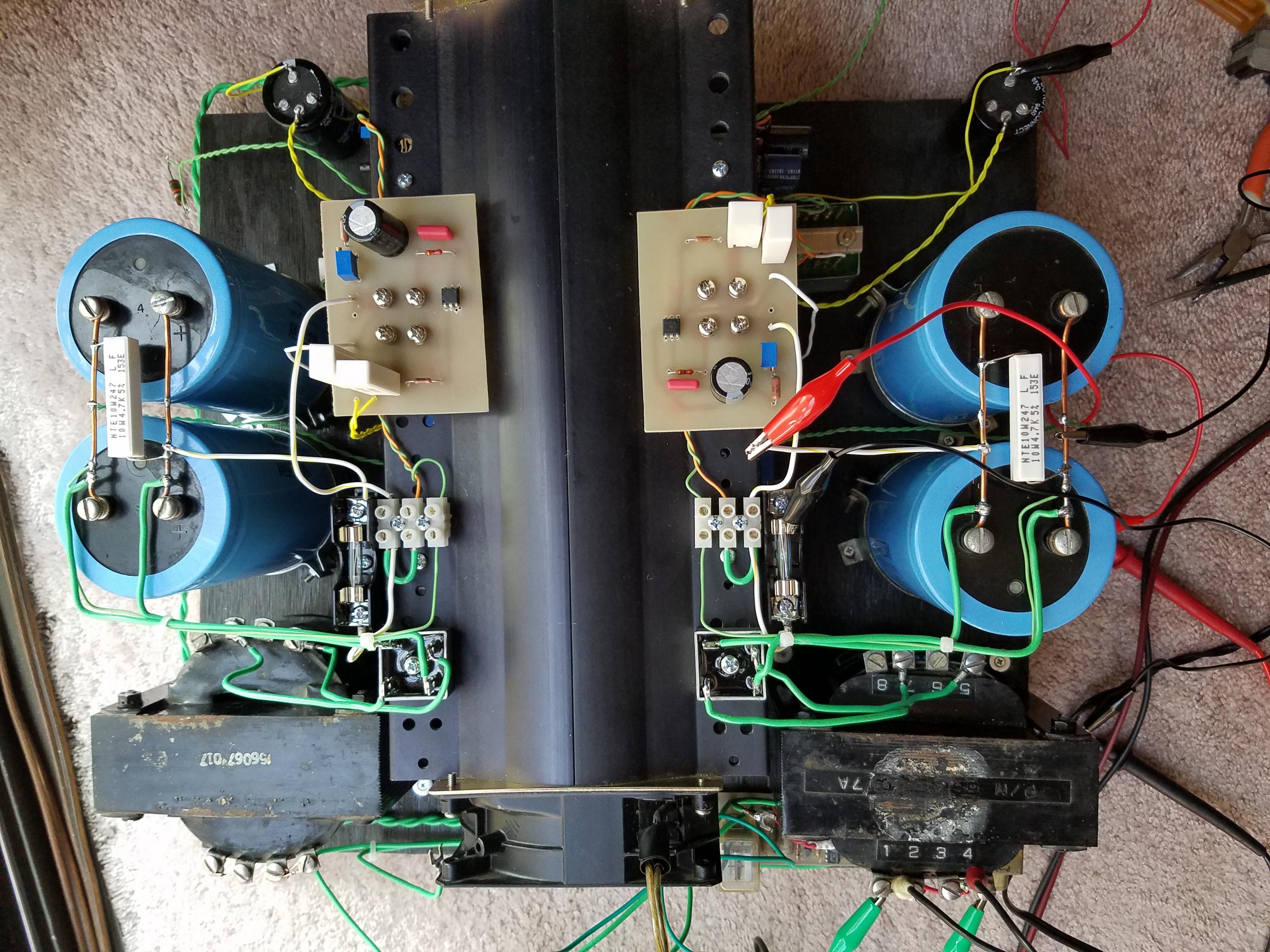

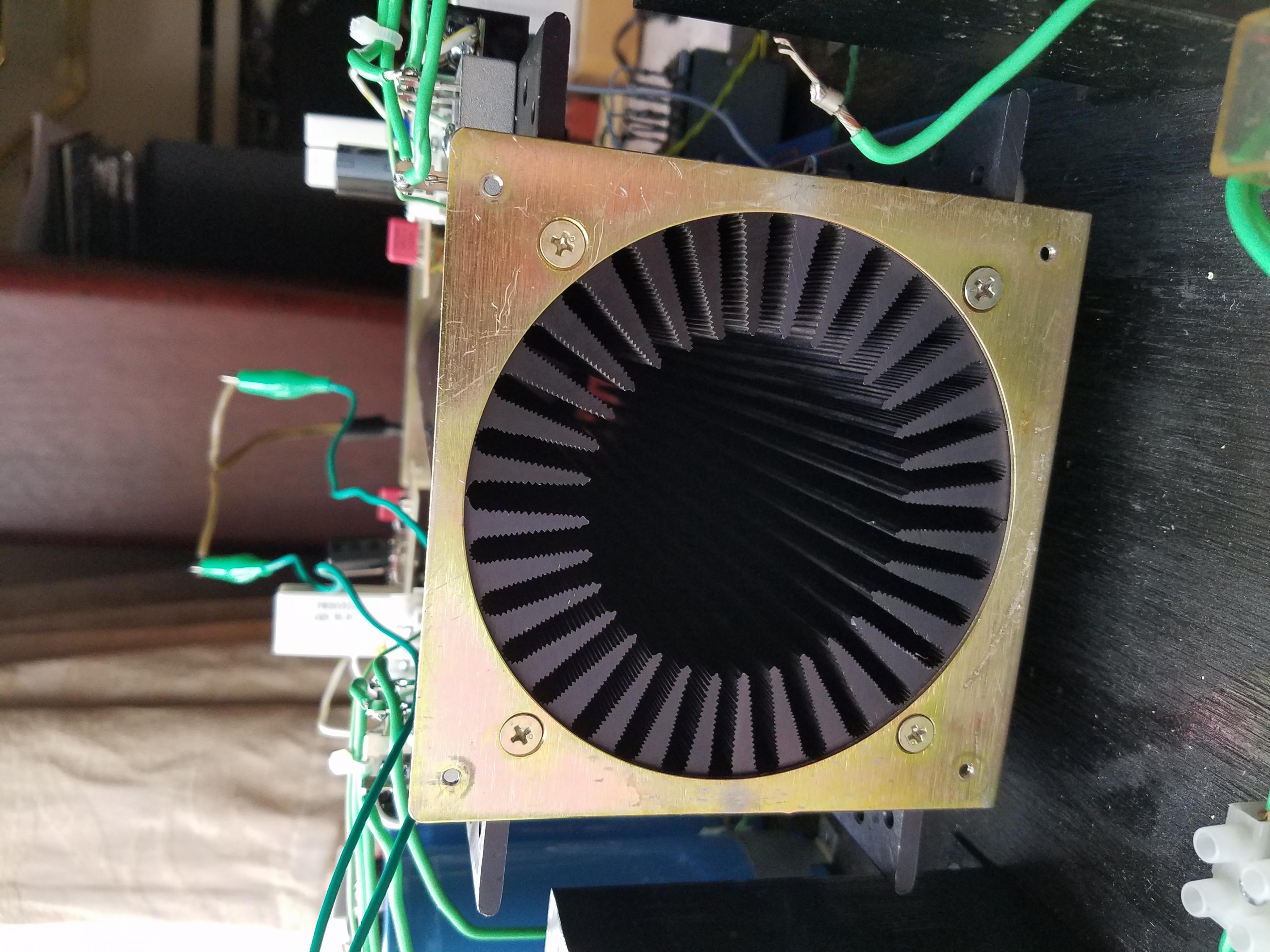

Heat: my heatsink measures 4.5-inch in diameter, 1-inch tall fins and 13-inch long. I am running a fan at full speed blowing the air thru the entire heatsink like a tunnel. I do not have specs for the heatsink but from the size and mess, it should be enough keeping the mosfet comfortable expecially with force-air cooling.
The CCS mosfet runs very hot. after 5 minutes of running(input grounded, 6 ohm dummy load), the heatsink becomes quite hot and cannot keep a finger on it for more than a few seconds. I worry the amp will be damage if I run it longer. The audio mosfet runs much much cooler. Is this normal? could there be still some oscillation that cause running hot? how
should i troubleshoot it?
How do I upload a picure of my amp to show you what I am making?

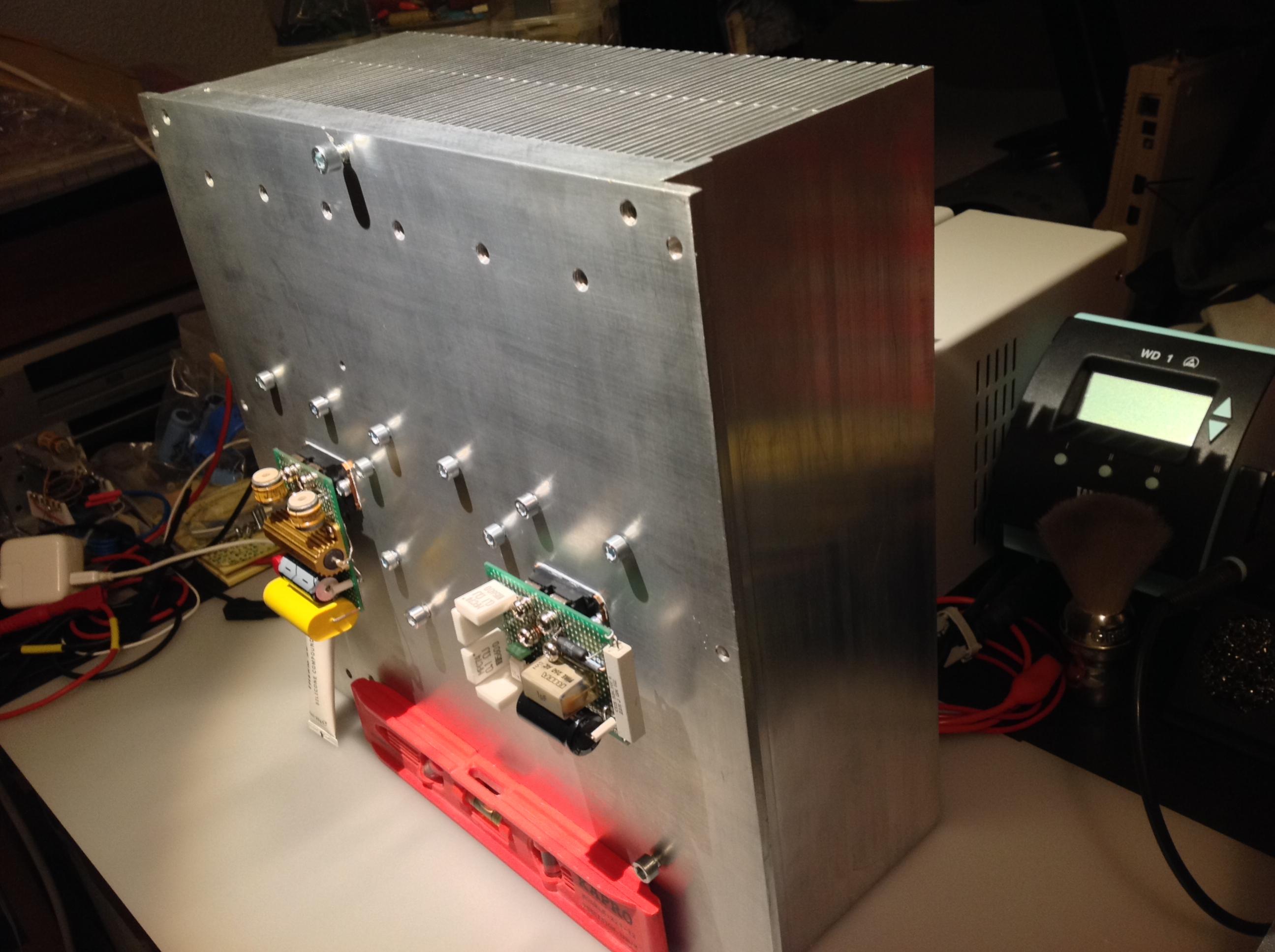

Here is my amp ready for a spin. However, it runs very hot. I may have to rebuild it with bigger heatsink
My mono block's heat sinks are huge and heavy ones , 3.2A current make them hot but no need for air ventilation.

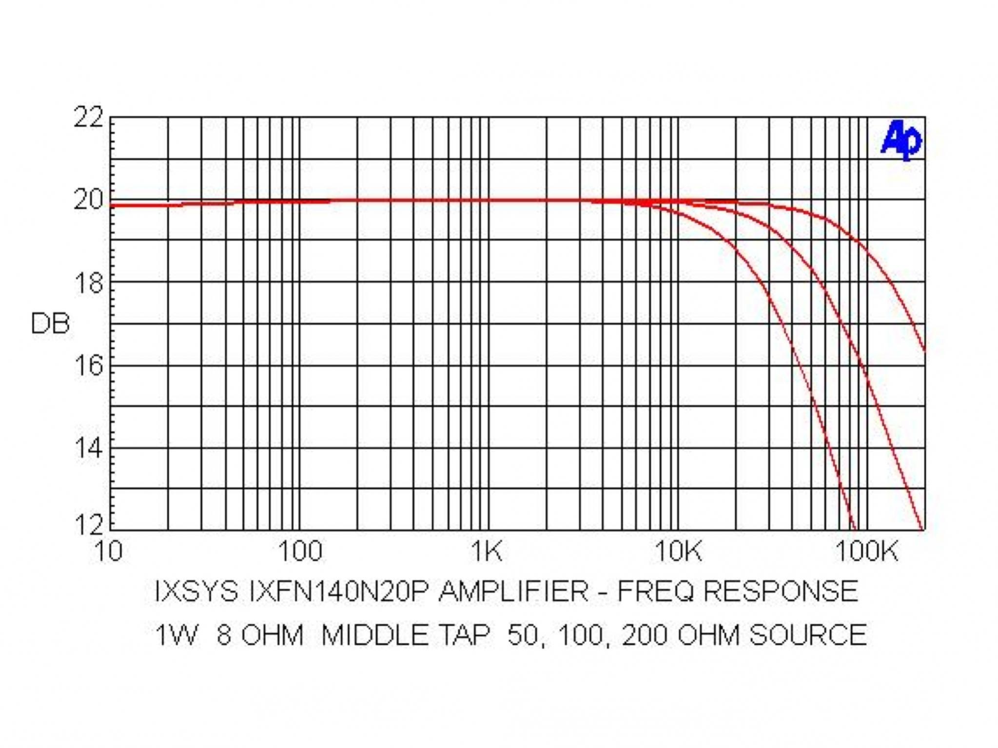

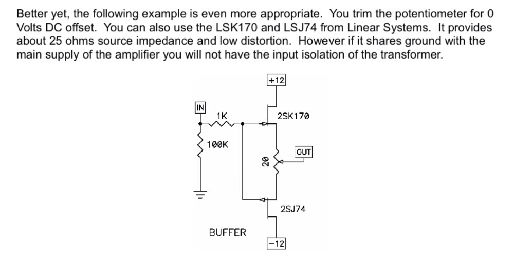

....I reversed the secondary connection of the input transformer, now no more oscilations....
@ Dmy
What is the input transformer brand, model You use ? Jensen, Cinemag or..?
Just for remembering: optimal wideband frequency response is easy to get with the Jfet's impedance buffer connected
to the hockey puck's amplifier game 🙂 Greetings

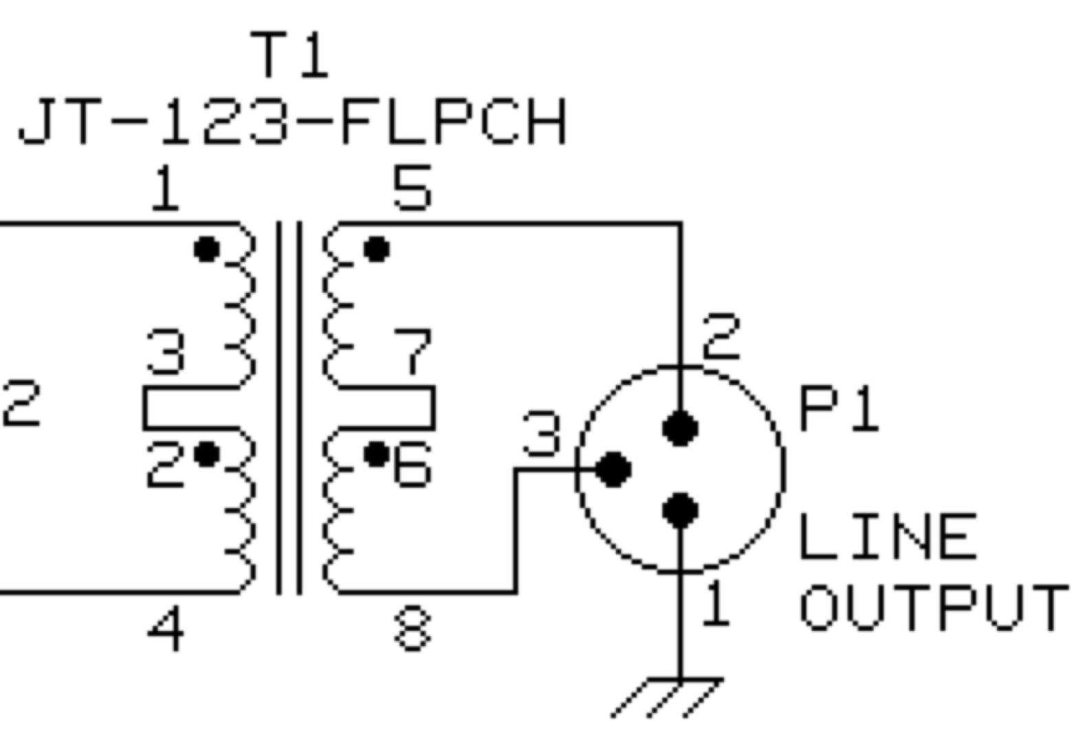

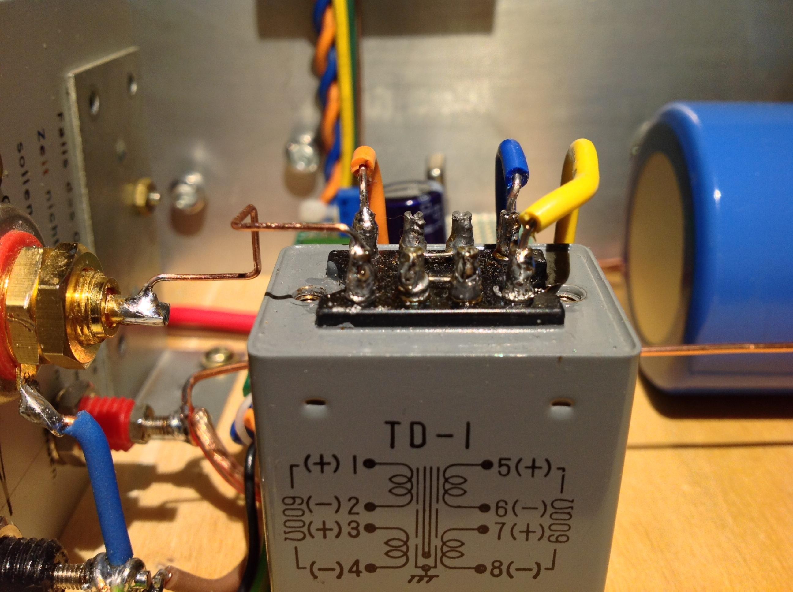

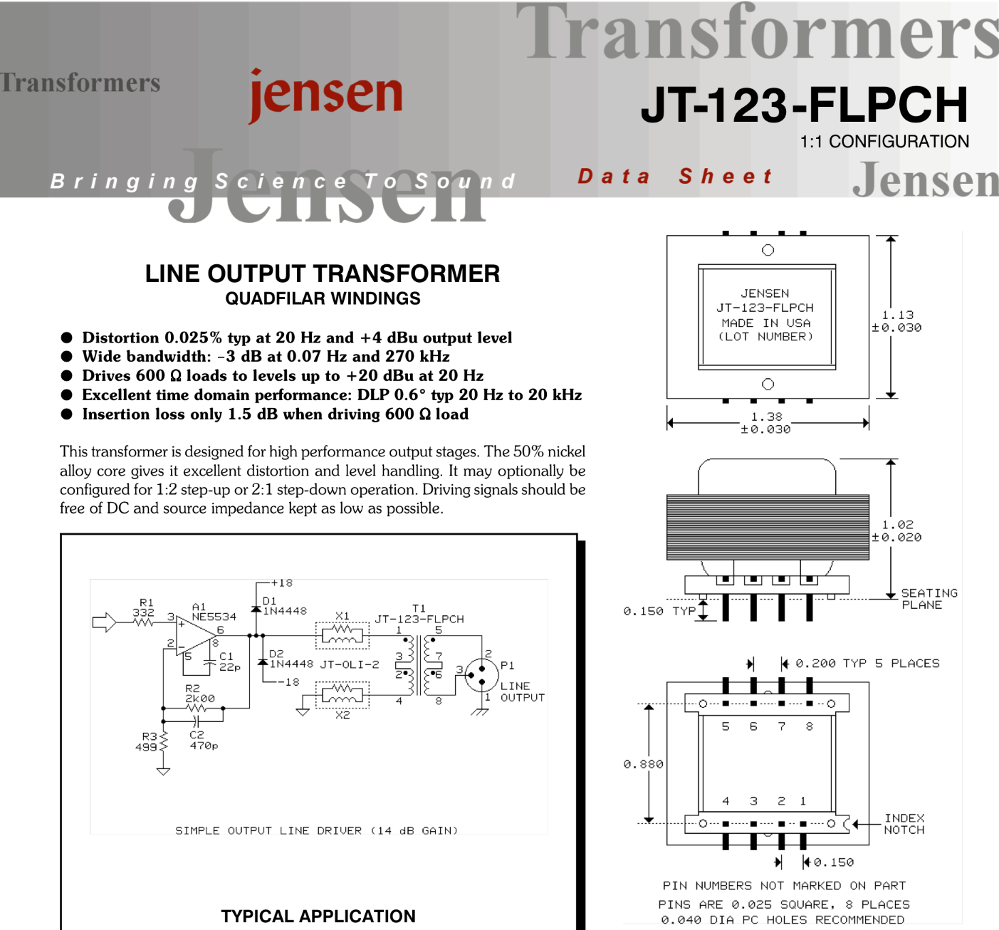

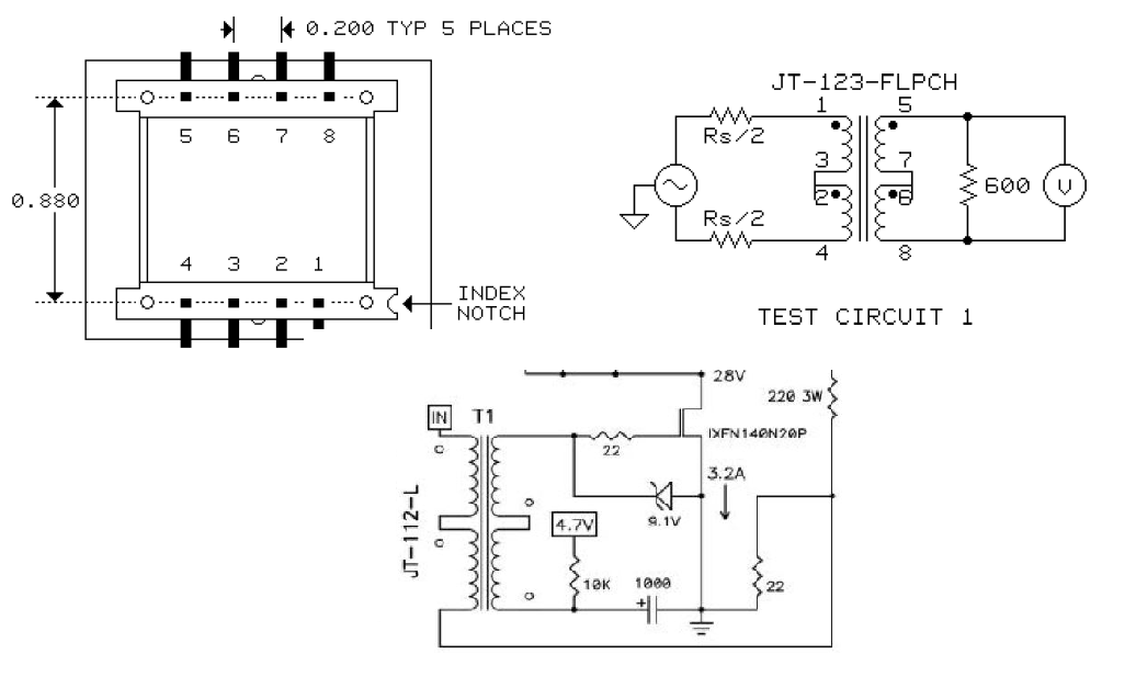

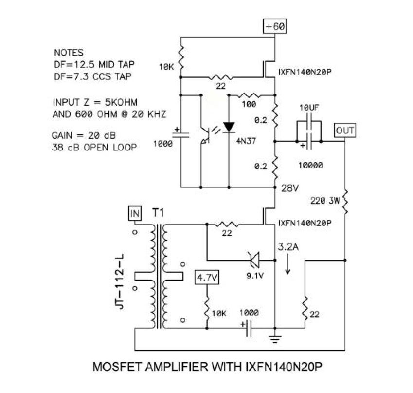

Question about the schematic in post 12.
The Jensen transformer's physical polarity, is it flipped manually to match the schematic or does the polarity markers end up being marked the same as the schematic?
I know it's stupid question, but I'm afraid to wire it incorrectly.
I guess I can place the secondary in series and just flip the connection to the circuit board or next connection points. 😱
Sorry, I have a little mental block with this for some reason. 😱
Imho is the pins numbers and the dot's symbols important to connect them the same order
like was show on the official Papa schematic :
secondairy center connection is pin 5 connected with pin 8.
Then pin 6 to 10 K resistor and pin 7 to 22 Ohm resistor.
Tamura have not the dots symbols but is equivalent of (+) polarity output pin 🙂

Soundhappy,
what is the size of your heatsink? My input transformer is no brand, It is 600:600. Last time I used it in a DAC sounded really good.
I have yet to hook up the amp for an audition, probably I will this weekend.
