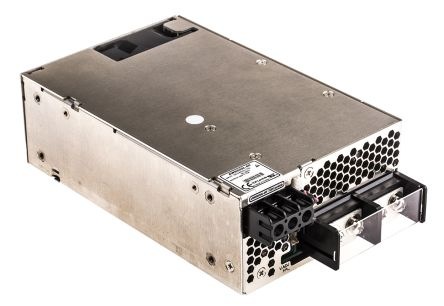

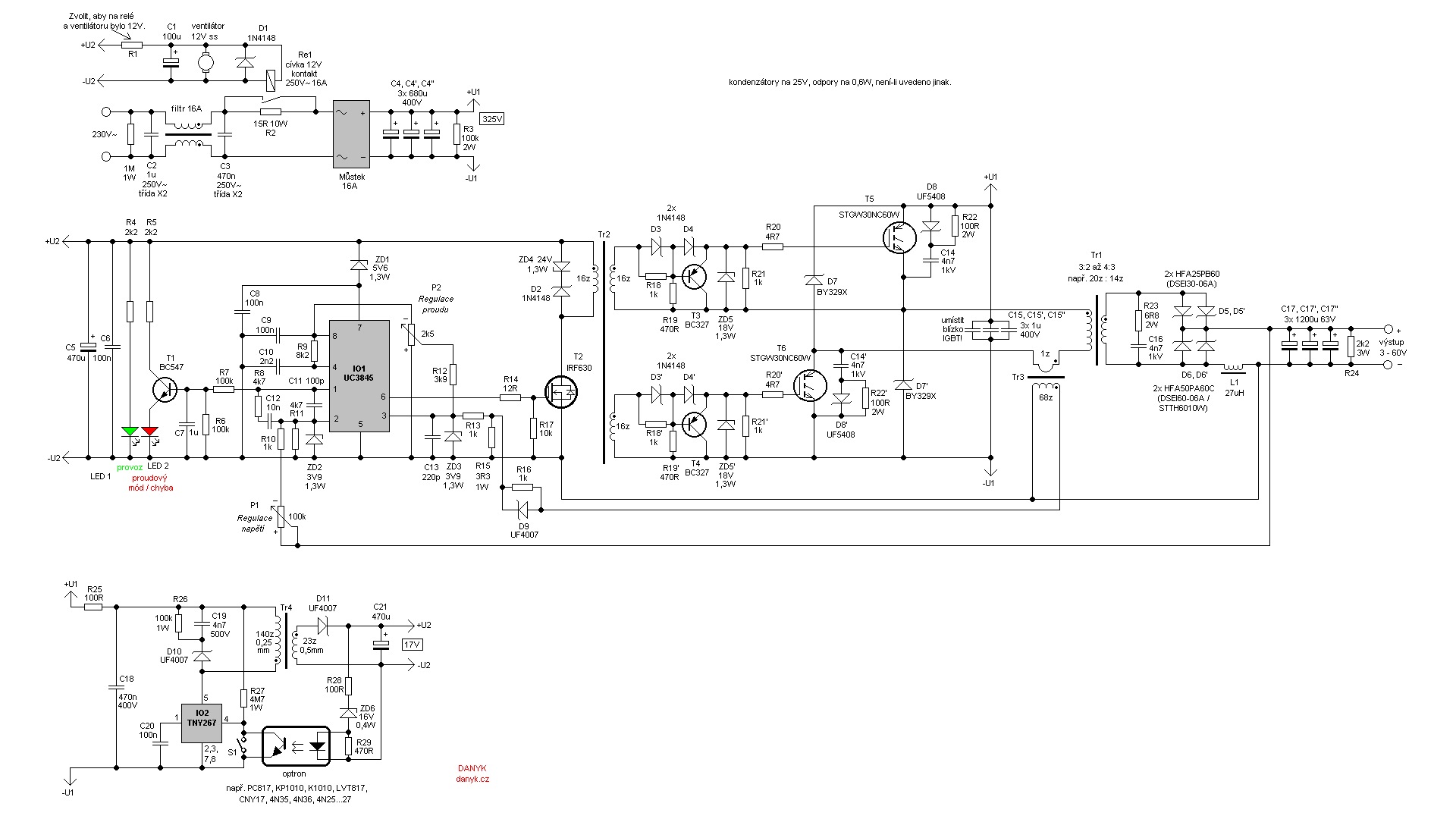

About SMPS ....well maybe build huge DIY 60 V | 40 A BRICK
High power adjustable switching power supply (SMPS) 3-60V 40A
Edit : ready made from RS cost a small fortune :
SWS600L-60 | TDK-Lambda 600W Embedded Switch Mode Power Supply SMPS, 10A, 60V dc | TDK-Lambda

This one will do up to 56v to 12.5A.
Mean Well MW SE-600-48 48 VDC 12.5A 600W Regulated Power Supply

From the website:
"Forced air cooling regulates temperature internally."
The fan could be audible and annoying at low volume level.

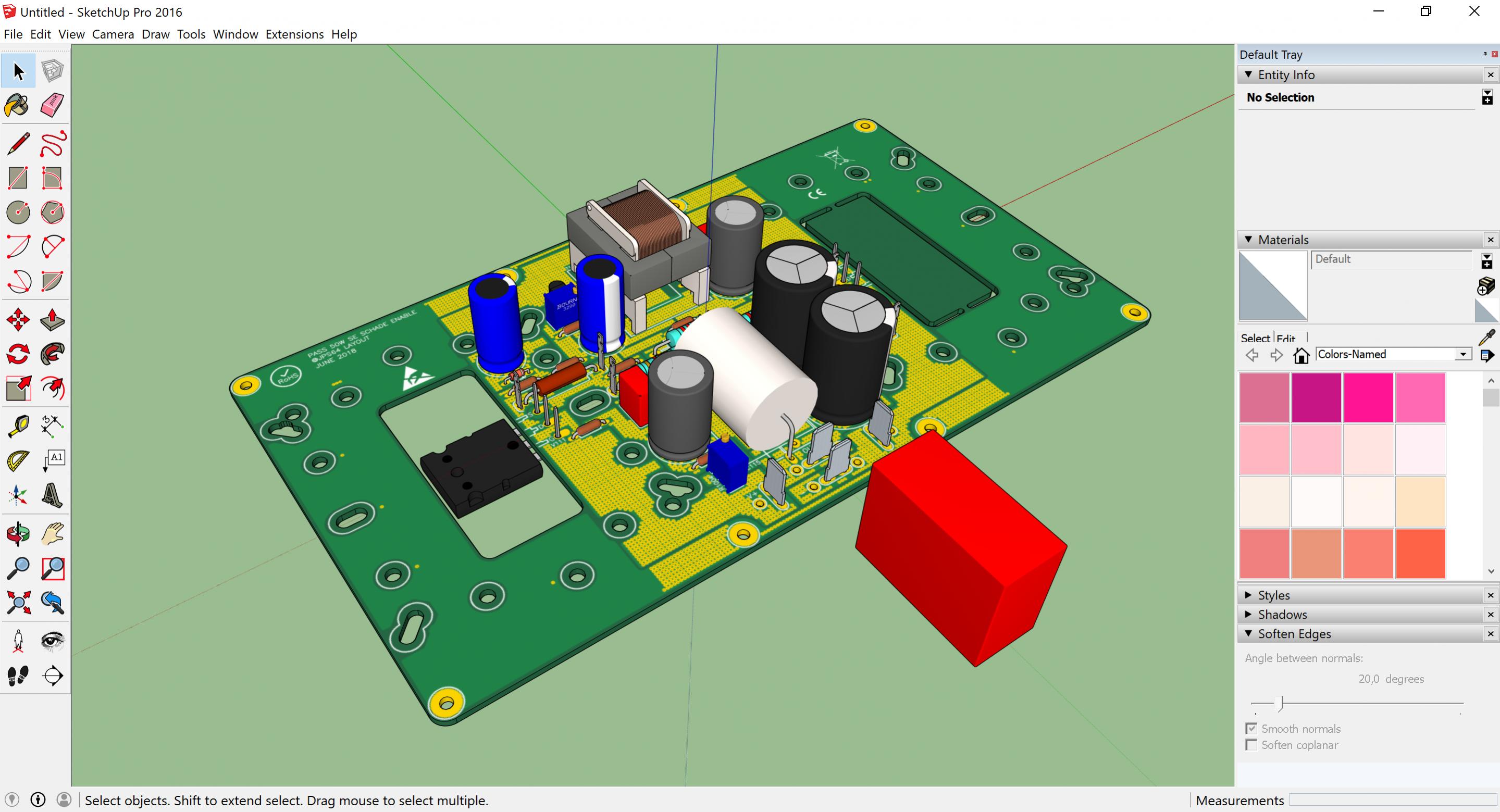

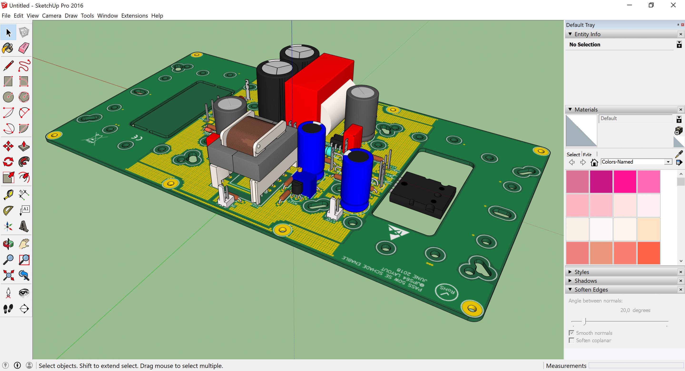

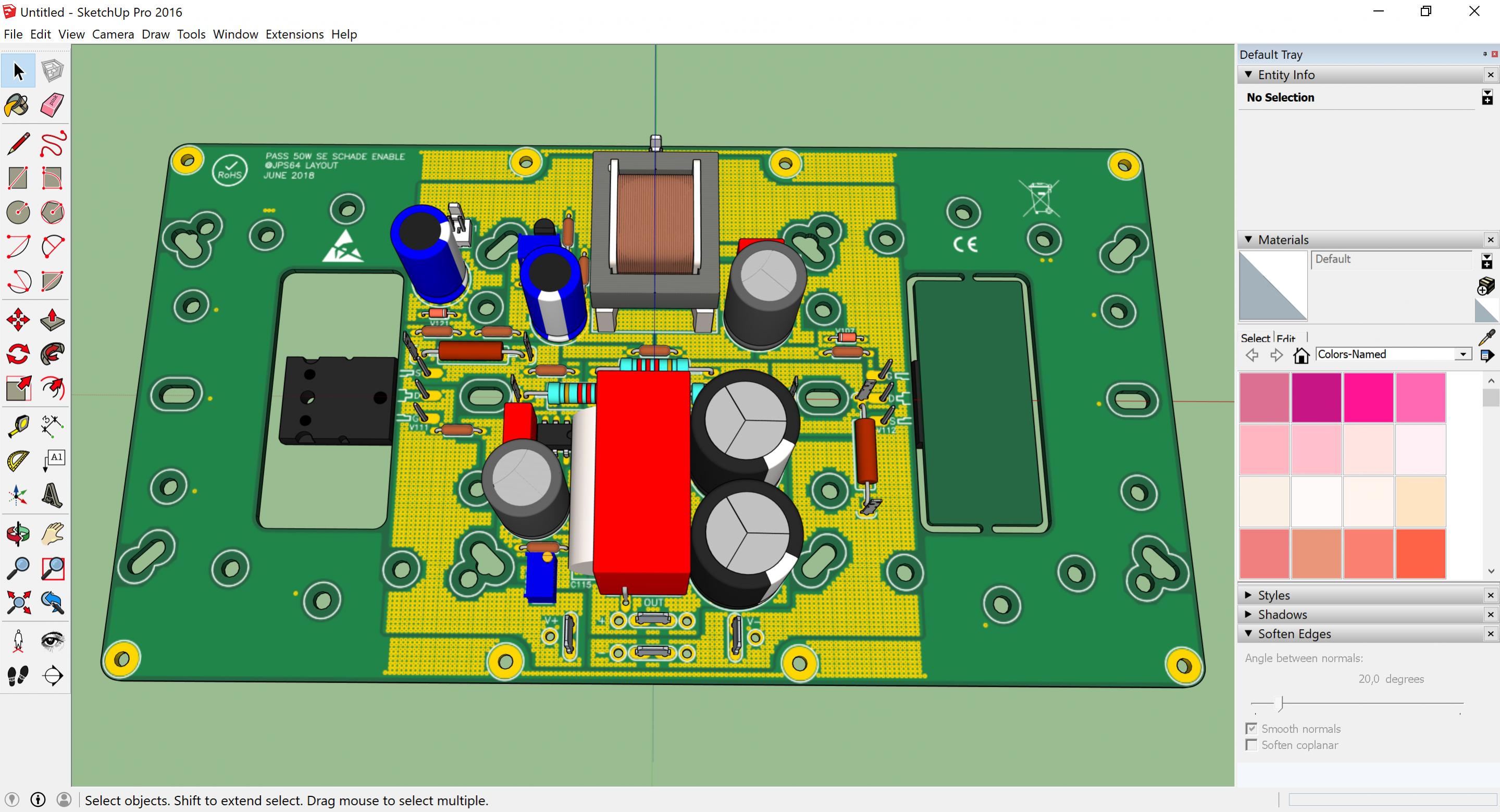

Hello,
as done for the ALPHA BB, here the CPU cooler fan version of this amplifier using TO264 IXYS (using CineMag CMOQ-4XPC in 3D instead of JENSEN JT-123-FLPCH).
With the permissions (Pass, @vdi_nenna and the others) and if someone wants to build this version then I´ll finish the job and put all the datas including manufacturing datas here online so that someone can organize a GB.
I´VE PERSONALLY NO GB INTENTION!
P.S.: input could be designed on the right (or left) waste panel but I need schematics.
JP
JP
