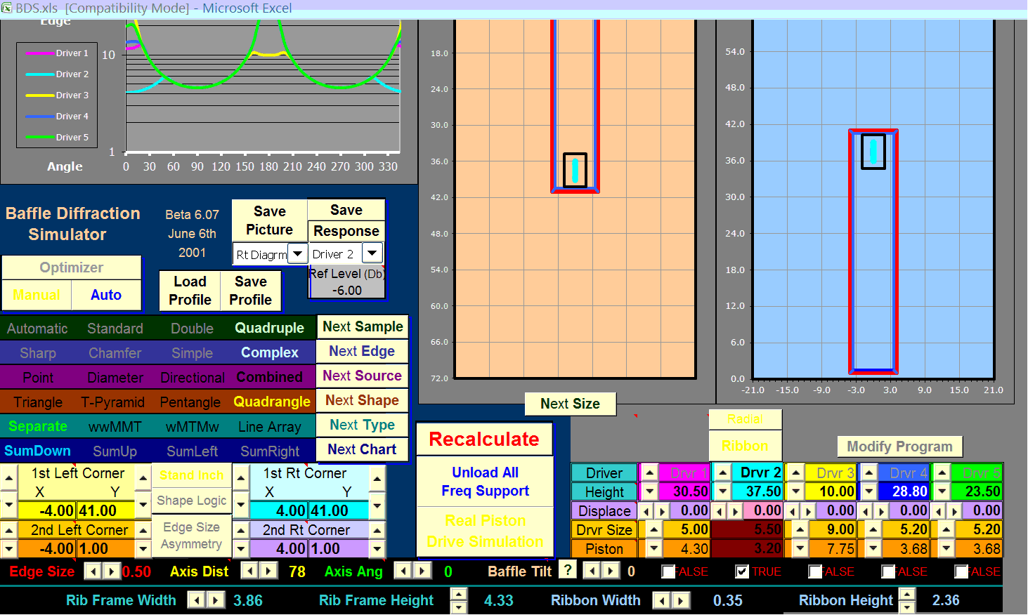

Ribbons: Really struggling with BDS and Edge. I can't seem to get some of the options you have visible on BDS. Notably the last row, where you have ribbon options. I don't seem to be able to change the driver type from the default of Dome. I've entered all the other params (just in case) as you have them but still can't change from Dome. Any ideas?
Yes, that BDS is not easy to get a handle on. I'm not sure if that's a capture of the program you're working on or if it's a re-post of what I attached before.
If this is what your program is looking like, then everything looks right and it should work.
If this isn't what your's is looking like and it still is working with a dome tweeter, the button to change it is right above the cell that says "Drvr 2". So in the picture it says "Ribbon" in yellow. Click on it and it will change back to "Dome". And repeat.
I also tend to turn "Shape Logic" off as it can be a bit of a fly in the ointment.

Sorry yes, the image (for reference of what i'm trying to get to) was the one you posted originally. The dome button cannot be pressed. I think someone else must be required before that button is available but I can't figure out what.
Yes, you are correct.
Try right in the middle. Hit "Add basic freq support" and then "add advanced freq support". That should make the dome/ribbon button available.
I think I then saved the program in this configuration so I didn't have to do those things again.

You should also hit the Sample, Edge and Source buttons afterward to change them back to Quadruple, Complex and Combined respectively.
Which ribbon driver are we talking about here? If it's the 3.5H then do be aware that the wave guide will affect how the driver interacts with the baffle it is placed upon. Usually wave guides reduce the effects of baffle diffraction.
