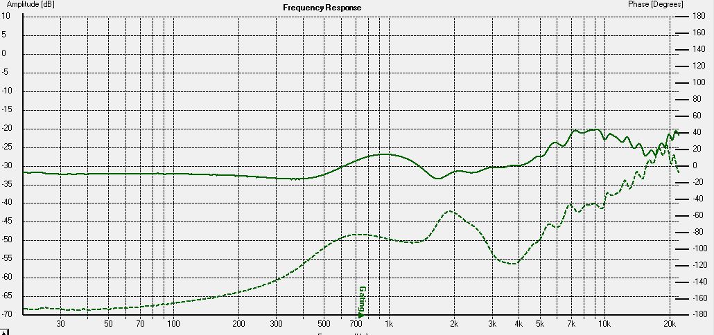

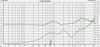

I'm revised the XO a little and here the new FR.. The sounds balance seems much better but perhaps a little too much treble.
One thing that seem off is. The mid range is pretty muted and when I play much that is dynamic and fast paced, the mid is muffled / laggy.

Re the balance, it looks like you need to tame the tweeter some more. Add some more series resistance.
Re the mid, it actually looks a little high as well so if it sounds muted/muffled that sounds more like a quality issue than quantity. So I'm wondering if the mid chamber is overstuffed. I'm not actually sure what you did for stuffing but you might try removing it and comparing.
When making changes, 1 thing that I've found that helps is to make fairly large changes to start off with and compare because that really helps you to identify what it is that the change is affecting. Then once you're attuned to that, then pull back bit by bit until things sound just about right, maybe somewhere in the middle of the 2 extremes or maybe somewhere closer to 1 extreme or the other.

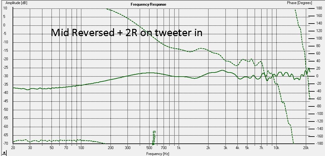

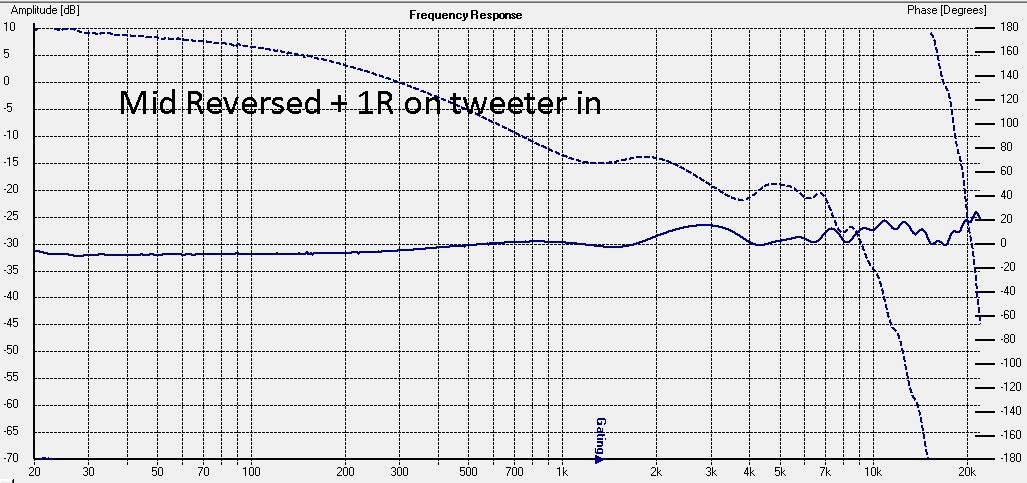

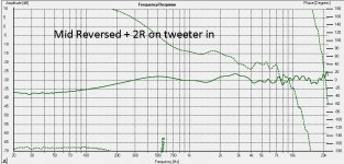

Hi jReave, thank you for all the suggestions. I've implemented a few things and the results are looking a lot better.
I'm not sure why the woofer is so flat.. I can't find a window option in HolmIpulse?
1. Removed BAF wadding from the mid chamber. Sound dampening materials still in place.
2. Added a little BAF wadding to the bottom of the woofer chamber.
3. No insulation in the woofer enclosure
4. Mid reversed polarity
5. Replaced R3 (11 ohm) to 6.8 ohm
6. Replaced R8 (3.5 ohm) to 1 ohm
I'm pretty happy with the FR graph and it sounds very nice too! 🙂
What do you think?
The two images are the difference between R8 set at 1R or 2R

So glad they're sounding better. Good job.
At the stage you're at now, the final arbiter are your ears. It doesn't really matter what the graphs look like - if you like the sound of it better 1 way vs the other, then that is the correct way for you in this room with the speakers set up where you have them and sitting where you do. Don't forget that when your ears are listening, you are hearing more than just the on-axis response which is only what you are seeing in the measurements. Mind you 1 of the reasons I chose 2nd order filters all the way around is because they produced a very flat power response as well, or in other words the on-axis and off-axis responses should be pretty similar.
I think of the measurements now as just a tool, as a way to give you a visual reference for the changes you are making, but again, it's your ears, your subjective response that should be making the final call.
I probably have 2 more resistors that I suggest you can play with. We'll start with the 1 that focuses on that little peak at about 2500Hz, R10 13ohm. Reduce it by a large amount to start off with, listen and then adjust at will. Measure if and when you feel like it.
Btw, patience is your friend here. This final fine tuning and tweaking stage should take some time. Like, I'm talking a number of weeks if not months for some people. You've now got it pretty much into the ballpark, so live with it for a week or so and then make just a small change of an ohm or so and live with that for another week or until you feel confident in which version (or combination of versions) you like better. Also just in case you haven't figured it out yet, make only 1 change at a time.

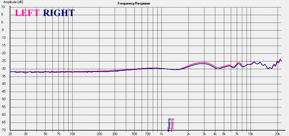

The loud speaker gods are smiling and so am I 🙂 Really enjoying the sounds they are producing, even with the little bump at 2.5Khz. I'm going to live with this setup for a few months time and then revisit the bump and fine tuning when life is less manic 🙂 The bass isn't as overbearing as i'd feared, in fact it seems very smooth and pleasing to the ears.
Agree with the measurements and usage. My target has always been a flat FR but its my ears that are the real test. I will have to apply some room correction for due to the position of the left speaker. The right speaker's FR doesn't change significantly up against the wall vs when I was measuring away from the wall by a couple of meters.

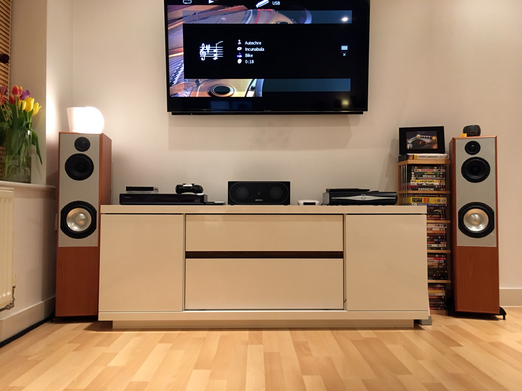

Here's a few photos of the end product and my FR measurements before placement. I'm happy with the L&R FR looking so close to each other! 🙂
So project not complete, just yet.. but a massive milestone achieved! A huge thank you again jReave and everyone else who helped out. There's no way i'd have got to this point without your assistance and patience 🙂
Time to listen to some music and dream about another loudspeaker build 🙂

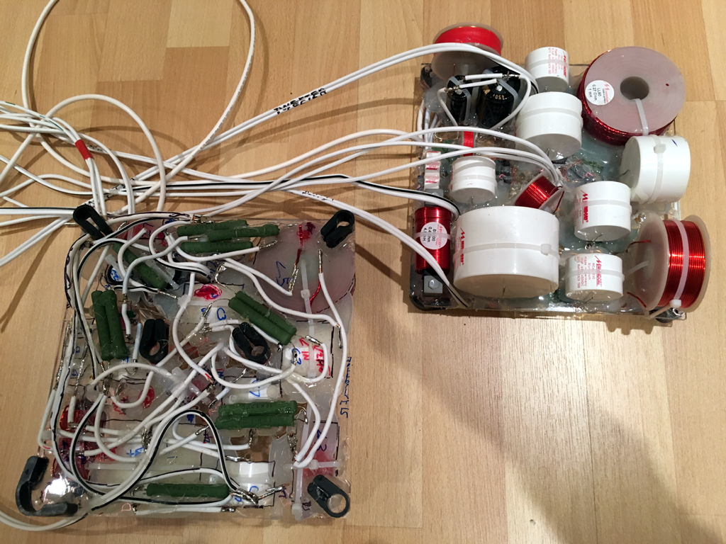

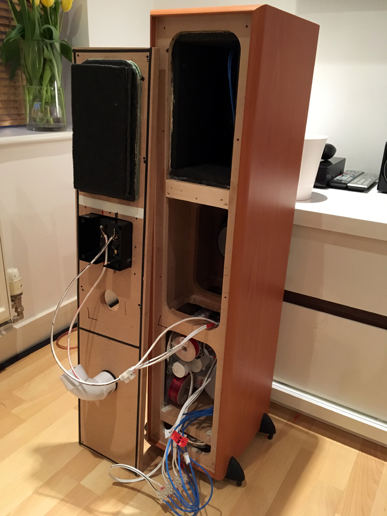

That is just firkin awesome!! Those look absolutely fantastic. Very hard to tell that those are not the original speakers in that last photo. Pat yourself on the back and pour yourself your favorite beverage - you deserve it! 😀
Good call, take a break, listen for a while and return with fresh energy and perspective when it's more suitable.
Well done my friend.
