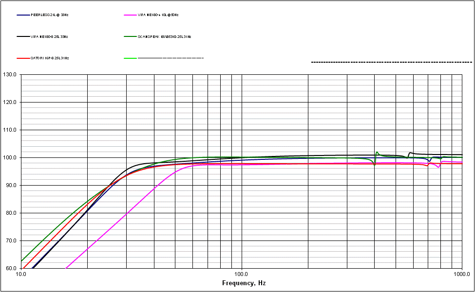

I'm revised the XO a little and here the new FR.. The sounds balance seems much better but perhaps a little too much treble.
One thing that seem off is. The mid range is pretty muted and when I play much that is dynamic and fast paced, the mid is muffled / laggy.

Just to make sure - your measurement is with the mic about 1m more or less on the tweeter axis with a short window of 3 - 5msec? I'm not sure why you are showing a flat response below 100Hz. A little suggestion would be to continue to repeat your measurements until you get exactly the same response each time.
As we continue here, post a xo schematic from XSim so that I'm aware of the changes you are making.
Re the balance, it looks like you need to tame the tweeter some more. Add some more series resistance.
Re the mid, it actually looks a little high as well so if it sounds muted/muffled that sounds more like a quality issue than quantity. So I'm wondering if the mid chamber is overstuffed. I'm not actually sure what you did for stuffing but you might try removing it and comparing.

Hi jReave, thank you for all the suggestions. I've implemented a few things and the results are looking a lot better.
I'm not sure why the woofer is so flat.. I can't find a window option in HolmIpulse?
1. Removed BAF wadding from the mid chamber. Sound dampening materials still in place.
2. Added a little BAF wadding to the bottom of the woofer chamber.
3. No insulation in the woofer enclosure
4. Mid reversed polarity
5. Replaced R3 (11 ohm) to 6.8 ohm
6. Replaced R8 (3.5 ohm) to 1 ohm
I'm pretty happy with the FR graph and it sounds very nice too! 🙂
What do you think?
