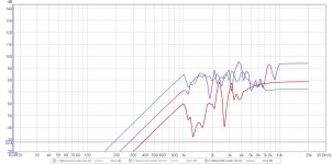

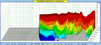

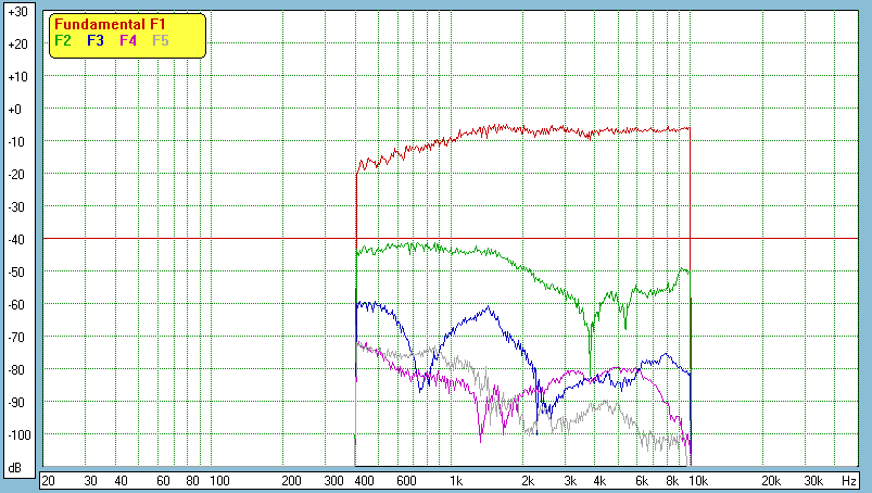

Just like you I have been interested in ribbons for a while. I have always wanted to build a loudspeaker using a pair, just to see what, if anything, the hype is all about. Trouble is I'm yet to find a small, affordable device that could be used with a small mid/bass or full ranger that could give a dome a decent run for its money.
Is there some reason why you want a frequency response extending up to 40kHz? I'd be surprised if you could hear anything beyond around 15kHz. Adding to this the vast majority of music out there has a brick wall filter present that prevents anything from above around 22kHz from even being present on your recording medium. Then there's the fact that most microphones wont capture much above 20kHz either...
Ignoring the above though the R3004/602010 from Scanspeak will do what you're after, but at a price.

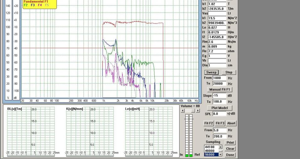

Of course the harmonic distortion of a ribbon's raw FR looks horrible. The question is, how does it look when it's properly filtered?
Graph's below:
1) Fountek CD3.5H THD by audioexcite

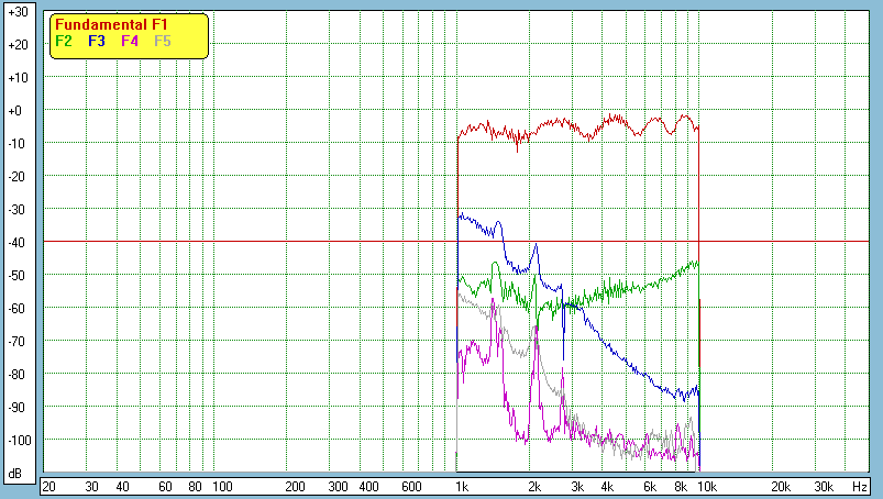

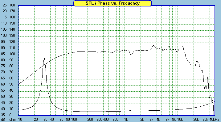

2) Fountek CD3.5H HD measured by a 3rd party (I unfortunately forget who I copied these from now)

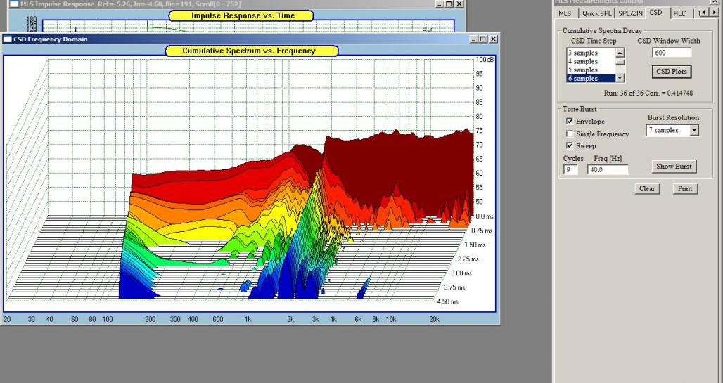

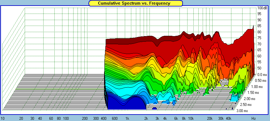

3) Fountek CD3.5H CSD
4) Fountek CD2 HD by Zaph

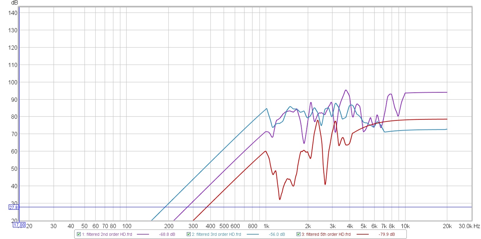

5) Fountek CD3.5H THD with LR4 HP @ 4500Hz and notch filtered at 2000Hz
6) SB 29RDNC for comparison
Comparing audioexcite's measurements and Zaph's measurement of the CD2 with the 3rd party's measurements suggests to me that they don't hurt for accuracy. But since they were easier to trace, I've used audioexcite's THD curves for the 5th graph but had to change the scale: 80dB is about .1% or about -80dB in the other charts. 100dB is at about -60dB and so on.
And with the filters in place, the CD3.5H 's 3rd order distortion (which along with the 5th is the most egregious) actually remains at or below just about the -80dB mark both before and after the 4500Hz xo point which isn't too shabby actually. Looking at the SB 29RDNC, except for 2nd order they look fairly comparable. And above 2000Hz, the CD3.5H is showing fantastically minimal diaphragm resonances in the CSD plot.
So unless I've made a grave error somewhere or my understanding of harmonic distortion is faulty, I wouldn't be throwing the ribbon out of contention yet. But the center to center spacing is still a problem at the higher xo point so it does call for a smaller mid but there are always compromises. And in fact I see that rule of thumb broken so often that I still consider the NE123 a possible match with it. Mind you I don't disagree with 5th that the Peerless 6.5" + Satori 13P-8 + something like the SB29 tweeter would make a great speaker.
spark, you mentioned looking for a flat FR a couple of times now but in reality what you want is for the manufacturers' graphs plus your cabinet's baffle diffraction response when they are added together to be decently flat and/or smooth. And I say "and/or smooth" because I don't think you can see yet that the FR of something like the Scan 10F which is smooth but has a rather sharp elbow in it's FR is actually very easy to correct in the xo to achieve a flat response.
What I usually do at this point when I'm looking at several driver contenders is to trace the different FR's and then use Jeff Bagby's Response Modeler to set up your cabinet baffle diffraction in the bottom section and then load in the different drivers to see what the FR and diffraction look like together. The program also allows you to get a quick look at what different xo's will do as well as to try some eq type filtering if that's needed.
If I still have multiple driver contenders at this point, then I start doing full xo sims to get a feel for which drivers work better together, for what the xo is going to look like and to see if I can get the drivers' phase to line up properly. All of this before I'm willing to start buying anything.
Maybe have a go at it and see what you can come up with.

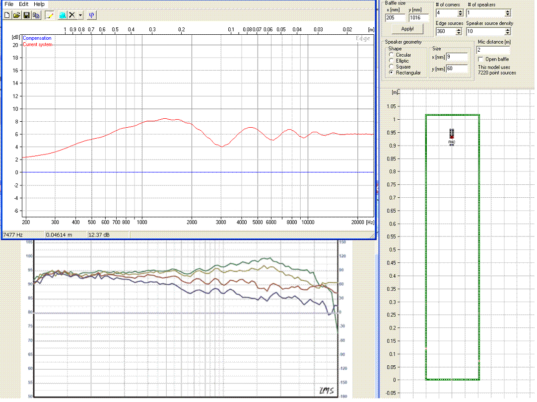

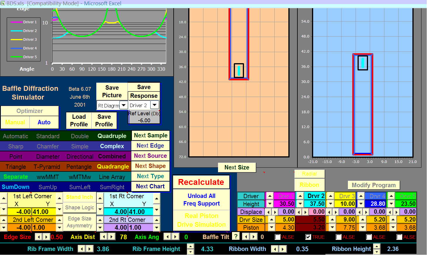

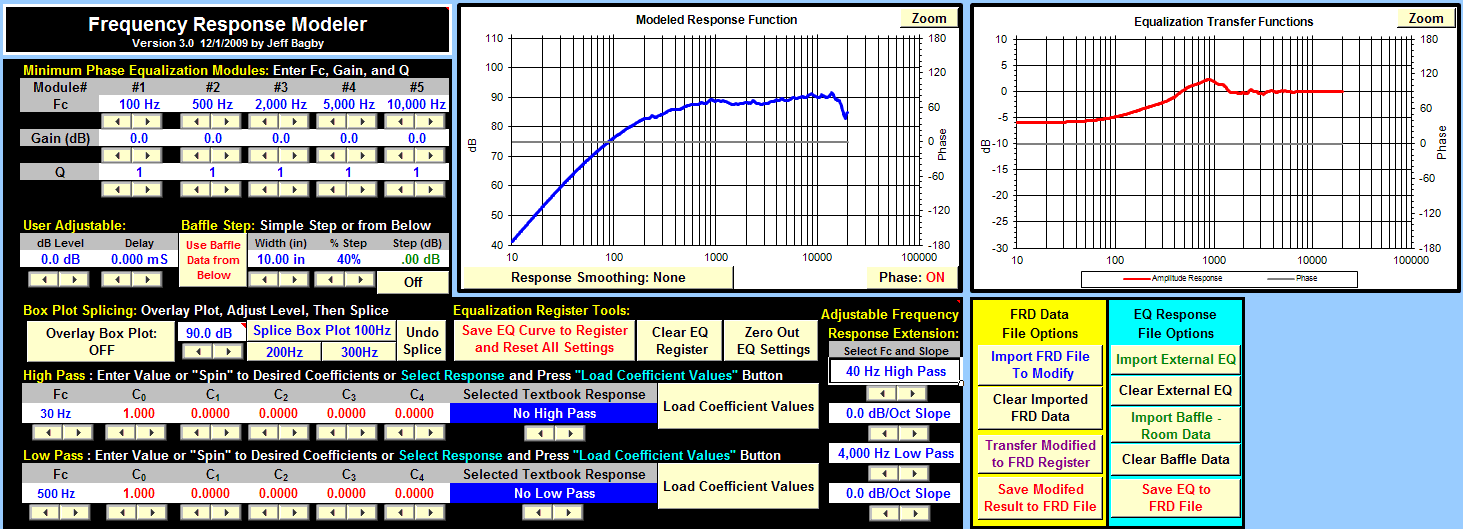

Ok let's see if I can't help you out with this idea and maybe help you out with the simulation process as well.
Start by tracing the tweeter and mid FR for the drivers you're interested in. Use this program: New automatic graph tracing program - Techtalk Speaker Building, Audio, Video Discussion Forum

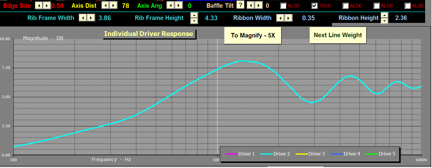

Then let's look at the cabinet diffraction affecting the tweeter. I'm going to use the Fountek CD3.5H as our example. Now because it's a ribbon, you need to use either the Edge or the Baffle Diffraction Simulator that I linked to previously (post 26). Image 1 is a screen capture using the Edge with the tweeter on a 8"x40" baffle, with the tweeter centered and about 36.5" up from the bottom. The problem here though is that the Edge only simulates sharp edges. So for comparison, let's look at the BDS sim in chart 2. Here I've set up the same conditions but with a 1/2" roundover on all the edges which looks about right for your speaker cabinet. Chart 3 shows you the results which are pretty much exactly the same as I got with the Edge demonstrating that a 1/2" roundover is actually kind of useless. You really need to go bigger than that to start having some significant effects at attenuating the the size of ripples.
So choose which program you want to try and then save the diffraction response as a frd file. In the case of the Edge, you'll need to trace it but you have to make sure that you set up the 6dB point as 0dB in the tracing graph (so the Edge's 0dB point will be -6dB). If you use BDS, you also have to save it with the "Ref Level (dB)" as -6dB.

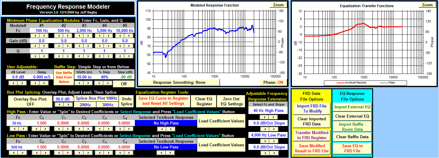

Now let's look at how the tweeter and baffle effects combine together. For this you'll have to use Response Modeler. Because Fountek's FR graph stops at about 1000Hz, the 1st thing you need to do is add in the LF rolloff. So import the traced FR and then use the "Adjustable Frequency Response Extension" section. See chart 4. Save the result, clear the data and then re-import the new FR. Import you saved diffraction response to the right and you're all set. Chart 5 shows the results. Remember that if you use this tweeter, the xo point should be a minimum of about 4500Hz so you are mostly concerned with what the result looks like above this frequency, which as you can see isn't too bad except for perhaps the little dip at about 6500Hz that gets accentuated. But dips are always more benign than peaks so I would call that perfectly acceptable.

Well jReave the bigger ribbons do perform very nicely, I saw those measurements myself a few days ago and was quite impressed.
I see you chose the better performing of the two ribbons Gornir measured for your comparison. While I agree that makes the most sense as we could consider the other one faulty who knows if that's actually the case. Above 4.5kHz the nice one is compelling but the SB dome will do that comfortably down much lower.

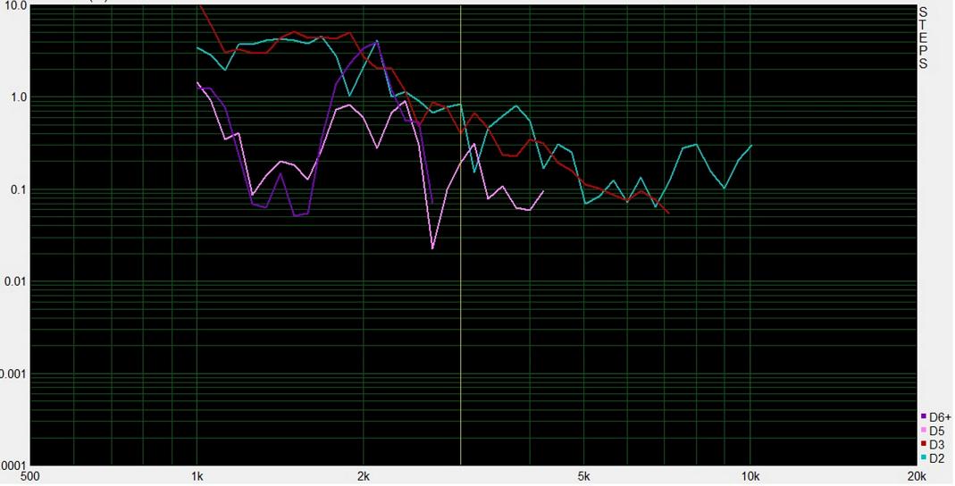

What bothers me is how absolutely terrible these fountek ribbons are at higher drive levels. Things really fall to bits especially with the increase in the higher order harmonics.

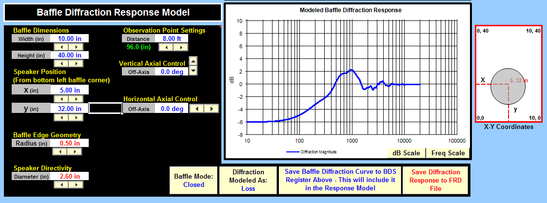

Now let's look at your mid choices and baffle diffraction.
Here you just have to use Response Modeler. Start down at the bottom this time and set up your cabinet parameters (chart 1). I used a driver height of 32" this time which I think fits well for a driver the size of the Scan 10F. So back up top and import the Scan's traced FR and then click on the "Use Baffle Data from Below" button. Chart 2 shows the results and what do you know? The baffle diffraction peak happens to fill in the response right at the 10F's 'elbow' which gives you a very smooth and relatively flat FR to work with.
Next do the same for the Vifa NE123-8. Change the driver height down in the Diffraction section to 31.5" because it's a bigger driver and change the piston diameter to about 3". Back up top, import the Vifa traced FR and the new baffle diffraction response. Chart 3 shows the results. Not quite as smooth this time. You get more of a wide peak centered at about 1000Hz now. Still for a 4500Hz xo, that's not anything egregious. It will probably just take an extra notch filter to smooth that out the way you need it.
Now try the same with the Satori 13P. It's not exactly a great combo with the ribbon tweeter for the reasons that 5th stated previously, but let's look at it anyways. First change the driver height again to about 31" and driver piston to 3.8". Import the 2 new files up top again and chart 4 is the result (ignore the response below 100Hz btw - I haven't spliced on the box response). Very good except for the little sort of plateau between about 700Hz and 1000Hz which may again need a notch filter to bring it down.
So in your case you can't really play around with cabinet widths or the size or type of baffle edge treatment to try to adjust the results. Really all you can do is vary the driver sizes and heights. But with your given cabinet, the clear winner here in terms of the easiest response to deal with looks to be the ScanSpeak 10F.
Let me know if you have trouble with any of that.

Higher level testing can be found here
It just worries me how much the higher orders rise with drive level. I am sure that lots of people are subjectively happy with their ribbons and I am certainly not going to knock anyone who wants to try, providing the compromises are accepted, understood and design decisions are made to minimise the downsides.

Below are Zaph's measured FR, HD and CSD:

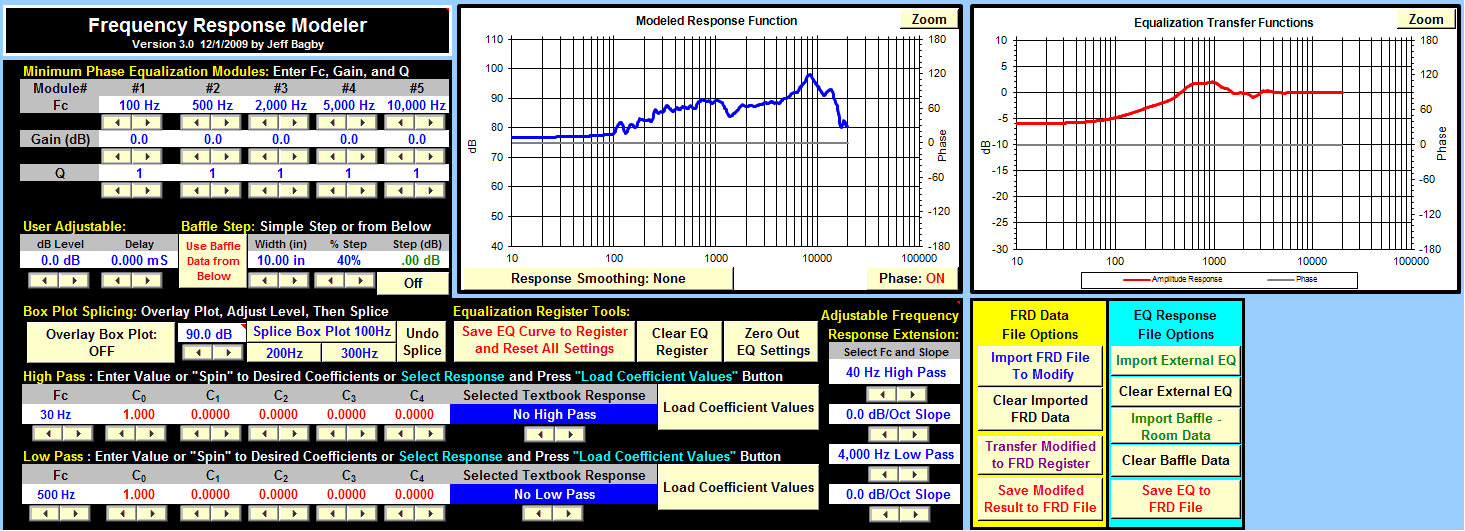

It might be helpful to post a capture of the diffraction section because your baffle diffraction FR doesn't look to be correct. You should be getting some peaking lower down in frequency for an 8" wide baffle before the response starts dropping off 6dB. Instead it's pretty much flat from about 1000Hz up. So that's basically having no effect on the driver in that frequency range. Thus, the rising response from 1000Hz up is just the original response of the driver.
For the mid responses, you should be getting the same or close to what I posted before. And because baffle diffraction is always a loss of 6dB in the lower end, yes you will always get a rising response from low to high compared with the original.
Something else to note is to be aware of the scale of FR graphs. It's pretty easy actually to change a very smooth looking FR into something much more mountainous just by changing the dB scale.
Hmm, maybe I pressed something I wasn't supposed to before :) I think it was the spice at 200hz option..
Does this look any better? I've noticed the the width of the cab is pretty fundamental to the baffle results. Changing that flattens things out..
Ok, let's go over how to set up the diffraction modeler.
Your cabinets are about 8" (205mm) wide probably about 40" tall. I'm not sure where you got 5.5" x 6.88" from.
x is the horizontal distance from the left cabinet edge to the center of the driver. If you center the driver on the cabinet, x will be 4". y is the vertical distance from the bottom edge to the center of the driver. The exact position of the driver is the one thing you can change in your design because you can't change your cabinet dimensions. I'll usually try to find the best position for the tweeter first because that will end up determining the height of the mid since you want them to be as close together as you can get them.
From the pictures you posted, it looks like your cabinets have about a 1/2" roundover on the edges. That's your baffle edge geometry. And the driver piston diameter is usually measured from peak to peak of the surround. If I don't have the driver in hand, I'll zoom up the pdf diagram to actual size and physically measure on my computer screen. The 13P for example has a an outside diameter of 132mm and a piston diameter of about 97mm or 3.8".
Maybe you want to try Jeff's Baffle Diffraction and Boundary Simulator first just to get comfortable with the program - it's the same thing that's in Response Modeler except you get to see a real example of the cabinet and driver you are modeling.

6.88 x 5.50 are the internal dimensions for Width and Height based on 5.6L volume. I was a bit confused by why i'm not being asked for the depth of the cab but assumes the modeler was working this out some how.
So are the baffle dimensions the external size of the whole cab? If so I still don't understand by the depth isn't being asked for... or are baffle cals the effect of the front of the cab on the response? If so, that makes more sense :)
Yes there is a 1/2" roundover on the edges.
