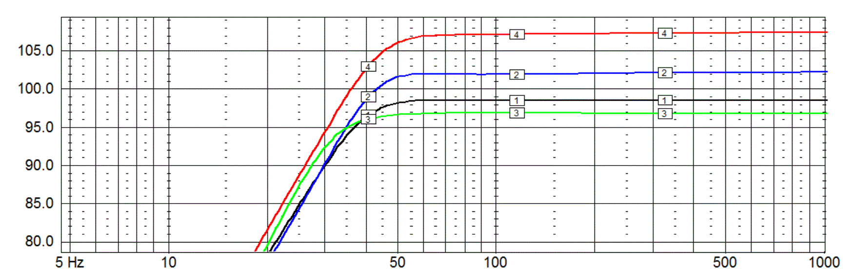

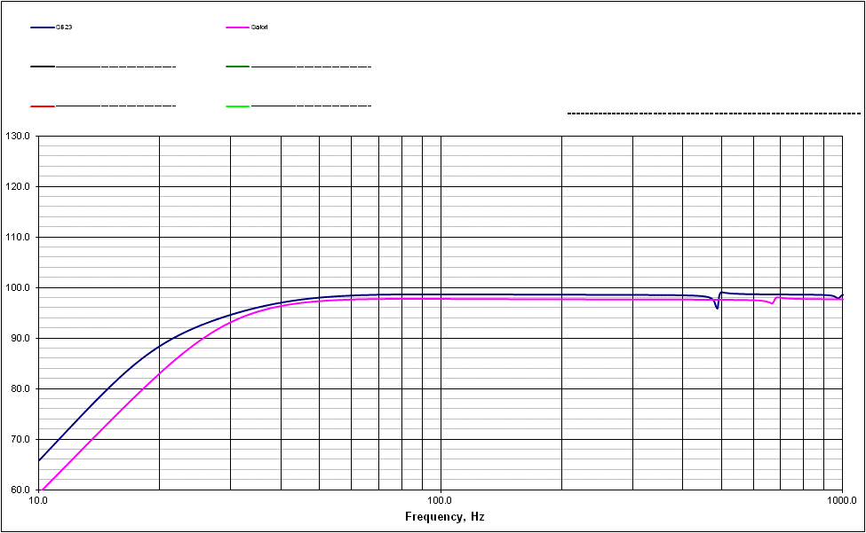

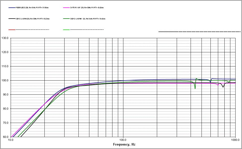

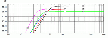

I get a similar FR with the RS225-8 vented in 25L to the SB23 using Unibox but couldn't tell you which one sounds better. I've noticed lately that Troels is very much in favor of higher mechanical Q woofers these days and the SB23 wins out in that respect. Still, level matching with whatever mid is chosen may be more important in the end.

Here is an image comparing various bass drivers for extension. I have corrected for the sensitivity differences so it's easier to see the difference in extension.
The black driver is the SEAS Excel 6.5" from falcon. The 4 ohm version from the back catalogue. Clearly this is not the best option where extension is required.
The blue driver is the MW16P Satori just for comparative purposes.
The green line is the interesting one though. This is the L16RN-SL from SEAS. This is going a step backwards from a 6.5" driver but its parameters indicated that it might give good bass extension and I wasn't wrong, it does, but at the cost of sensitivity and it also needs a large box.
The red curve is the 835025 HDS-164 AL from Peerless. This gives a very nice response imo, especially for the price.
The magenta curve is the 8" aluminium HDS from Peerless. I included this just for comparison. Here's what happens when you have a large box on your side. Similar in practise to the L16RN-SL as that also requires a large box. You get bass extension. The HDS needs a 60 litre box though whereas the L16 25 litres, which is doable.
Here are the responses with the sensitivity differences removed.
As you can see the 4 ohm back catalogue driver from SEAS storms ahead on voltage sensitivity, this isn't a surprise as it has the least extenstion.
The aluminium 6.5" Peerless, Satori and aluminium 8" Peerless all have the same sensitivity.
As can be seen the L16 has the least sensitivity but as mentioned very nice extension.

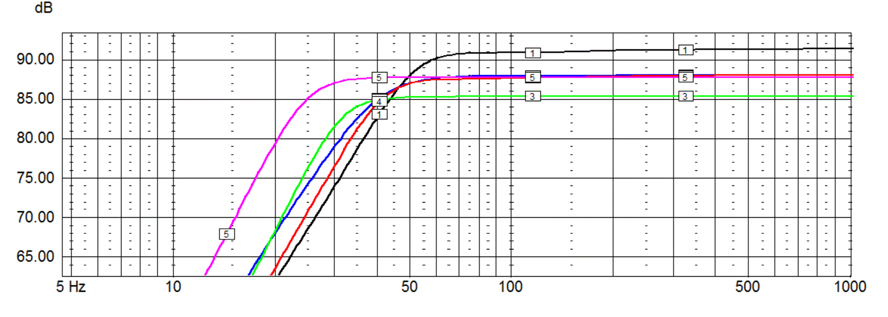

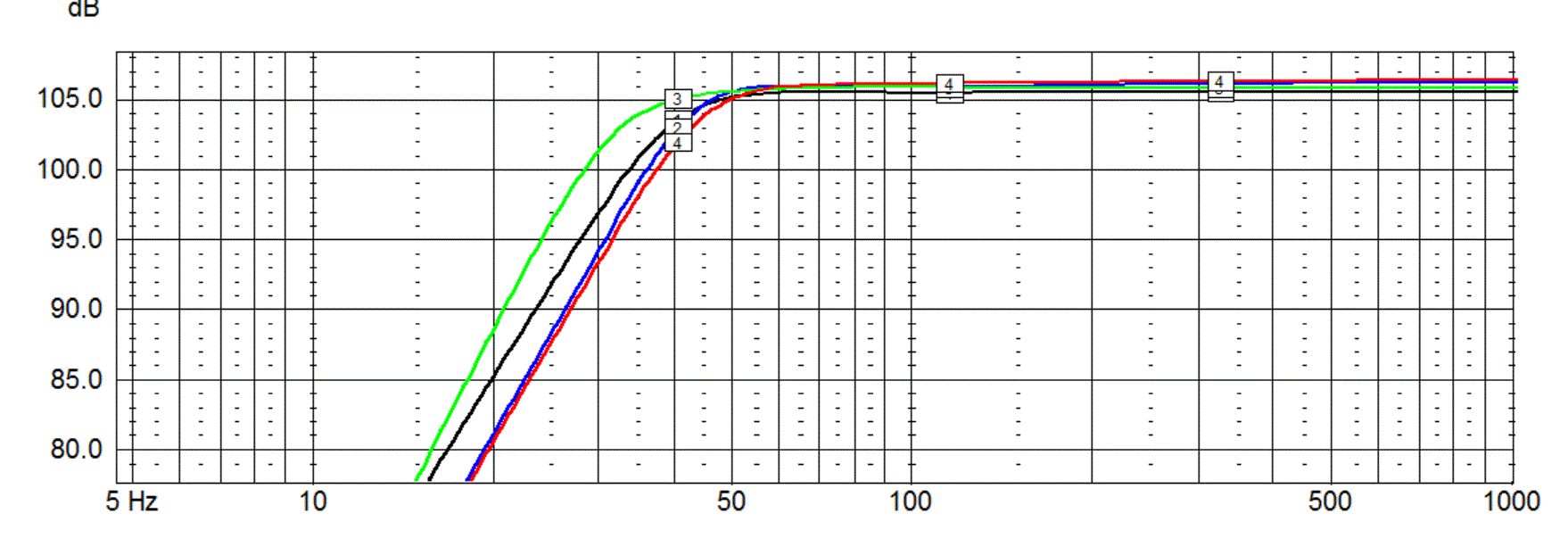

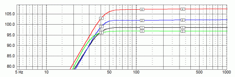

I've done a few more sims to give you another perspective on things.
I dropped the 8" driver and the 4 ohm SEAS as they really aren't suitable.
Here is a graph.
This is a maximum SPL graph showing how loud the different drivers will go before hitting xmax.
Black again is the Satori. As you can see its extension does come at a price it doesn't go particularly loud. This is also due to its lower surface area in relation to other 6-7" drivers.
Blue is the Peerless 6.5" alu cone. As you can see the slight loss in extension + greater surface area gives it quite a bit more in shear output capabilities.
Green is the L16RN-SL. It's maximum output is the lowest of the lot, but surprisingly, at least from my perspective, is that it only lags behind the Satori by about 1.5dB, whilst going a fair amount lower. If maximum SPL isn't your priority and bass extension is this might not be a bad choice.
The red line here is the interesting one. This is the L16RNX from SEAS. The brother to the L16RN-SL but with differently optimised parameters. This works in a box half the size of the L16RN-SL so I figured it would be interesting to see how it simnlated. Because the L16RNX fits into a box half the size I figured it would make sense to show you what two of them look like wired in parallel. These give you the best raw SPL capability in the available cabinet volume (that I've taken to be ~25 litres) but at the expense of amplifier power and little extension.

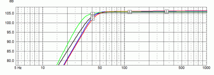

This is the same graph as above but with the SPLs brought in line so you can compare extension more easily.
As you can see the single L16RN-SL has the best extension. It requires a 25 litre cabinet tuned low. The cost is lower absolute maximum SPL. And according to Zaph's measurement it has very low distortion for a driver of its size and is actually more suited to absolute bass than the Satori is.
The other three have very similar f3s but the Satori has the shallower roll off. If we want to knit pick, the Satori has the best extension of the three, followed by the Peerless and then followed by the dual L16s.
I am personally a huge fan of dual opposed woofers. This means you put one woofer on the front of the cabinet and one on the back. One fires backwards and one forwards the forces cancel out and the cabinet remains inert. If you can mount the rear driver with its magnet facing out of the cabinet then you get even order distortion cancellation giving you even cleaner bass.
Given all of the options that I've looked at here so far my personal choice would be for the dual L16RNXs. Floor mounted, one driver on the front, one on the back, with the back one with its magnet facing out of the cabinet. You lose very little extension for more output potential and the benefits of push/pull dual opposed.
If you go this route then it will give you a loudspeaker with very high voltage sensitivity. We're talking 91-92dB sensitivity. This will need something sensitive as a midrange to match it. Floor mounting the woofer removes baffle step from the woofer section so you really do end up with 91-92dB sensitivity with no loss. If you want to go this dual opposed direction but want to use something like the MW13P as your midrange you will need to not floor mount the bass so as to soak up some of the extra sensitivity in baffle step compensation. One option for the midrange would be the 15m4624g from scanspeak as this also has high voltage sensitivity.
If you don't want to use the dual L16RNXs then my next choice would be for the 6" Peerless alu driver. Mainly because its extension is similar to the others but has more output potential than the Satori.
Then, like I said before, if you don't want this to go loud, which some don't. And you are really interested in getting the lowest bass out of this, then the L16RN-SL is good idea.

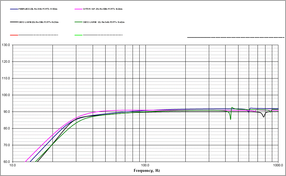

I did think that your box alignments didn't necessarily optimize all the drivers for their best responses when you take room gain into account though. For that spark, you are better off with a slightly more gentle LF roll-off than a sharp one. I've attached another graph using Unibox and using a 3rd party's measurement data (Zaph) for the Satori and the Seas L16RN-SL (no data available for the other 2). The SPL level is set so that xmax is not exceeded for material above 20Hz since your present plan is to use these for movies without a sub. All 4 drivers give you pretty much the same limit of about 90dB (more or less) @ 1m which for your listening habits would be fine.
Blue is the Peerless in 20L tuned to 31Hz.
Pink is the Satori in 25L tuned to 30Hz.
Black is the Seas L16RN in 20L tuned to 33Hz.
Green is the Seas L16RNX in 12L tuned to 34Hz.
The best response is still the Satori followed very closely by the Peerless. I don't actually like the Seas L16RN as much because it has the sharpest roll-off and that's even with the addition of heavy stuffing to try to smooth it out more. And the Seas L16RNX has the poorest LF response of the lot. Still not bad though and I think better than the L16RN.
Since you think you might be moving in a year or so and then might use a sub, I thought it worthwhile to also look at what each driver will do if you want to play them for music only without a sub (2nd chart). So here we're looking at how loud they will play with content above 40Hz before exceeding xmax and again they are all pretty much in the same 100dB @1m ballpark with the Peerless this time coming out on top.
More or less consistent with 5th's analysis but just a little bit different here and there.
