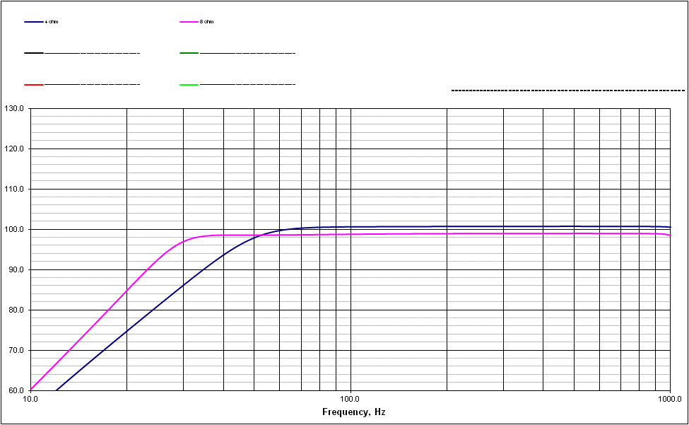

I would double check your sim for the Vifa NE180-4 because I don't get a lower F3 than with the Peerless. The NE180-8 however is comparable. My thoughts though are that if you are willing to pay for 2 of the NE's, you might as well take another step up in quality, albeit a small one, and go for just 1 of the ScanSpeak 18W Revelators or the Satori 16P-8.
Quality wise I would start at the Peerless, then the Vifa and then go up a little to the Satori and the Scan (just flip a coin I think between these 2). For bass and cabinet sizes, I've attached a comparison chart using Unibox. SPL levels are the limits @ 1m without exceeding xmax for content above 30Hz. The diagram looks a little blurry so,
Blue = Peerless 21L
Violet = Vifa Ne180-4 10L
Black = Vifa NE180-8 25L
Green = Scan 18W8531G 25L
Red = Satori 16P-8 25L

Just a quick question around F3. We have touched on that before but I think i'm missing something fundamental.
The MW16P-4 vs the MW16P-8, looking at the graphs the 4-ohm has better sensitivity low down vs the 8-ohm. I'm guessing you are calculating F3 by some other method? I used WinISD for the box modeling can I compare F3 using that? There is no obvious F3 data being displayed.
Sometimes it takes a couple of times reading things before they sink in, which is ok. Not everybody has a science background. I don't.
Pretty much all manufacturers' FR graphs are done on an infinite baffle, an open, large piece of wood without any kind of rear enclosure (Seas would be the primary exception). As such, neither the FR nor the sensitivity, not even the driver's Fs alone will tell you what the driver is going to do when you put it in a closed or vented box. It's the combination of the box and the driver's TS parameters that will determine the driver's F3, ie. the point at which the response drops 3dB down from its main, more or less level response, as well as F6 and F10 too which can sometimes be just as important to look at.
So, yes you do indeed have to model the box and driver together to know what the outcome is going to be. WinISD does that. So if you look again at the 2 Satori's infinite baffle FR's and compare them and then look below to see how they look in their "best" suggested vented alignments, you can see that the vented F3 of each driver doesn't correlate with either the original FR's, the driver sensitivity or the Fs of each driver (29Hz vs 30Hz).

F3, got it, that makes perfect sense and looking at WinISD, it does show F3 as a purple horizontal line in the gain plot window. Also great info on how manufacturers' FR graphs are done!!
