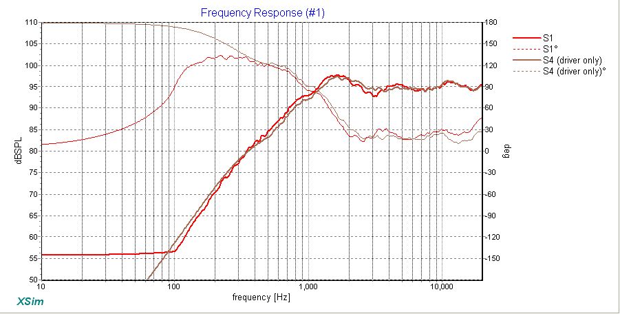

First about the Satori. Both the 5" and 6.5" drivers have a small dip in their midrange response. I have not heard a single person who has listened to them make a complaint about it. But the decision rests with you.

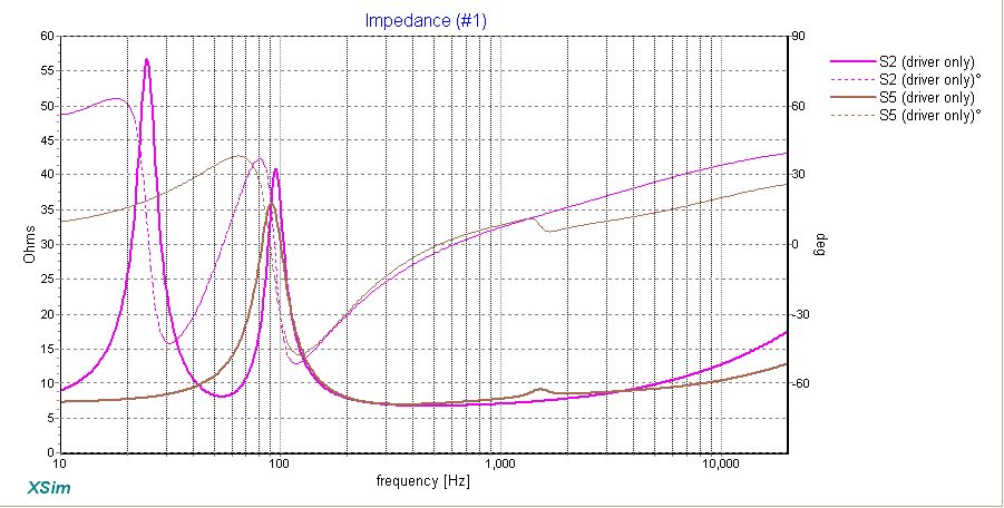

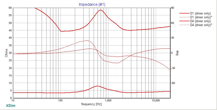

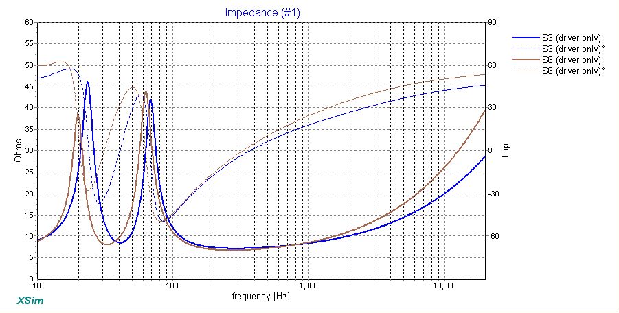

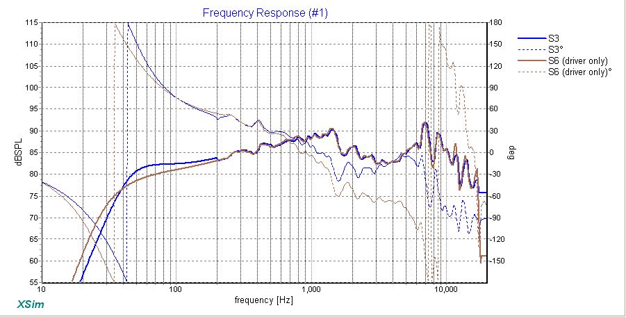

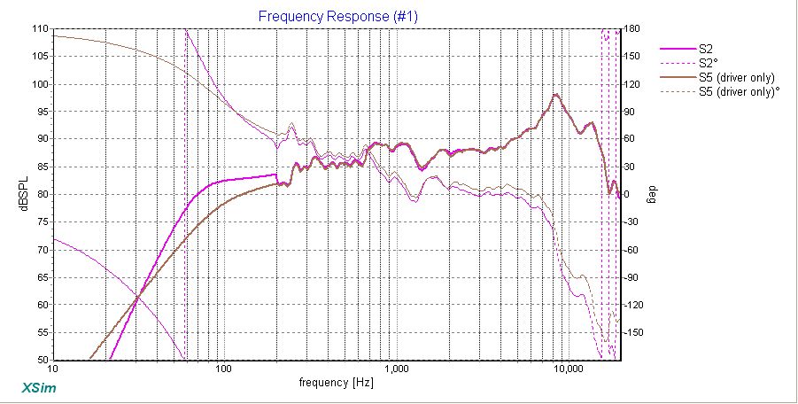

Attached below are comparisons between my files and yours (my results are all in brown - oops except for tweeter Z, both are red):
1 & 2) Tweeter FR and Z
3 & 4) Mid FR and Z
5 & 6) Woofer FR and Z
Tweeter FR: Almost exactly the same except mine is a little smoother and on the low end, my response has been extended. I put the tweeter 33" high and 4.5" from the left side. To 'tail' your response, in Response modeler go to the Adjustable Frequency Response Extension section. Choose around a 800-1000Hz high pass and about a 12dB/octave slope. Save the response and return the last cell to 0dB/octave. Now import that FR back in, splice and add in your diffraction response.
Tweeter Z: It looks like you set your tracing limits incorrectly and that you stopped at 100Hz. Trace the whole thing and just double check your limits.
Mid FR: If you want to use a vented enclosure for the mid, go ahead, but I would go sealed. I modeled it in 4L. Looks like I chose to splice it at just a little lower spl as well. Other than that, they match perfectly.
Mid Z: The low end will obviously be different since we modeled in different types of boxes. However, the upper portion should be the same and is not. And this is not explained I don't think in the tutorials. Here's what you need to do (and you should do the same thing for the woofer as well):
- trace the manufacturer's Z response (this time about 100Hz and up is fine)
- in Response Modeler, model the in-box z as before
- now import the zma file you just traced with the "Import ZMA File To Modify" button and turn the "Overlay Imported zma" button to 'ON'
- from about 100Hz and up, you will now try to align the modeled Z with your imported Z by playing with the Le Expon. and Le Coeff arrows. If that doesn't do the job then you'll need to also use the equalization modules above those. All the variables are user changeable. Let me know if you don't know what Q means in this context or just play with them and you may be able to figure it out.
Woofer FR: Looks like our box modeling was different. I used 20L Fb=33Hz. Again, I think I chose to splice a tiny bit lower in spl. The rest of the FR looks right but I would expect phase to therefore match in that range as well but it does not. Let's see what happens on the next go around.
Woofer Z: Box modeling and Z modifying differences. See above.
Let's see where that gets you on the next try.

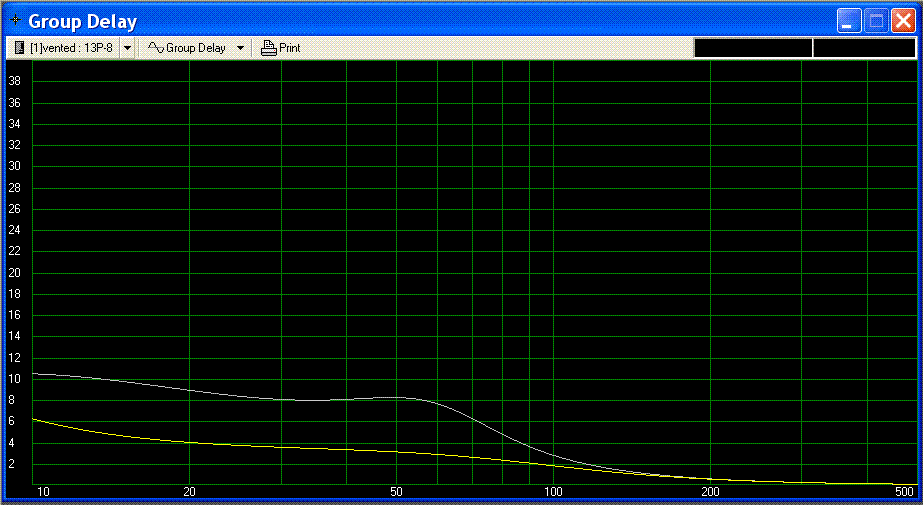

Thank you for such a detailed analysis. Before I go back and re-run things I have a question around the Mid and Sealed Vs Ported. I picked ported purely based on the EBP and it falling well into the ported range. I can see that when I change the Mid to sealed it has a big effect on the group delay. So I guess my question is: should the group delay between the woofer and the mid be on a par or close or doesn't it matter? Based on WinISD, there would be a 10ms avg difference in delay if the Mid was sealed. Where as if its ported, the group delay is much closer.
Actually as a general rule, a vented design has more group delay than a sealed design but I've attached what WinISD shows for the Satori. Grey is vented and yellow is sealed, so the general rule applies here. Note however at what frequencies the differences happen anyways and then ask yourself when used as a mid in a 3-way, what frequencies end up not being used?
Also, the transient response is generally better in a sealed vs vented design. I'd probably go with a Q somewhere around .5 to .6 as that gives you some extra volume to add stuffing to better absorb the rear wave. Or to perhaps employ a physical strategy something like shown here (sans the vent) - http://www.humblehomemadehifi.com/download/Humble%20Homemade%20Hifi_Concertino.pdf. And as an aside, I would also consider doubling up the side and top walls to the mid enclosure too as I believe you have the extra volume available to play with and the added mass will make it harder to excite the mid chamber resonances.
