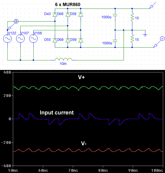

Forgot the grid neutral in the previous post (connects to the midpoint of the SMPS' inputs). The zero sequence choke is optional. Thanks.
However, please note that the functionality of this circuit is at the expense of input current THD and power factor, in view of the OP's choice to disregard the grid-side power quality.

...the method...does not reach 560V like the 3-phase (6 diode) rectifier...
Yes, the 560 V (or ~600 V in Australia) is a bit of a worry.

Dave Zan said:the ~600 V ...is a bit of a worry...
Not if you choose to split the 600V into 2x300V and feed two 300V SMPSs (post #80, 81). With the zero-sequence choke in place, the resulting ripple is reduced further, even when small capacitors (<1000uF) are used.

Direct rectified 3ph Oz mains would need something like post #81 to get bulk DCV down to a manageable level, but still requires any subsequent smps to be rated for mains tolerance and for safety isolation - have you identified anything suitable?
Yes, thanks, some version of that looks quite feasible.
