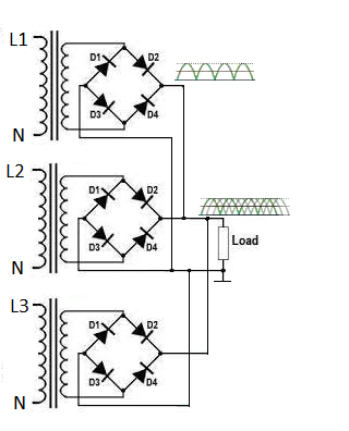

If you rectify each phase with his own bridge relative to neutral and connect the output of the 3 bridges in parallel you will obtain 330v almost DC then you can feed any conventional 230v AC switching PSU without any need of PFC...
If you rectify each phase...and connect the output...
It's easy to half wave rectify each phase relative to neutral and connect in parallel.
But if you add a -ve half to full wave rectify then there is + and - 330 V for a total of ~660 V.
So either I misunderstand your proposal or one of us is mistaken, could you show a circuit schematic?

If you use 3 full wave bridges.
Each bridge input ~ ~ is connected to one phase and the other input to the neutral. Then you get 330V at the output of each bridge.
You can then connect the outputs of the bridge in parallel 3 + together and 3 - together and still get 330v nearly DC because of the 3 phase shift.

Crudely drawn, but I think this is what marconi118 means.
Thank you for the picture, but there's a problem (not yours!).
The proposed SMPS is driven directly off the mains line.
There are no input transformers and this alters the situation.
I suspect he has in mind a circuit just as you have drawn but hasn't considered what happens when it's driven by sources that are not isolated.
I could be mistaken of course.
The OP appears to be looking for transformerless rectification, please see post #78.

sorry still nothing to draw on hand.
Yes like the picture above but without transformers
indeed all 3 bridges have one ~ leg connected together to the neutral
Aren't the diodes isolating the 3 source lines?
no need for galvanic isolation to feed an SMPS the high transformer is doing this.
I mean the diodes will avoid to short circuit the 3 lines together
