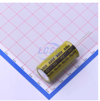

Please show an example of a "filter" capacitor.
As far as I'm concerned, a "filter" capacitor is a capacitor that is being used in a filter. There is no such thing as a "filter capacitor" as far as product catagories on sites like Mouser go, for instance.

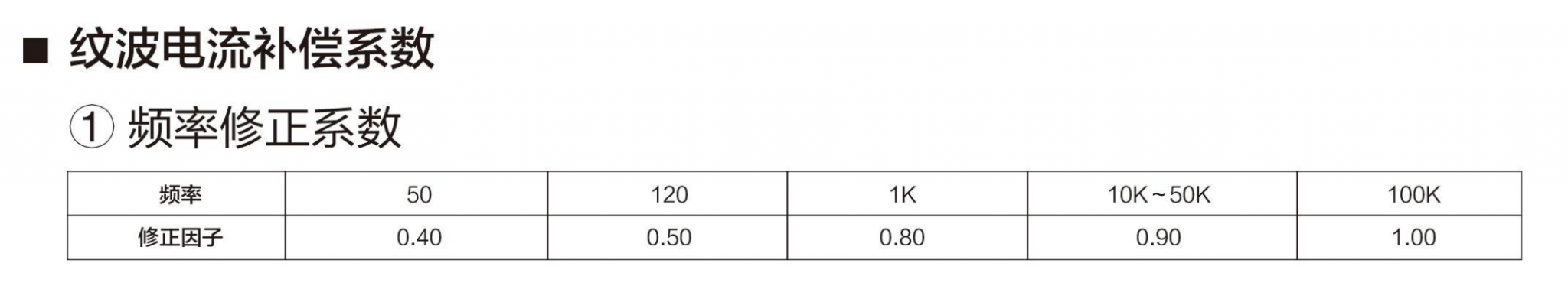

Here is an example of a capacitor I use as a filter capacitor; It is rated for 1.15A of ripple @ 100 kHz and must be derated to 40% of that for 50 Hz operation. It is a 100uF/500V long life 105°C capacitor.
I don't read Chinese, but it's obvious to me what this means:
https://datasheet.lcsc.com/lcsc/1912111437_Ymin-LKMJ3552H101MF_C443409.pdf

At lower frequencies the ESR is low and higher frequencies the ESR is higher. This makes a ripple current specified at 100 Khz to be derated at lower frequency to maintain power lost or maintain temperature (Power losses are to the Square of current times ESR, Losses higher at lower frequency)
The ripple currents are specified at 20 deg C and capacitor life is shortened at higher temperatures even for the 105 deg C types.
Two 5,000 mfd instead of one 10,000 mfd capacitor gets longer life.
Higher voltage capacitors (larger size and easier heat dissipation) will have their operating temperature lowered if used in this application.
Typical number of hours of standard capacitor at 80-90 deg C is about 2000 hours.
