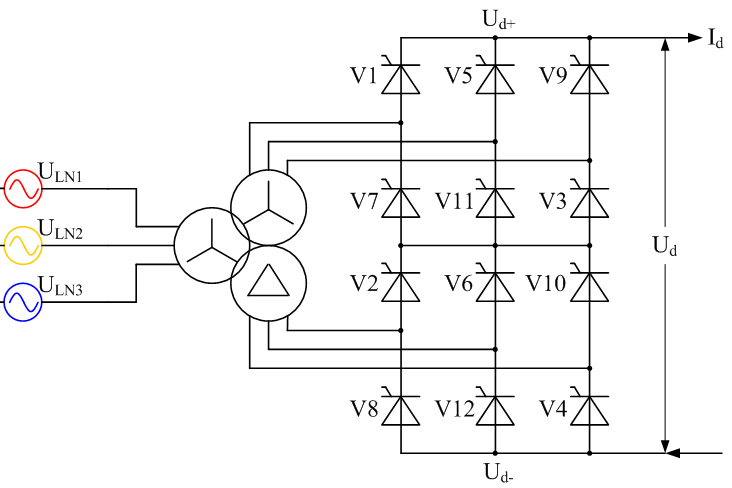

...this seems like it would work....
The Y and Y and Delta symbols are transformers. (Or alternators, but he's not doing that.)
You will have Y or Delta direct from the power company, but not both as in that drawing unless you supply transformers.

No fun having 400V ...I still would consider three 230V/230V transformers for galvanic isolation and safety.
Well, the best way to understand a 3-phase power system is to not think of it as three separate single-phase systems.

Using three small transformers is a cheap way to get galvanic isolation. Three phase transformers are usually huge and made for high power systems. Not arguing for this other than as a safety measure. If you think you are safe without, go on (if professionally done, nothing to worry; but makes me wonder about the questions in this thread).
+ For fuses... I still would consider three 230V/230V transformers...
Three 230 V transformers is one option but it would be simple mains frequency step down transformers + rectifier + capacitor supply.
If I do choose a SMPS then it will be an LLC with step down transformer which will also provide isolation.
To repeat my earlier comments, I see little point in mains frequency transformers ahead of a SMPS that already has a transformer.

Dave Zan said:Does the difference between HB and FB actually have practical implications for the transformer?
A FB SMPS transformer needs to be designed for double flux swing (Bsat) and double voltage, directly influencing window area, core area, copper, insulation, creepage (safety), EMI and so on.

Dave Zan said:FB transformer has twice the primary turns of a HB.
My point was that it would have to be designed that way and in doing so, the resulting turns may not fit, often needing the next core/window size, a different number of turns and increased creepages and clearances. Any reduction in switching frequency (in response to the double voltage) would need a bigger core as well.

The flux being proportional to the voltage, would be double for a full-bridge. But since you assumed that the turns (the constant of proportionality) be doubled as well, your understanding appears to be just fine.
However, it's worth recollecting that for an integrated magnetics (minimal part count) implementation, the leakage and magnetisation inductances need to be very close to the expected (design) values, making adjustments to the transformer a very tricky affair in case of resonant converters.
