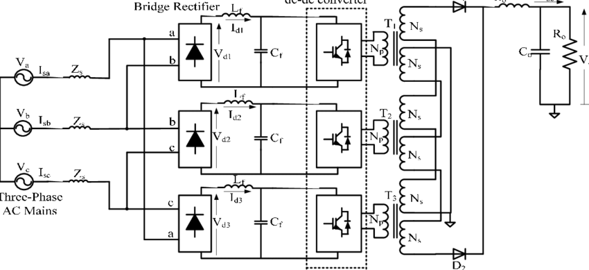

Experience/profession. High power 3 phase rectifiers and high power 3 phase inverters.
There will be a few semiconductors chopping the rectified voltage. That is why they are called switchers 🙂

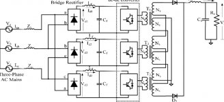

A 12 kW 3 phase SMPS from the web. Please note the filter capacitors and the current limiting/filtering coils.

I have used three-phase supplies at work and am of the opinion that it's a good option especially for rectification, be it boost pfc type or regular. It's just miles ahead of the single phase rectifier in terms of ripple voltage. However, please note that both PFC and regular types still need filter capacitor. The 12-pulse rectifier is also a wise option that provides good input power factor without the need for complicated modulation schemes or an active front end PFC.
A 12 kW 3 phase SMPS from the web. Please note the filter capacitors...
My comment specifically mentioned the reduction and/or elimination of "bulk" capacitors not filter capacitors.
In any case a random picture from the 'net shows only what someone has done, not that other approaches won't work, quite possibly better.

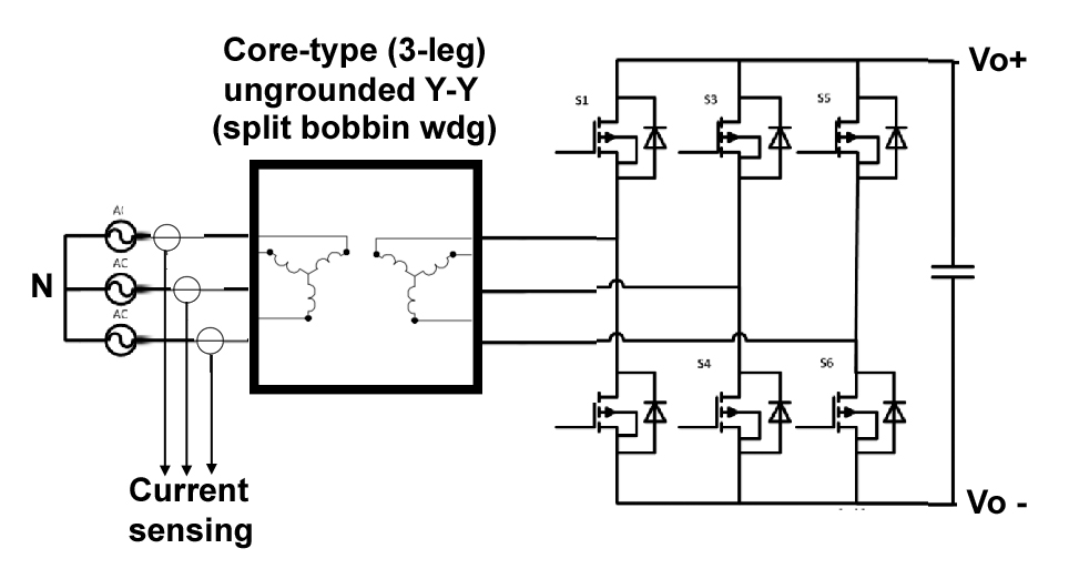

You can look up Dr Cuk's stuff at TeslaCo. - he has patents for the elimination of bulk capacitors even in one phase systems.
Really clever work, as one would expect from a CalTech professor, and a famous one at that.

Hi I tried to find the stuff without bulk/filter capacitors (I did understand you right) by Slobodan Cuk but haven't found anything except interesting high efficiency inventions/designs and eliminating ferrite cores.

Hi I tried to find the stuff without bulk/filter capacitors...
"Therefore, there is no
conceptual reason, why the constant
instantaneous three-phase input power
could not be converted directly into a
constant DC output power. The obvious
added advantage is that such AC/DC
conversion will completely eliminate need
for energy storage"
Quoted from https://www.power-mag.com/pdf/issuearchive/46.pdf, where he explains how the concept is implemented in practice.

Well I read it and it has some demands and still has a bulk capacitor in the (conceptual) schematic. It gave the impression it all is meant for solar and electric vehicle chargers where the focus is on efficiency at relatively constant high power. Maybe 400 V DC bus voltage is not that OK for a power amplifier. A tube amplifier would love it but then the load is not in Amperes 🙂 Maybe it would make matters more clear if you could tell what kind of amplifier and its supply voltages you are after. Symmetric, asymmetric etc.

I need about +-100 V so I see several practical options.
First is kind of obvious, a 3 phase rectifier to power the usual SMPS DC drive circuitry for a hi-frequency transformer for step down and isolation.
Needs only small filter capacitor on output.
May not even need PFC, dependent on the transformer driver.
Second, the Cuk rectifierless circuit, very small resonant capacitors on the mains side.
Third is not SMPS, just simple transformer, rectifier and capacitor.
Fourth is delta + Y transformer and 12 pulse rectifier and capacitor.
Lower ripple for a particular capacitance than third option.
