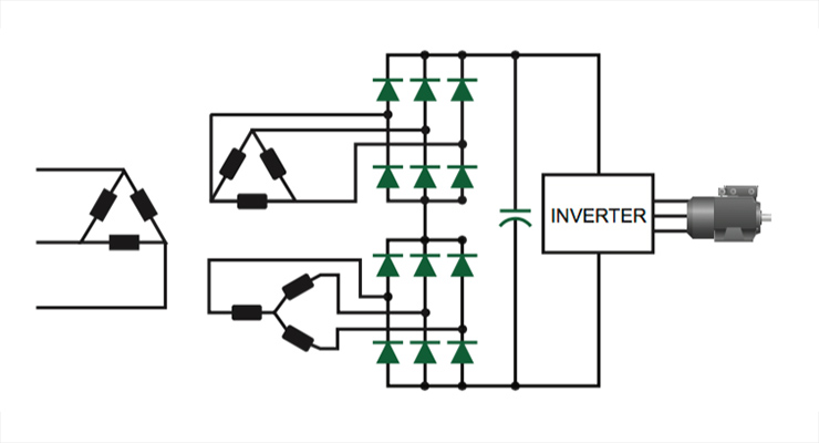

Why not just use two simple 3ph uncontrolled full-bridge 100VDC supplies connected in series for the +/-100V common supply? You could get 2x the same 3ph transformer made, or a single transformer with two sets of secondaries. Or a complementary pair of transformers with delta and wye secondaries, or a single transformer with separate delta and wye secondaries, so that the mains enjoys 12 pulse lower harmonics.A simple 3 phase rectifier followed by a one phase SM transformer would be fine, if I can find one commercially.
I can't see any benefit (and only a lot of complexity or cost) in then adding a smps regulator or some variation of smps' to then get your +/-100V common supply.
Just visit your local transformer manufacturer and get a quote for a small 3ph transformer, with earth screens and impreg to keep noise down. At least that way you get the dc supply voltage you want in the simplest manner, and can enjoy your perceived benefit of reduced (or no) e-cap filtering.
Very sensible advice above, I must say. It's easier to do the series 12-pulse with 1:√3 star-delta windings, without getting into all the high voltage, high frequency mess. All one needs is to get the transformer kVA and turns ratio(s) correctly. Further, there's no need for thyristors, and regular bridge modules would do very well (if you don't find 3ph ones, just use 4xKBPC3510).trobbins said:Why not just use two simple 3ph uncontrolled full-bridge 100VDC supplies connected in series for the +/-100V common supply?
