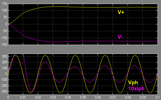

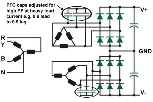

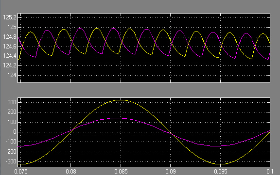

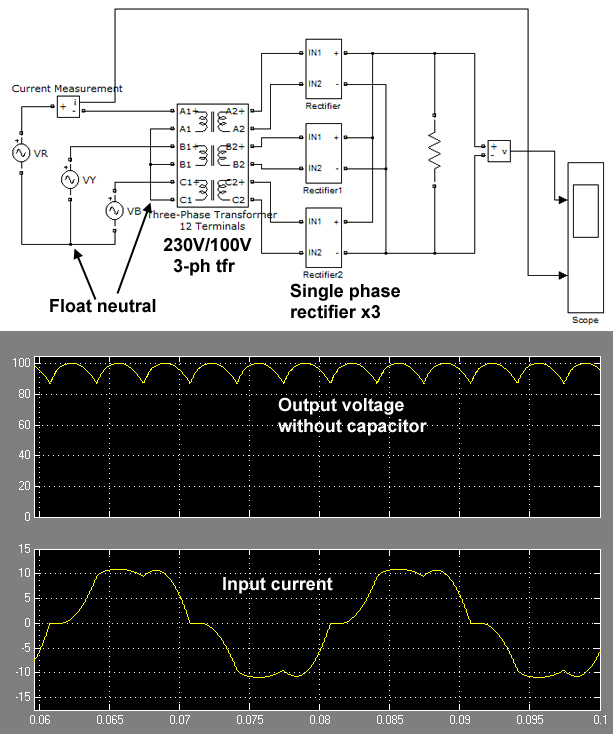

Dave Zan said:..it doesn't really help with common mode noise on the rails.
The CM voltage on the rails depends on the value of the filter capacitor. Attached is a closer shot of the rails from the earlier simulation (V- inverted) that clearly shows a CM voltage less than 1Vpp.
Besides, what do think about a pair of simple, decent performance post-regulators for all the 25 amplifiers together? With no input pf regulations to worry about, they could give you all what you want. Further, you could even build them yourself !
Dave Zan said:...they can look after themselves...
If you don't really care about input pf, you could use a 3-phase transformer in "neither delta nor star configuration" i.e. a transformer with open-end output, followed by single-phase rectifiers in each phase whose outputs are then tied together for ripple reduction (see circuit and simulation attached). For a dual supply, you could simply use a transformer with centre-tapped secondaries, whose centre-tap (also tied) would then be your power ground.
