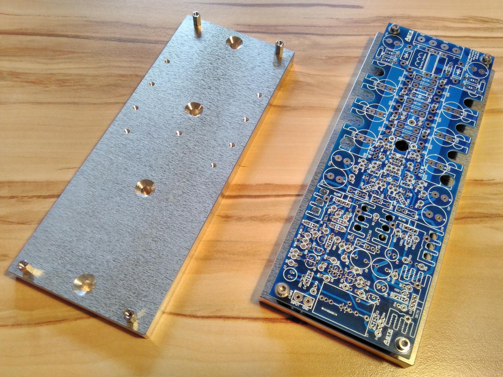

Nice!
Where you got this and what is the price?
Have a look at the url: https://www.schaeffer-ag.de/en
Unfortunately the price is rather high ... but the quality is exceptional.
BR, Toni
P.S.: If someone needs the resulting "fps" file for uploading to the manufacturer, send me a PM.
