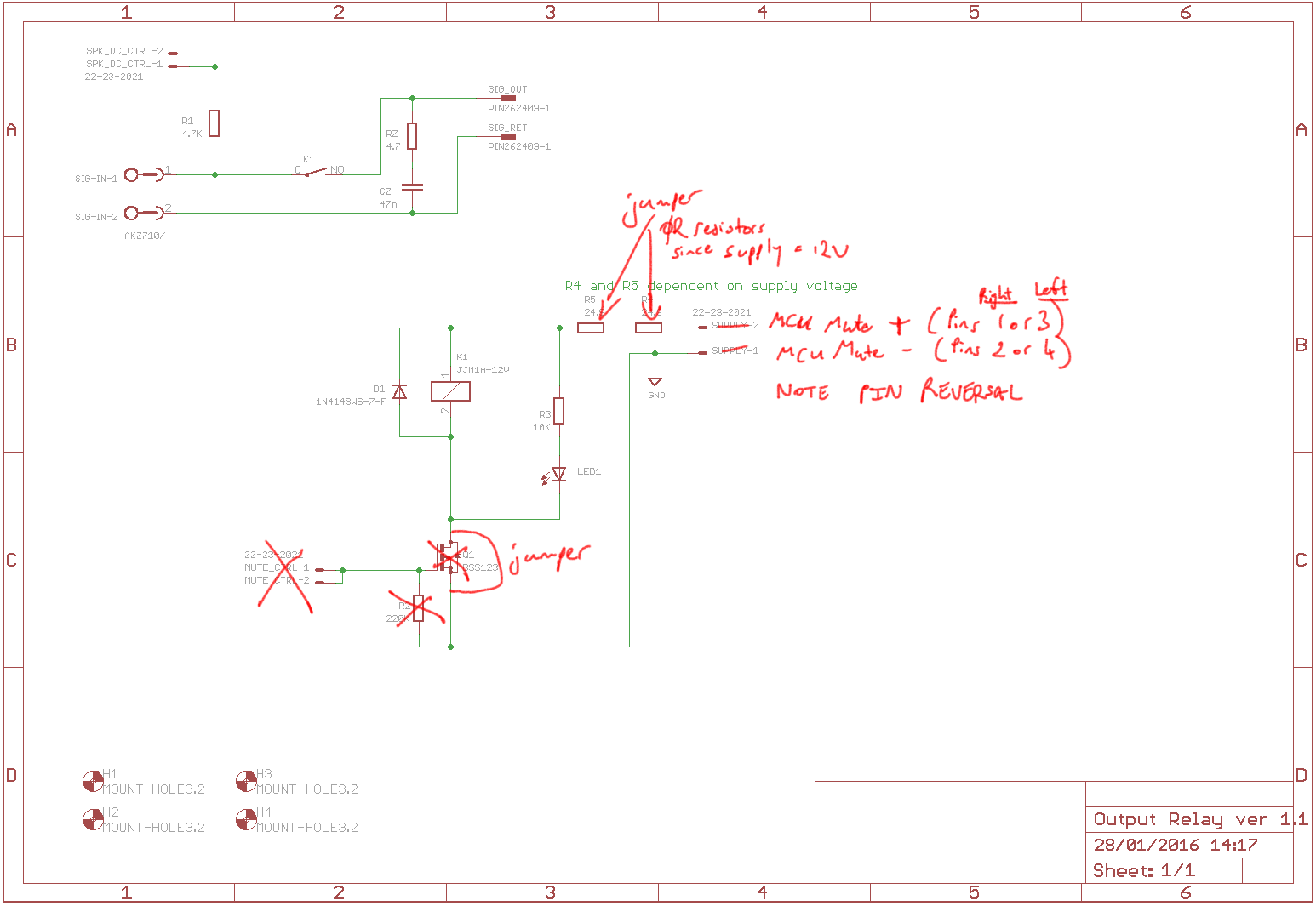

The action of the output relay control is changed a little and requires a modest change on the output relay board from before. In Toni's earlier circuit the MCU controlled a transistor on the output relay board on the low side of the relay to allow current to flow through it while the output relay was supplied 12V from some other PSU (the mains supply to which was controlled by one of the relays on the in-rush board). With this version, 12V (and -12V) is supplied to the MCU and the MCU controls the onward supply to the output relay. So the output board can be simplified a little.
See attached
Would not do this. First power is attached to amplifier and preamplifier and with a configurable delay the output speaker relay will activate. The amplifier needs some time to settle up. DC offset ...See attached
BR, Toni
The MCU only supplies power to the output relay (where I wrote MCU Mute +-) after this configurable delay that you have built into the software. (Pic pin 16 goes high after the delay and only then is power fed to output relay board.) Effectively Q1 in the schematic in #1881 has been shifted to the SMD MCU.
The MCU only supplies power to the output relay ...
Sorry - now I see the difference - you meant your extra speaker relay board - this of course can be modified as you have shown.
BR, Toni

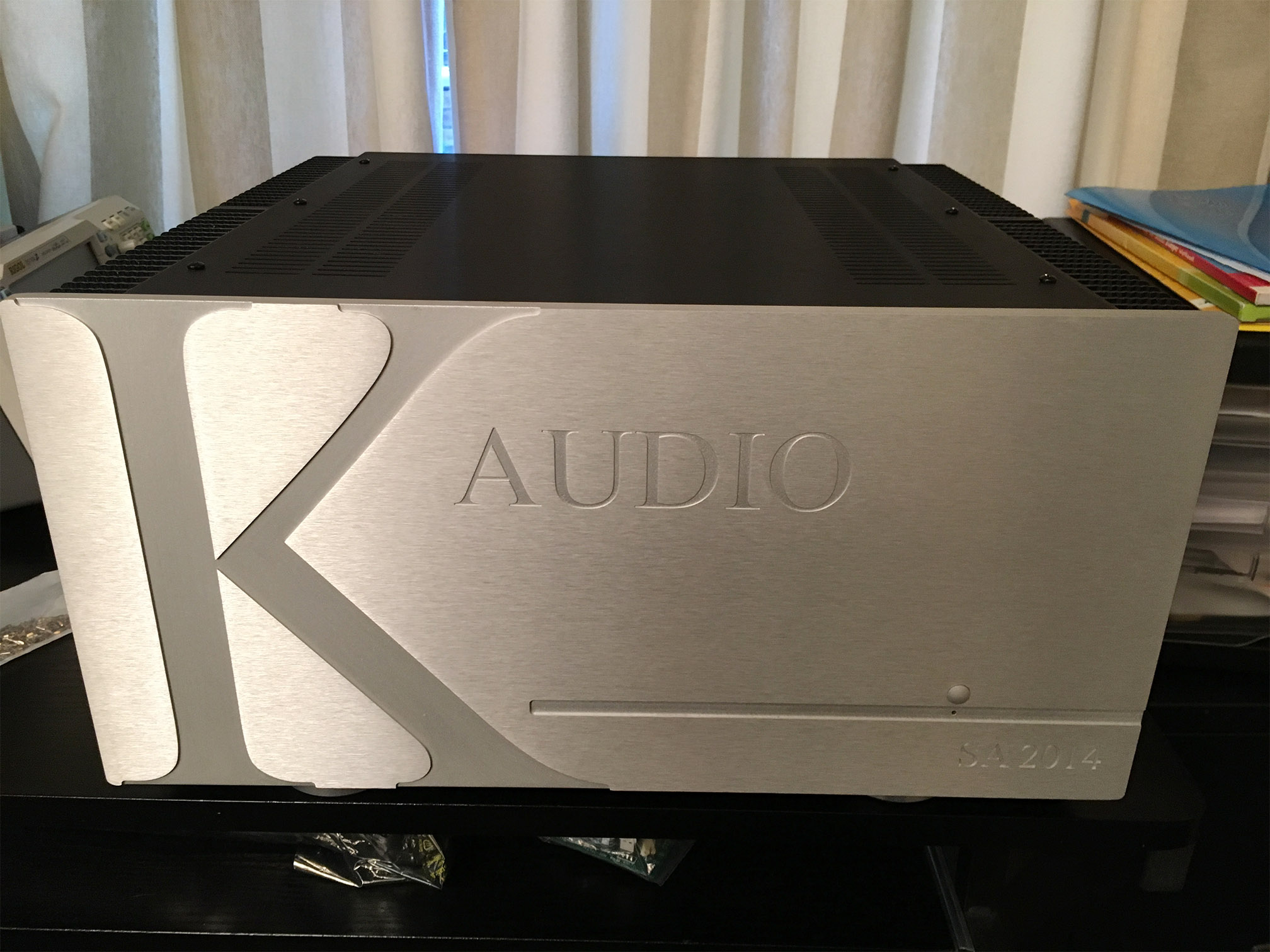

There are several amps now discussed in this thread. The first, and the one I have built, has been rated by Toni at 200W into 8R or 400W into 4R.
Me, if I am going to build something for my main speakers I want something with plenty of reserve. Speaker efficiency? Distance to listening position/size of room? Heavy transients in material recorded with very good dynamic range? I consider the c750W per channel likes of the SAE 2HP (peak or RMS - not sure for that one) "monster capability", but not 200W rms.
I hate giving subjective opinions on audio gear. The cr*p one reads in reviews is baffling to me. Bigger soundstage? Greater separation? Blah blah. Maybe my hearing is really bad, I've only had good gear or I need to do a course in the dark art of audio gear review to better express what I hear, but I can say that Toni's SA2014 is an incredibly enjoyable amp. It betters my Krell FPB 200. The best I can say is that it performs effortlessly and with a greater sense of "cleanliness" than the Krell.
At the moment my gear is in what I consider to be a very small room - but that's just because I live in London. It is circa 4.9m x 4.1m and its dimensions and construction (Victorian brick 'n mortar etc) are hardly ideal. (A couple of RPG Modex plates help but ideally I would have another pair. I've tossed in some Bad panels as well but the Modex plates are the bee's knees for bass absorption.) So it takes a lot less power than would a very large room. But I am also running Dirac Live which has a considerable amount of attenuation.
I've given this amp a really good thrashing now with a lot of "very neighbour-impolite volume levels and transient packed content". I like it a lot. Even at this time of year I don't miss my Krell heater.
(My speakers are Egglestonworks Andra III. DACs are Theta Digital Xtreme D3 in a Casablanca IV.)

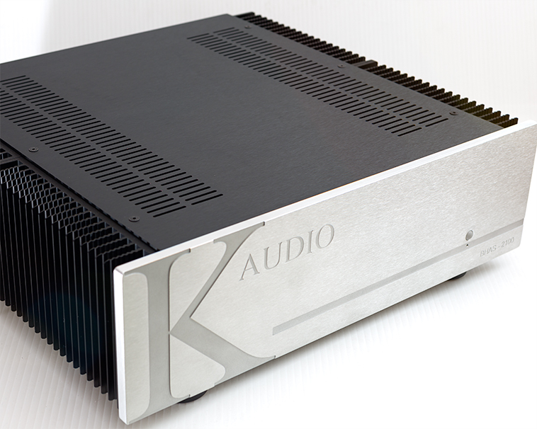

SGK, congratulations to your very nice built SA amp. You have chosen an excellent design! Toni´s documents and boards make such substantial projects be a very joyful experience.
I am very lucky - now and then I can hear the original at Toni´s place. Simply a stunning amp.

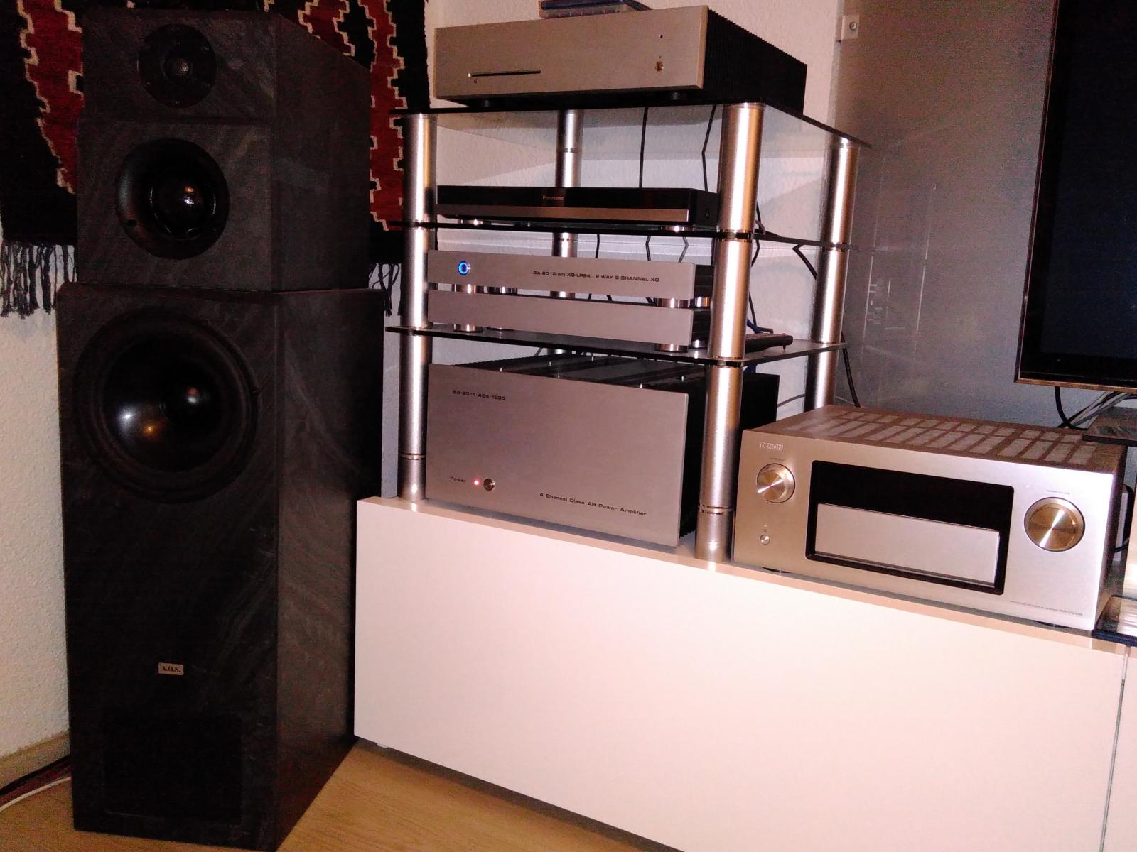

Here a quick overview of my listening equipment from top to bottom and left to right:
BTW: Your speakers are really very good ones!
- DIY Speaker "M50 TL BE" based on ScanSpeak and ATC chassis in a very heavy stone case (build using brazilian slate) - 150kg per speaker
- DIY Audio/Video server running Linux (case made by my friend using my own CNC machine)
- Panasonic Blu-Ray player BDT500 (with audiophile Burrbrown DAC's; I'm using it as DAC reference and of course viewing HD-Video)
- DIY Analog active crossover Linkwitz Riley 24dB (crossover point at 380Hz)
- DIY power conditioner to block DC on AC mains
- DIY SA2014 - 4 Channel amplifier (46kg)
- AVR-X7200W - Denon
Absolutely amazing builds!
