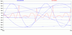

All changes with BC caps and so on does not change the stairs on the rising/falling edge of square root signal. Only stronger compensation smoothes them. Amp is pretty stable and THD20k is very low about 0.003%. No overshoot. No ringing. No spurios oscillation.
Btw: TPC does not have this problem - see attached picture
BR, Toni

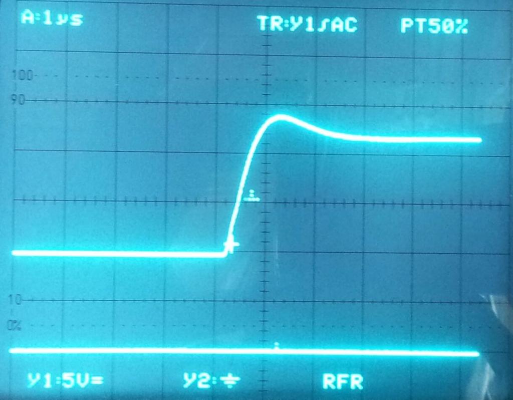

I think it is no good idea to measure distortion after output filter zobel / coil during full load. There we would measure added distortion introduced by output coil and load resistors which reacts more like coils. Or am I totally wrong?
Now H2 and H3 compared to their respective residual:
Input from VP7723D: H2 -88/89 dB, H3 -88/89 dB
Output before coil/zobel: H2 -88/89 dB, H3 -88/89 dB
Can't measure a significant difference. Maybe the THD analyzer measures now mostly its own noise ..
So for further optimizing I would need better instruments. Maybe there is one out there who can help? Simulation shows we can get THD20k@200W@8R below 0.001%.

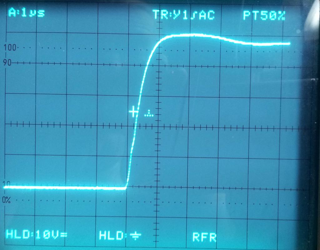

Wow - there is really enormous potential in this simple circuit.
Attached a rising edge of a 10kHz square. ~ 80-90V slew rate.
BR, Toni

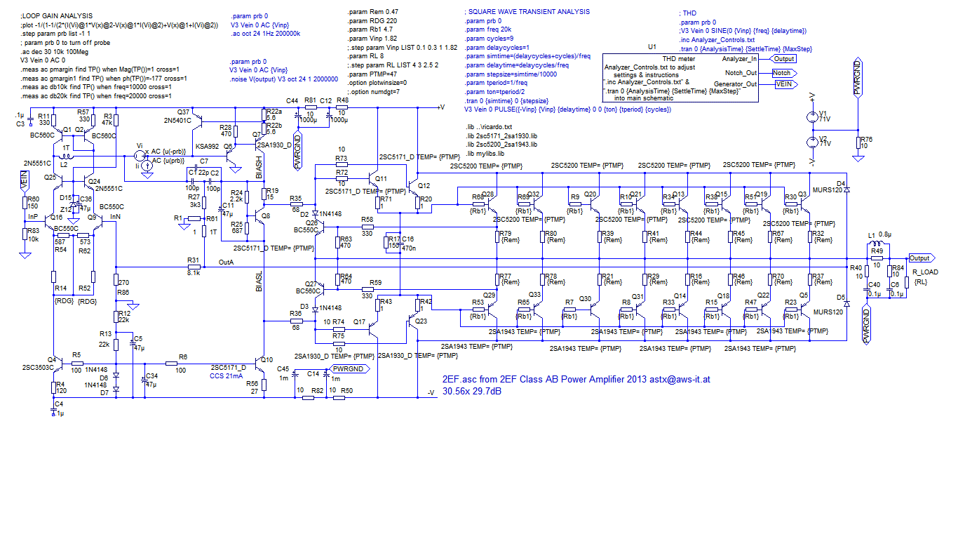

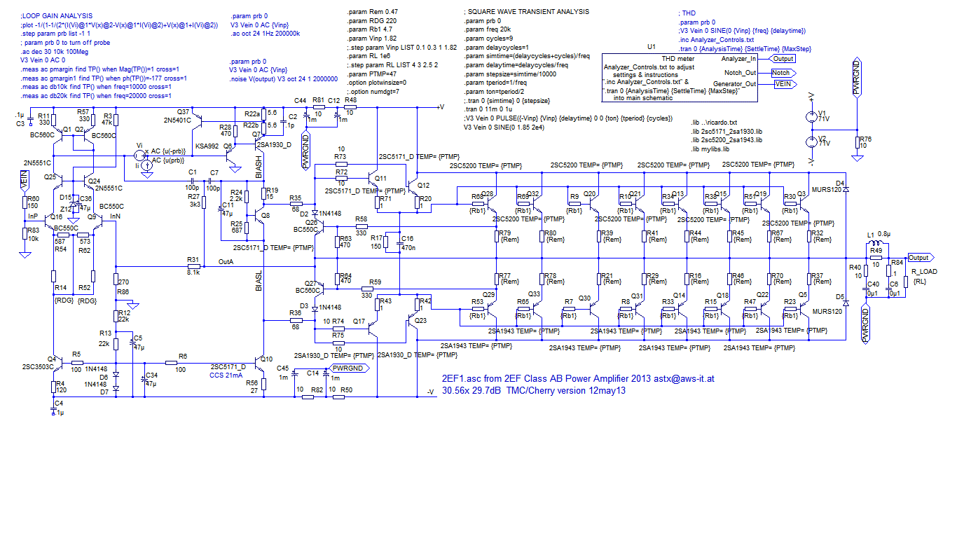

'pure Cherry' with Toni's amp
This is an analysis of the files Toni (astx) posted in #109
http://www.diyaudio.com/forums/solid-state/235188-tpc-vs-tmc-vs-pure-cherry-15.html#post3489738
Toni, my apologies for editing your original but my old eyes need less cluttered stuff to see clearly. Some simplifications:
In general, you keep ‘clean’ GND pristine. But your C3/4 0u1 decouple the small signal stages to ‘clean’ GND. IMHO, this is truly evil and I’ve removed them. This will affect stability & THD in the sims slightly but I’ve not investigated this fully.

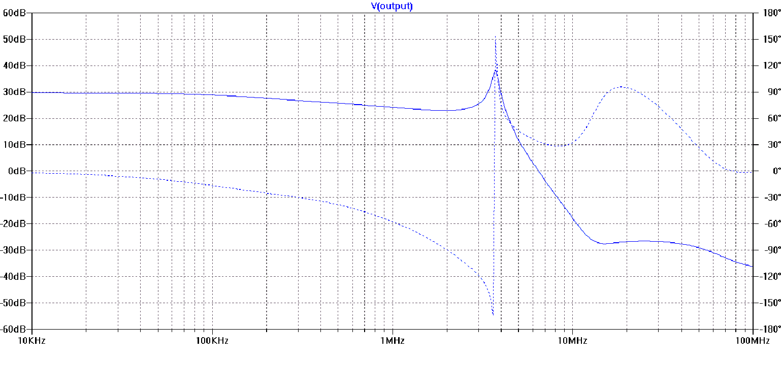

I investigate stability with two main methods.
I use .TRANS on the complete amplifier with a variety of capacitive only loads from 33p to 100n. Toni has a 2nd Zobel R84 & C6 on the output which probably helps his amp with wonky loads. I’ve hijacked it to do my stability testing by making R84 0R1 and varying C6
I do the same with the Closed Loop response, .AC to 100Mhz, with the same loads and look for peaking.
I don’t use Bode plots, Phase & Gain Margins to check stability but only for a quick initial look They are useful if you find stability problems and want to improve this. Also useful are the Nyquist curves that LTspice can do but they need to be used in conjunction with Bode plots. They are not alternatives.
.TRANS with reactive loads & different device parameters is a far better indicator of stability. This is of course exactly what you would (should) do in real life too.
- Removing capacitors across ‘perfect’ voltage sources will not affect sim
- Merging series resistors

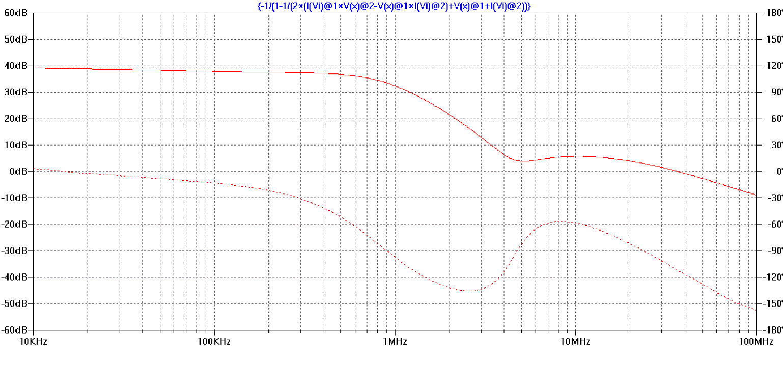

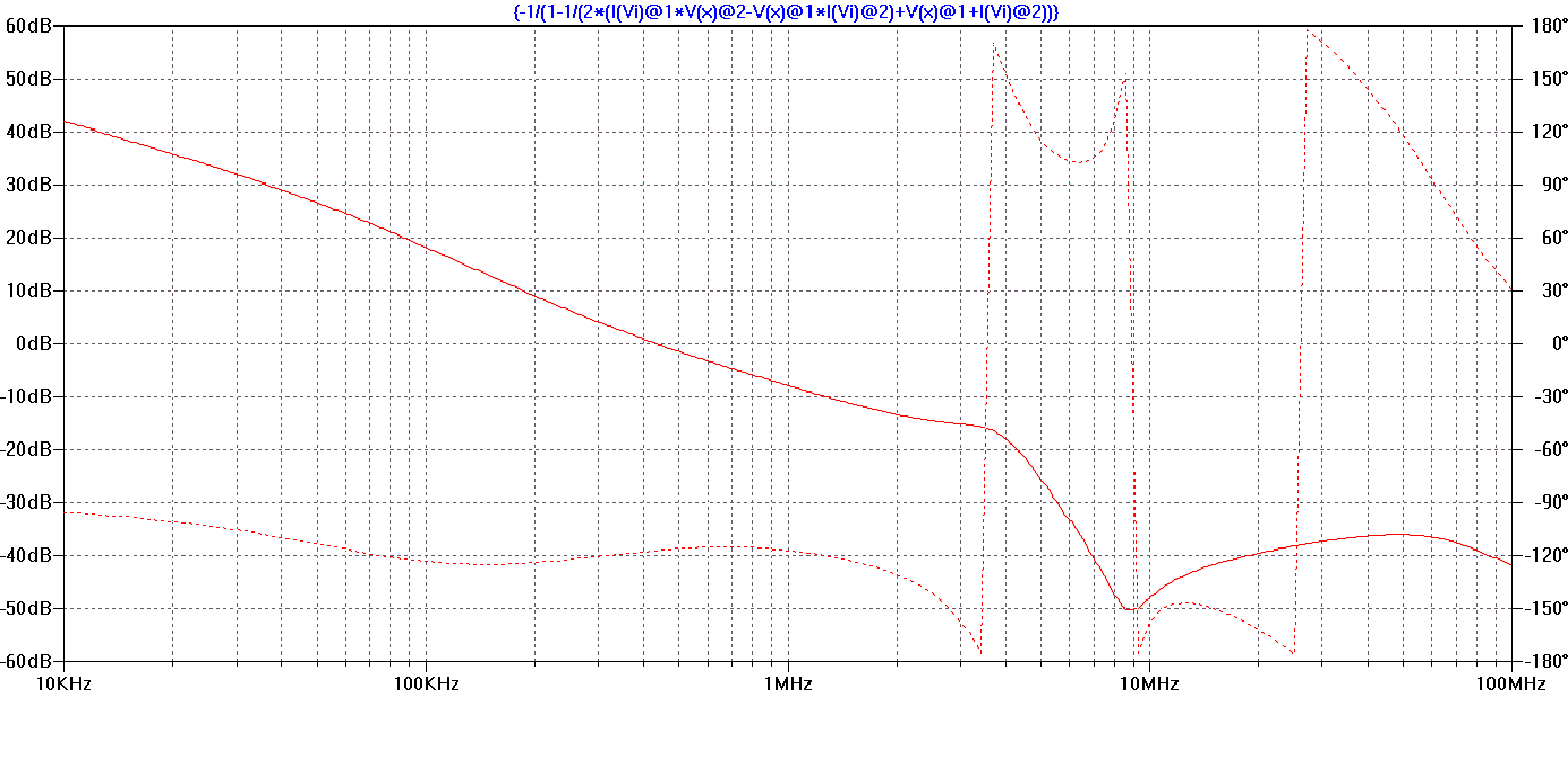

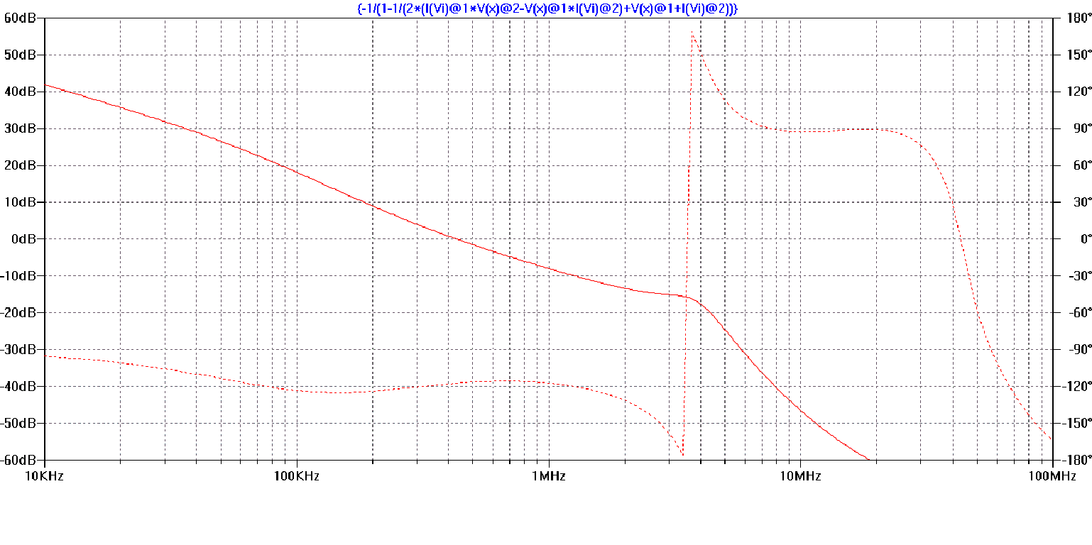

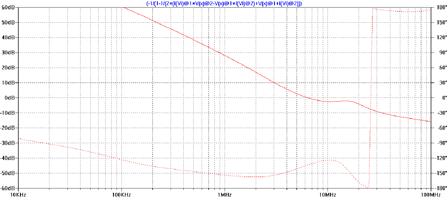

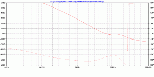

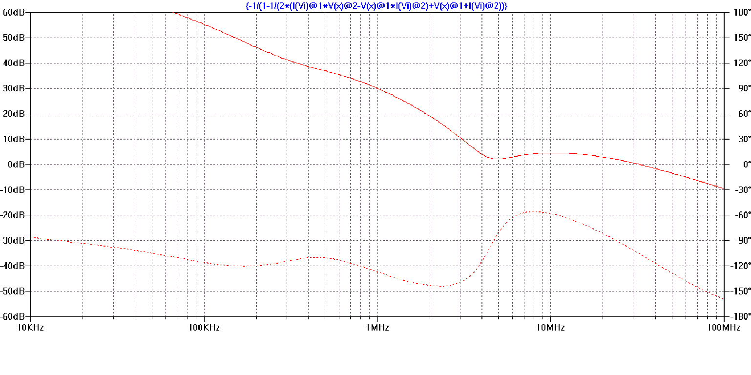

TPC version
First for TPC version, we do a Loop Gain analysis with Tian probe in Toni’s original position. LGorg.gif
Then we move the Tian probe to the VAS input, Q6 base, to look at the inner loop. LGvas.gif
Next we decouple the inner loop from the other loops by adding L2 between IPS output, Q25 collector, and the Tian probe for LGvasDecoupled.gif What this shows is that having the main loop operative gives big changes at LF but above 2MHz, phase & gain is practically identical. So if our stability stuff for the inner loop happens above about 1MHz, we can use the Tian probe on the VAS input without considering whether the rest of the loop is closed or not.
TPC.gif shows what we’ve done so far.
Finally we move the Tian probe to the –ve input of the IPS, base of Q9, for LGwhole.gif
All 4 LG plots show what should be a stable amp. Various loads on the Closed Loop plots and .TRANS confirms this. Even more important … ‘real life’ confirms it too.

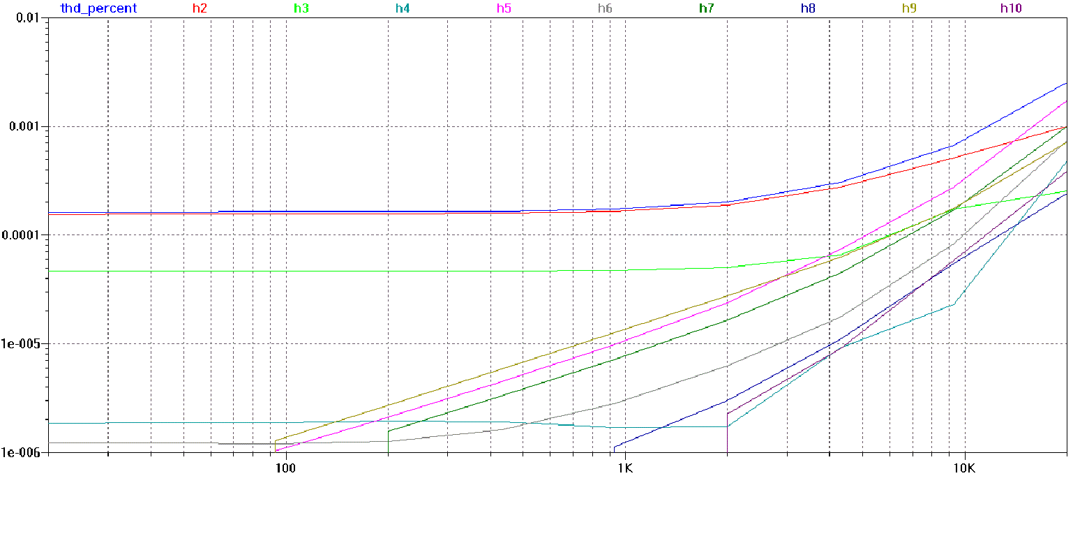

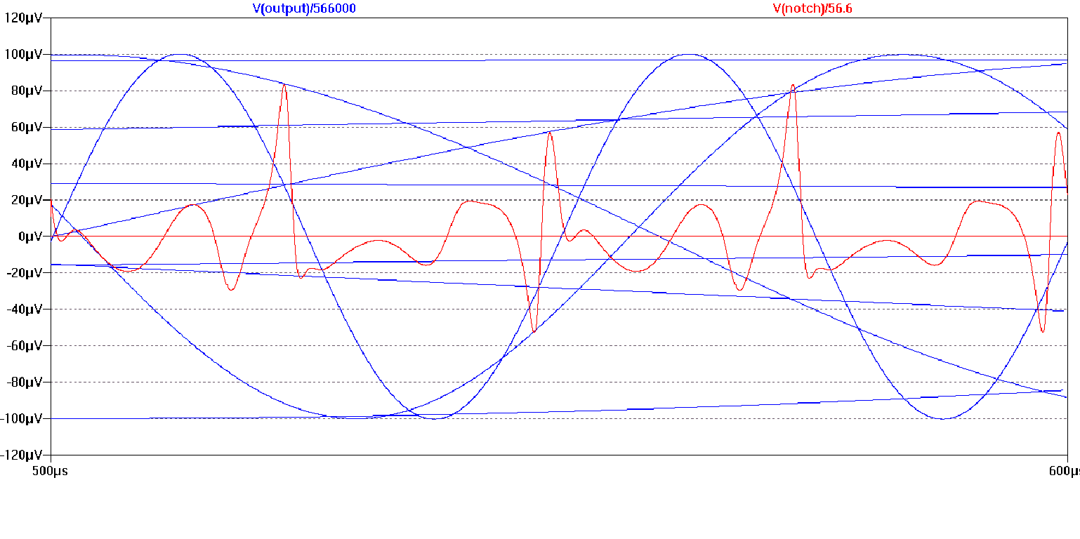

Distortion at 40Vrms into 8R up to 10th harm, using Eugene Dvoskin’s Total Harmonic Analyzer from the LTspice Yahoo Group, is in THD.gif and THD20.gif The latter shows 2 cycles of fundamental at a level of 0.01% to give some idea of scale … and the Distortion Residual at 20kHz. Ignore the LF stuff. Note the spiky 20kHz residual even with 43mA through each output.
But the THD curves are well in line with what Toni measures.

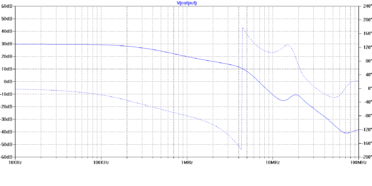

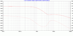

TMC version
Toni says he found the TMC version unstable. If our SPICE model is to be trusted, it should at least suggest problems in this area. Accurate simulation is difficult as this is a big amp with 8 pairs of outputs. Stray capacitances and lead inductances will have much more influence than with a simple 50W amp with only 1 pair of outputs close to the VAS and other stuff. Remember 20nH / inch!
I won’t bore you with a full stability analysis. I couldn’t get the model to oscillate on any ‘linear’ measure or even .TRANS though it came close with certain capacitive loads. The Closed Loop response CL3n3.gif shows what happens with just 3n3 on the output. The sharp Q of the peak is certainly suggests it won’t take much to push this amp into oscillation.
TMC.gif Do we believe this model? Probably. Real life is probably more twitchy cos loadsa extra strays & parasitics.

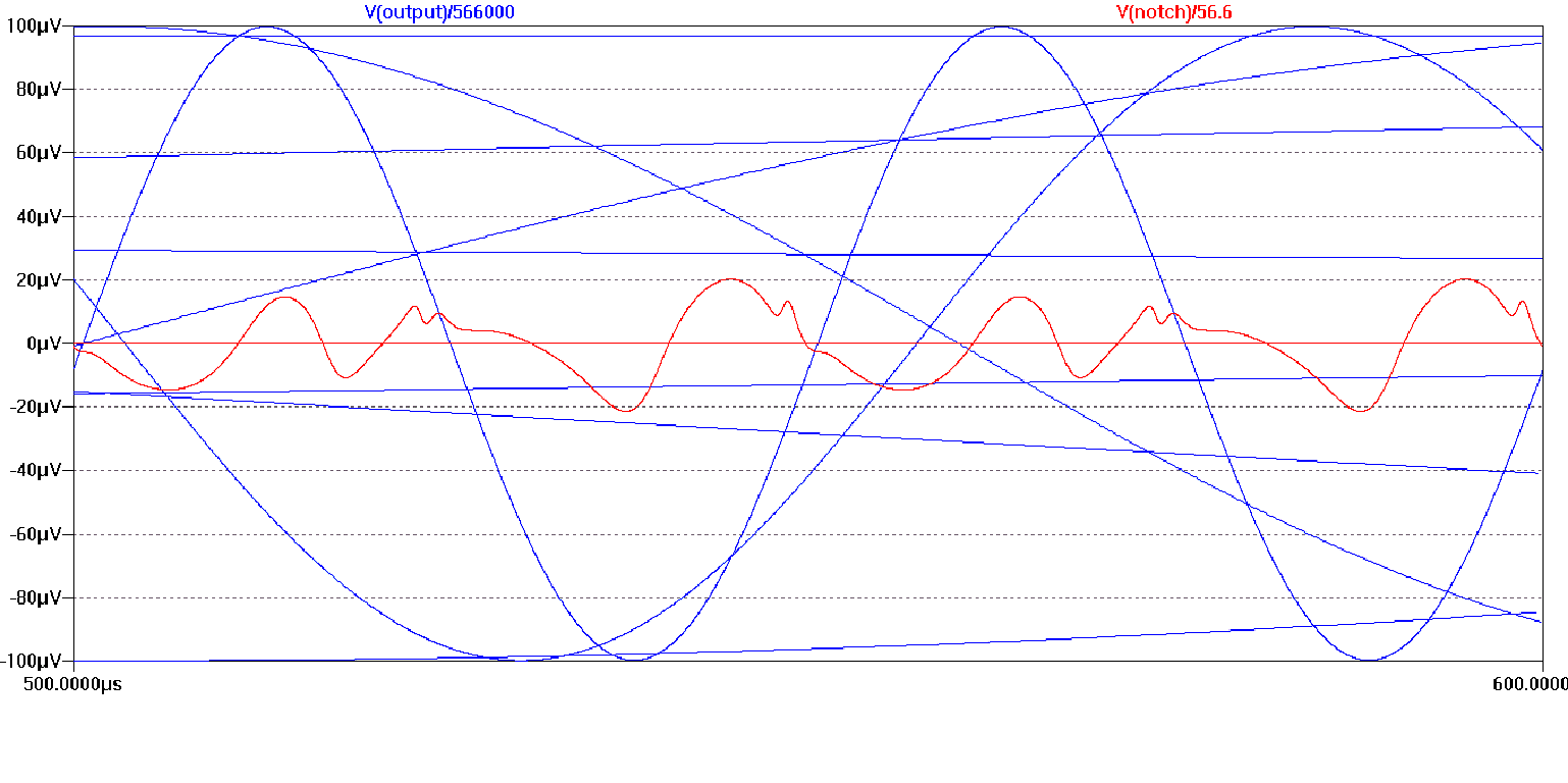

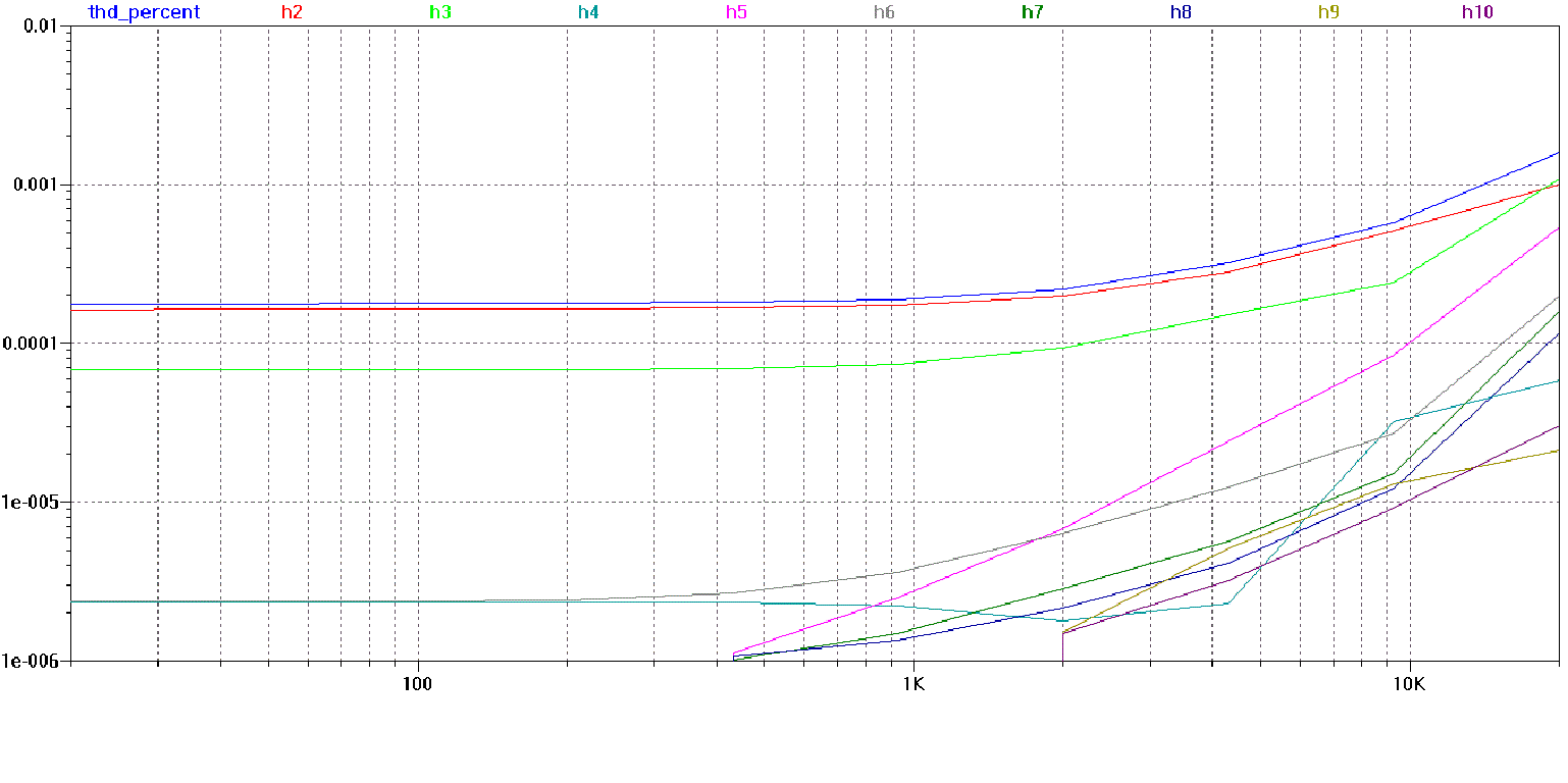

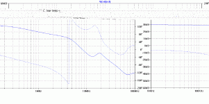

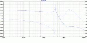

pure Cherry
We convert this into ‘pure Cherry’ by shorting out R27 & removing C7. The Cherry cap is C1 100p. Our first guess at stability tweaking is making VAS emitter R22 = 5.6+22 with C2 1n across it.
1stCherryTHD.gif show the THD performance. LF THD is about the same as the TPC version, HF THD is slightly better but the higher harmonics are much less. 1stCherry20k.gif shows xover spikes have nearly disappeared.
This big change in the residual is a ‘real life’ effect I expect to see.
Stability looks OK on the capacitive loads. But Closed Loop response shows a secondary peak at 20MHz. 1stCherryCL.gif
Sure enough the Loop Gain of the inner loop shows very small Gain Margin at 20MHz. 1stCherryInnerLG.gif
.. but this is just the start of our exploration of ‘pure Cherry’.
- 2stageEF high performance class AB power amp / 200W8R / 400W4R
