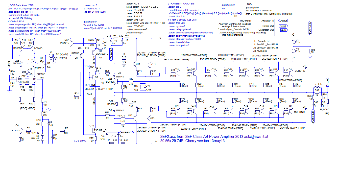

Final Cherry version
Then followed a long period of trial & error, trying to remember what worked in Jurassic ‘real life’ times; finally resulting in Cherry.gif Each step was checked for stability as in #177

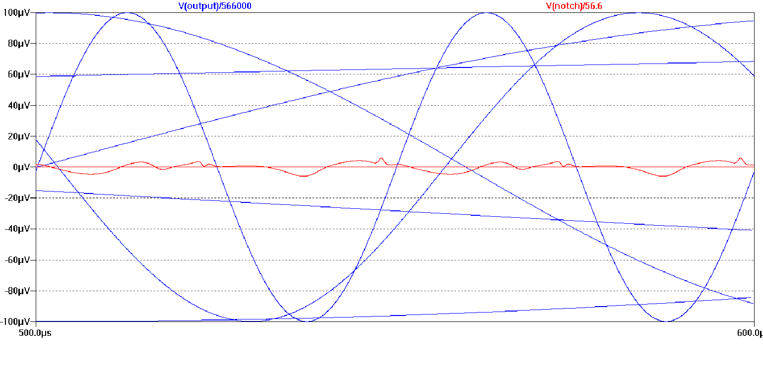

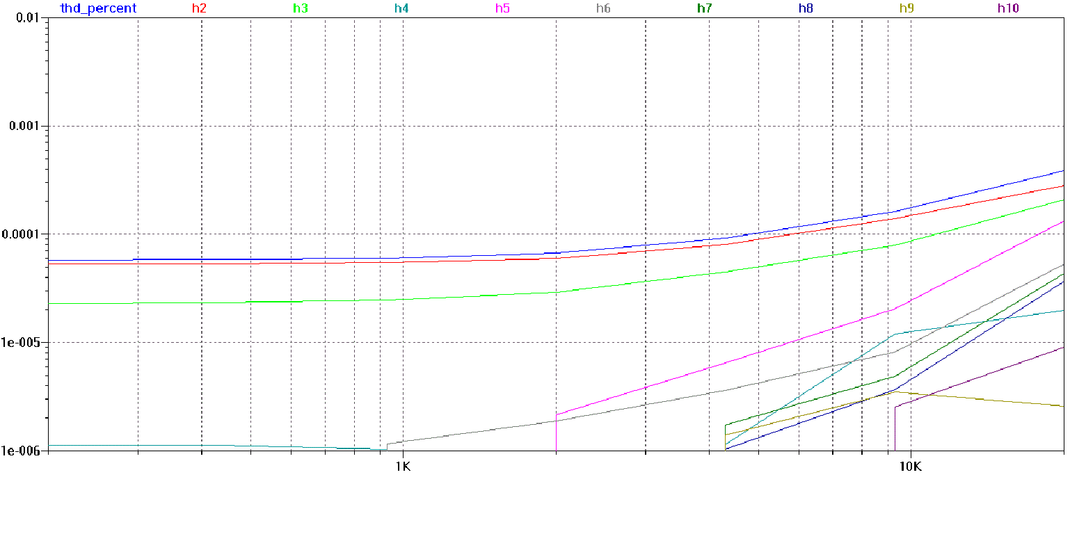

CherryTHD.gif & Cherry20k.gif show what was finally achieved.
Several changes to component values made small improvements but the major gains were by using a smaller Cherry cap C1 47p and doubling Gm for the IPS by making RDG 82
Stability with this extra feedback was achieved by making R22 = 15+12 and C2 1n. These were the most influential factors and the optimum values need to be determined with the final layout. R1 10 in series with C2 is set to improve stability with the most nasty capacitive load which was about 3n3.

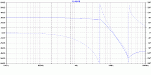

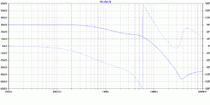

There are 2 loops to consider.

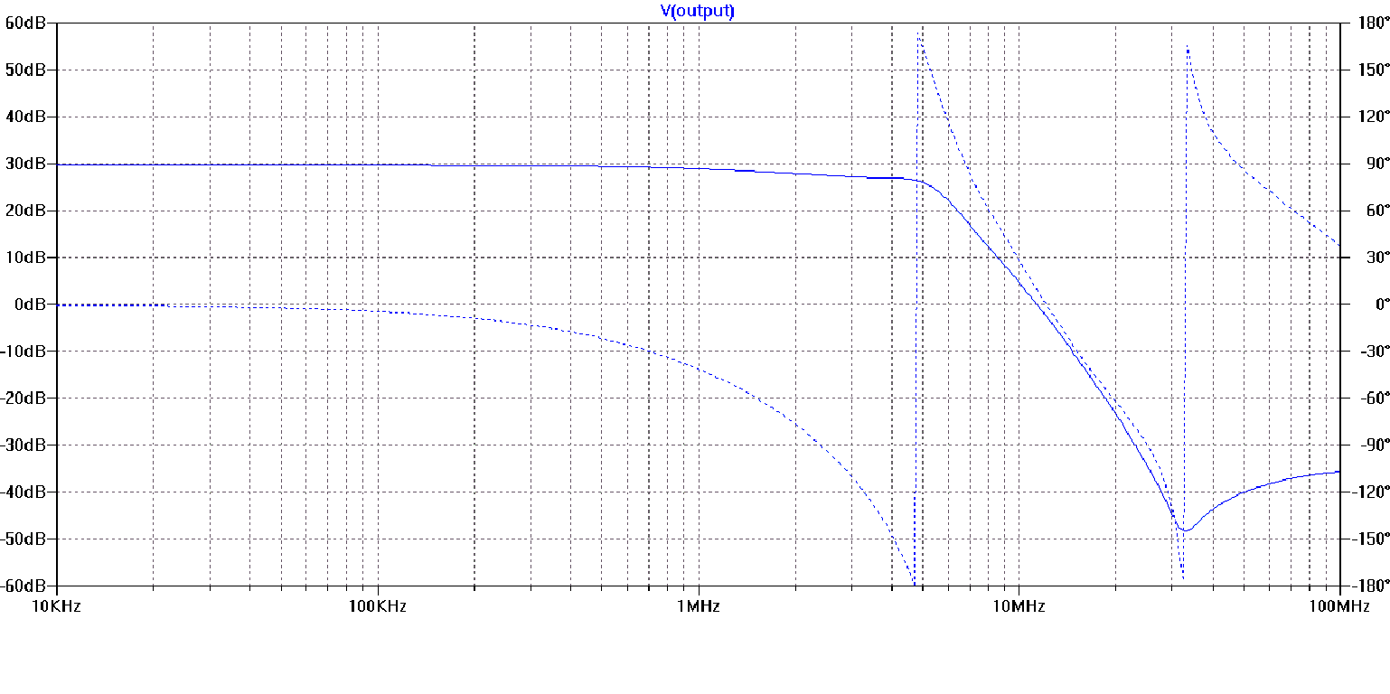

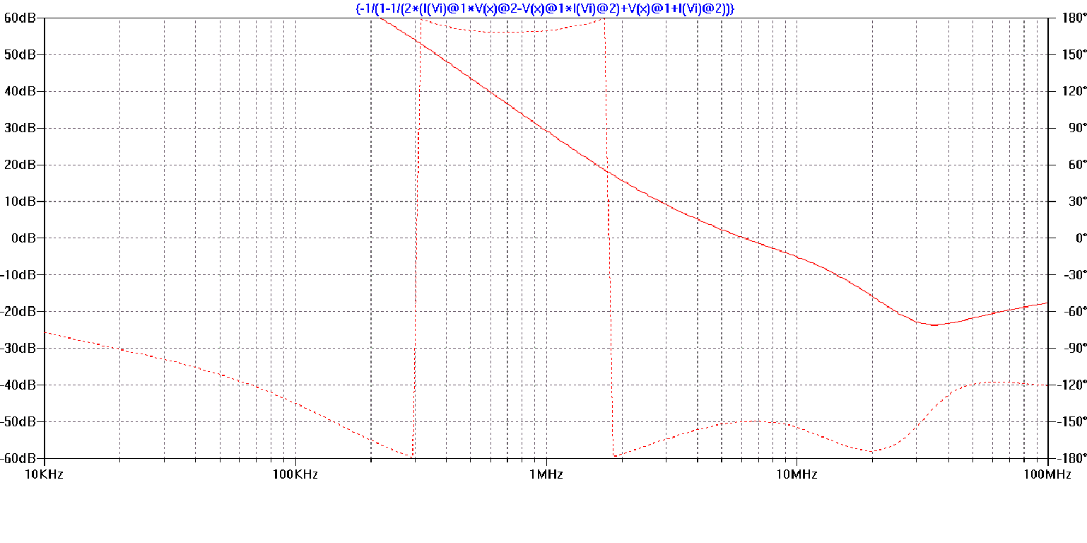

The inner Cherry loop is the most critical as it has 4 devices contributing roll-off in its forward path. InnerCherryLG.gif shows its Loop Gain. Note this is AT LEAST 2nd order at LF even with ‘pure Cherry’ providing an integrating loop. All of Cherry’s own designs have only 3 devices contributing roll-off (single BJT VAS, driver, output) so can usually manage a 1st order Loop Gain at LF with the integrating Cherry cap.
This means the best we can do is to kink the Nyquist curve from 180 (2nd order asymptote gain) as it nears Unity Gain or (-1,0). This is provided by C2 across the VAS emitter resistor at about 6MHz.
With the worst case reactive load (about 3n3), R1 10 in series with C2 provides a little more stability.

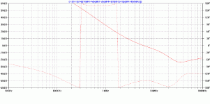

A stable inner Cherry loop becomes a nice integrator for the Main Loop Gain. MainCherryLG.gif Things don’t become wonky until the integrator (the Inner Cherry Loop) starts breaking down. So if the inner loop is good, the main loop is usually not problem.

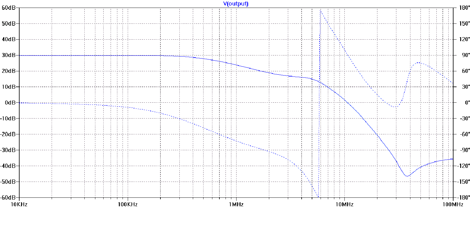

When adjusting stability, R22 & C2 are the main points. R1 is selected for best behaviour on the nastiest capacitive loads.
Stability is also affected by the choice of gains. A bigger Cherry capacitor C1 actually increases Loop Gain around the Inner loop and makes it more unstable. But it also reduces loop gain for the Main Loop. Probably better to reduce Main Loop gain by decreasing Gm for the IPS. (bigger RDG)
ClosedLoop8R.gif and ClosedLoop3n3.gif show the standard Closed Loop response and also the response with the most unstable load.

Some of the small changes are as follows
  • R11/57 on the current mirror adjusted for equal Vce on Q1/2 and Q24/25
  • C3 equal to the Cherry cap C1 added to the other side of the IPS current mirror. This has no effect on the present sim but has huge effect on +ve PSRR.
  • Q6 collector taken to R56 instead of to GND or –V. I don’t know if KSA992 can be used with such a high Vce. The remaining THD is mainly 2nd and this reduces it slightly. It is likely the remainder is due to mismatched hfe on the drivers and output. I welcome suggestions for other causes.
  • C11 1n across the bias spreader can be much smaller than its original 47u. This is a consequence of the Holy HiZ nature of this VAS. In traditional Miller, MIC, TPC or even TMC, voltage drive at the VAS collector mandates a stiff link to the lower driver. Here it’s chosen for stability reasons and has little effect on THD.
  • The split for R22 is adjusted for nice overload behaviour.
Many of these don’t make any difference until the THD drops to a very low level.
I hope this has been interesting. I’ve tried very hard to suggest only stuff which I have at least vaguely tested.
I hesitate to ask Toni to try this for real. I’ve applied these techniques successfully to 50W amps with 1 output pair and a 100W 8R amp using 2 pairs. More devices would mean greater distance and inductance to the various devices. The possibility of disaster with his 400W monster frighten me and I’m not sure I would listen to a beach bum in Oz myself.
At the end of the day, these are all SPICE world results.
Conclusions
  • ‘pure Cherry’ can be used to get very low distortion with simple circuits
  • In particular, higher order harmonics and crossover spikes are greatly reduced
  • Stability can be achieved with a VAS emitter resistor and judicious decoupling of this at VHF
  • Both the inner Cherry loop and the Main Loop need to be carefully considered.
  • ‘pure Cherry’ is useful even for large amps like Toni’s

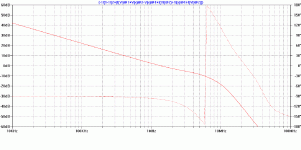

Toni says he found the TMC version unstable. If our SPICE model is to be trusted, it should at least suggest problems in this area. Accurate simulation is difficult as this is a big amp with 8 pairs of outputs. Stray capacitances and lead inductances will have much more influence than with a simple 50W amp with only 1 pair of outputs close to the VAS and other stuff. Remember 20nH / inch!
I won’t bore you with a full stability analysis. I couldn’t get the model to oscillate on any ‘linear’ measure or even .TRANS though it came close with certain capacitive loads. The Closed Loop response CL3n3.gif shows what happens with just 3n3 on the output. The sharp Q of the peak is certainly suggests it won’t take much to push this amp into oscillation.
TMC.gif Do we believe this model? Probably. Real life is probably more twitchy cos loadsa extra strays & parasitics.
