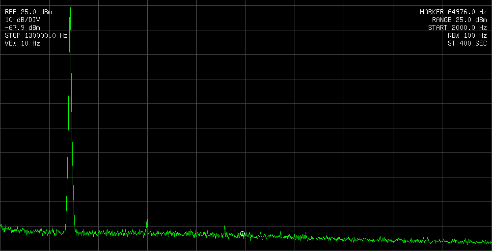

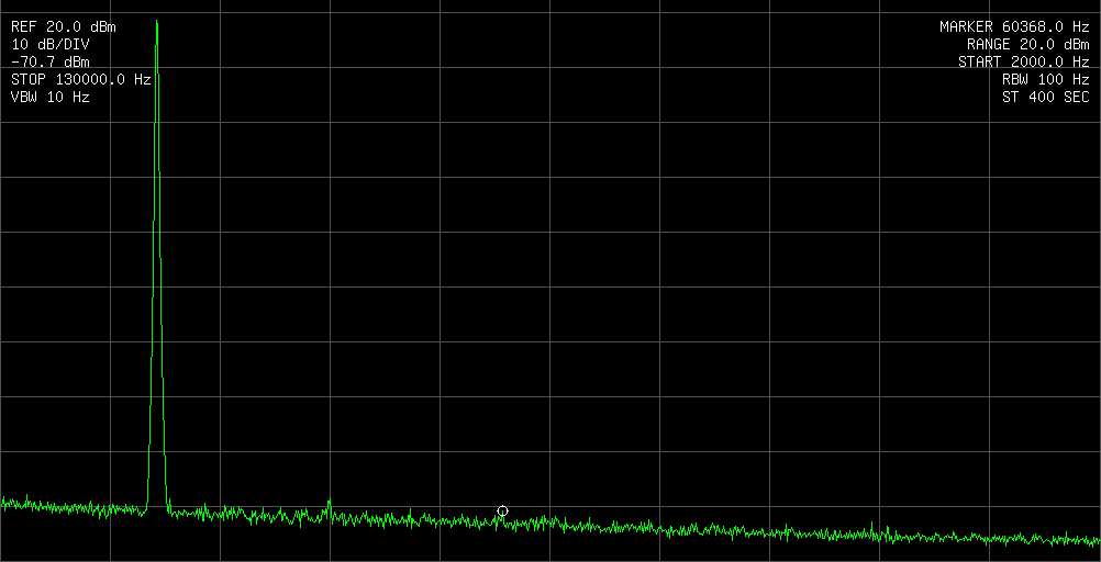

Spectrum comparison
TMC compensated. New spectrum analysis.
Attached spectrum of oscillator output and amplifier output.
Not really a difference between fundamental and H2, H3. 🙂
BR, Toni
