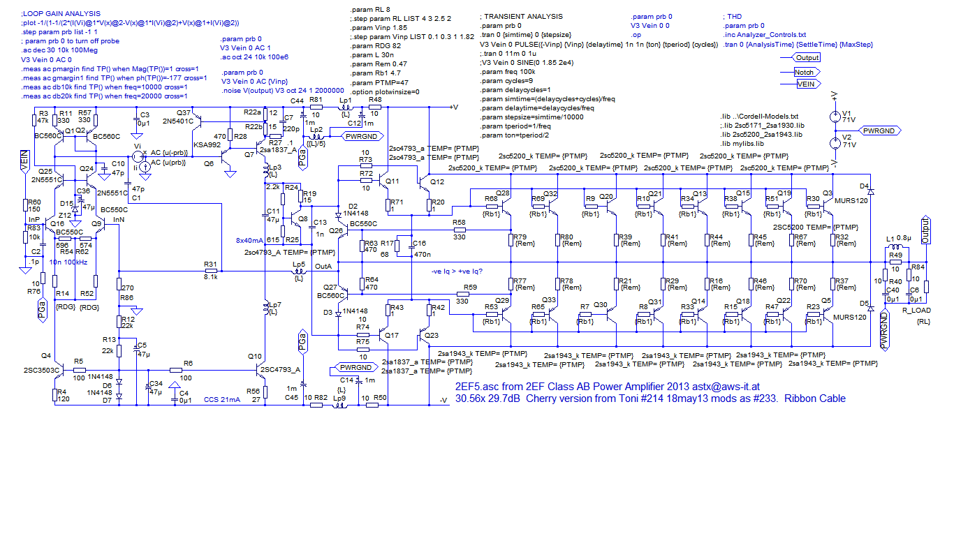

Have simulated outputstage performance:
THD1k@200W@8R: 0.011435%
THD20k@200W@8R: 0.022590%
THD100k@200W@8R: 0.133193%
Not so bad as we have no global feedback.
At about 5.5MHz there is a peak. Could that be the reason of the square wave instability which must be addressed by stronger compensation?
BR, Toni

Note that the VAS is on the same rail as the positive drivers, but not the negative drivers.
VAS+ is double decoupled from V+
VAS- is double decoupled from V-
You can get rid of the peak by shorting out R35/36, the 68R feeds from the Bias Q8.Have simulated outputstage performance:

Ribbon sims?
Toni, I know you said the ribbon doesn't matter but please indulge me. 🙂
I'm including both a .ASC and a pic of my SPICE model that very crudely sims. the ribbon.
Its done with {L} for Lp1, 2, 3, 5, 7 & 9. Lp2 is 1/5 the others cos there are 5 leads in parallel. I'm assuming 20nH/inch. If anyone knows a better, simpler method, please post it.
I just want to know if Lp1, 2, 3, 5, 7 & 9 are in the right place.
I've also moved R76 to the input as its on the small PCB and created a 'PGa' node which is 'POWERGND' on the small PCB.
Is there another connection of 'clean' GND (only exists on the small PCB) to the star-point, eg via the input lead and perhaps chassis?

As I recall the signal lines are separated by grounded lines in the ribbon, which would allow canceling of inductance like a ground plane. Thus the ribbon will behave like a transmission line with a characteristic impedance. It is possibly worth simulation capacitances as well.
astx, the VAS is non-complimentary. The positive side is the active part and it drives both positive and negative drivers. Both positive and negative driver current loops flow through the active part of the VAS. The CCS is another load on the VAS.

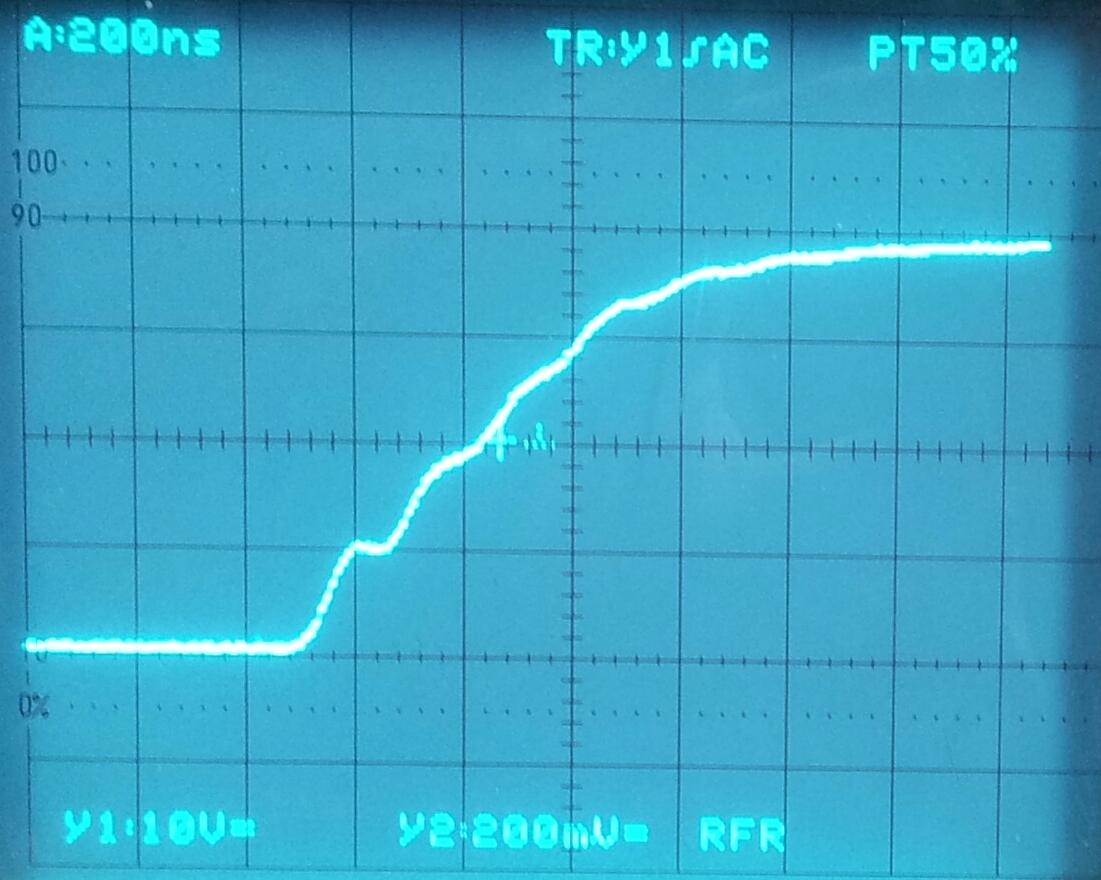

Dear kgrlee, keantoken,
positions of Lp1, 2, 3, 5, 7 & 9 are OK. But using only inductance for simulation is wrong as keantoken correctly states.
About development:
The most annoying problem already exists. The 5Mhz ringing on rising edge. This frequency is constant on using 1.5 inch or 10 inch ribbon cable. As there was a 5 Mhz peak in output stage simulation and kgrlee has identified R35/36 as source I will remove this today - perhaps this will stop the ringing and we can continue with finetuning the amplifier layout.
BR, Toni
About development:
BR, Toni

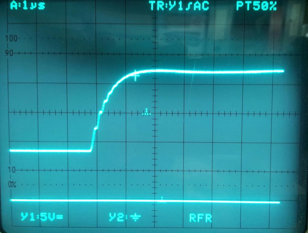

Dear keantoken, kgrlee,
maybe I found a hint what is the reason for the ringing on rising edge:
http://www.altera.com/literature/an/AN476.pdf
Page 12 / Figure 10 show square wave transients on different lengths of transmission lines. I think the ribbon cable AND the long PCB can be seen as transmission line (parallel wired and grounded).
It is now clear that the length of the cable/pcb has influence mostly on time delay which in our case may be ignored. This also explains why different lengths of the ribbon cable showed no significance difference between the measurements.
Now let's have a look on figure 11/page 13. The ringing on the rising edge is caused by output capacitance on the other side of the transmission line. If we compare the attached pictures we can see, that the ringing frequency is independend from load and amplifier output level.
I think this special type of ringing is no sign of bad phase/gain margin and no sign of amplifier instability. In real life we would never amplify a signal with a rise time of < 10ns from 10 to 90% due to limited input frequency.
Don't know how to simulate and verify this theory. Any Ideas?
On the other hand if we could savely ignore this type of ringing we can further optimize the compensation and get THD20k@200W@8R at or near 0.001%
BR, Toni

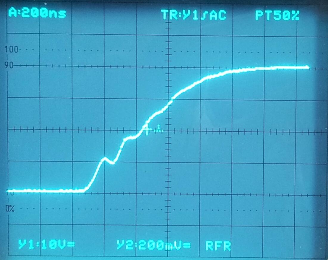

Perhaps this information helps us:
After many hours of comparing output stages with scope etc. the source of ringing seems to be introduced between base of paired drivers Q11/Q12 (Q17/Q23) and output to base of power transistors. Output capacitance load?!
The ringing has significantly lowered after reduction of emitter resistors of paired drivers from 1R to 0.47R.
All other changes like removing R35/36 have brought us little to no bettering of ringing.
Any ideas?

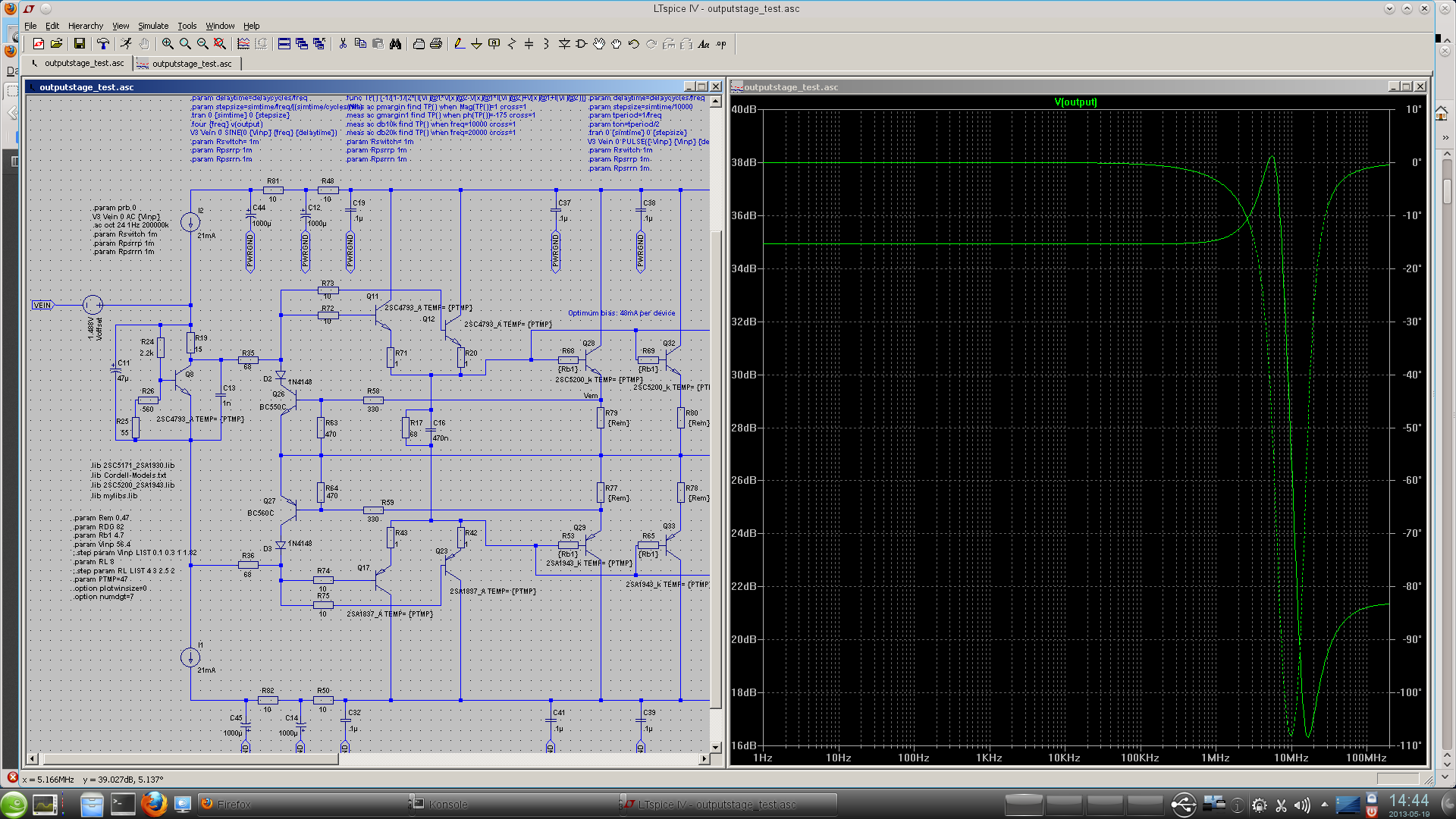

I've lost track: have you actually verified in simulation that the minor loop has sufficient gain and phase margins?
As you say it's usually pretty hard to determine where exactly oscillation originates because once it starts it will propagate around the loop and essentially be everywhere. Tracking down the source would normally require temporary replacement of parts of the circuit (e.g. replacement of output stage transistors with much higher-speed but much lower power capability BC5xx devices) on a trial-and-error basis.
The 1R (now .47R) driver degeneration acts like a base stopper for the outputs. Combined base stopper impedance for 8 pairs with 4.7R stoppers is .59R, so with a combined driver degeneration of .5R you've doubled this. So changing to .47R decreases the base stopper phase shift significantly. The Re of the drivers at 4mA each is about 1.9R though, which would seem to swamp all of this. Maybe you should increase driver bias? Also, are the resistors used inductive?
I see two possibilities, barring inductive resistors. One is that the base stoppers add phase shift that is not agreeable to the compensation scheme. Some amps complain and others don't. The other possibility is that the resonance is caused by local parasitics and the driver degeneration plays a significant part in this.
Why don't you examine square response in LTSpice? I am currently having problems with high slewrate behavior myself. For instance, on a pulse the driver stage will go into class AB with one driver turning off, and this changes AC behavior completely during the pulse. With 8 pairs of outputs, your drivers are VERY stressed at RF. Have you tried increasing driver bias? I thought it was quite low. Also, the VAS may be turning off at negative pulses and pushing many mA on positive pulses. Both these extremes alter AC behavior dramatically.
You may try ferrite beads instead of stoppers. FB73 ferrites seem (from my limited knowledge) to be a good suggestion; LTSpice has a ferrite component. Consider that base stoppers act like output degeneration of Rstopper/Hfe.
