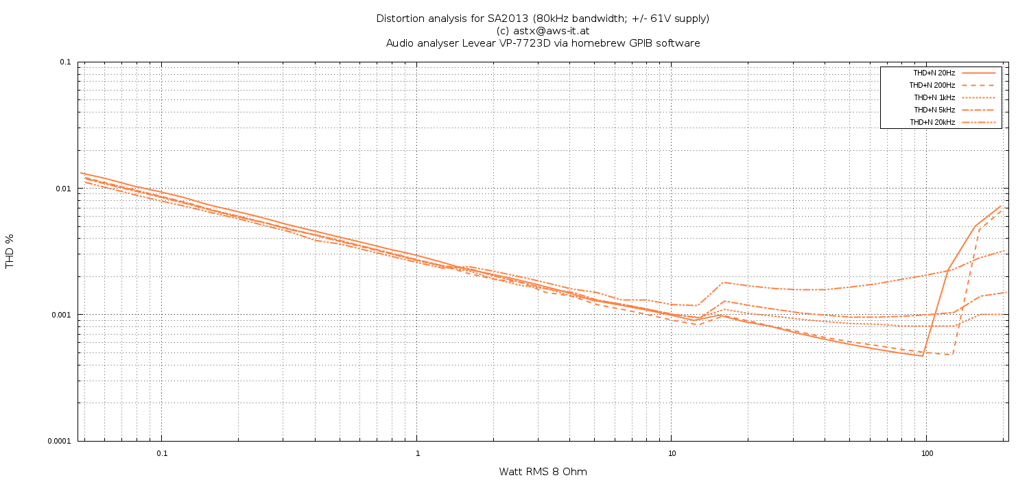

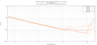

Some words about the current THD plot:
I have measured the THD20k levels of the input signal during max power output test with my HP3585A spectrum analyzer. The H2 level relative to the fundamental is -88,9 dB and the H3 level is about -88.8 dB. H4 and up below 100 dB measurement floor.
So it is clear that the amplifier has to amplify a > 0.001% distorted signal. Is it correct to subtract this known error from the measured 0.0032% or are there other methods for calculating distortion if only spectrum analyzer values are available (relative to fundamental: H2 of output was -86.8 dB and H3 output was 80.9 dB). I think my distortion analyzer has reached his limits some tuning steps before ...
BR, Toni

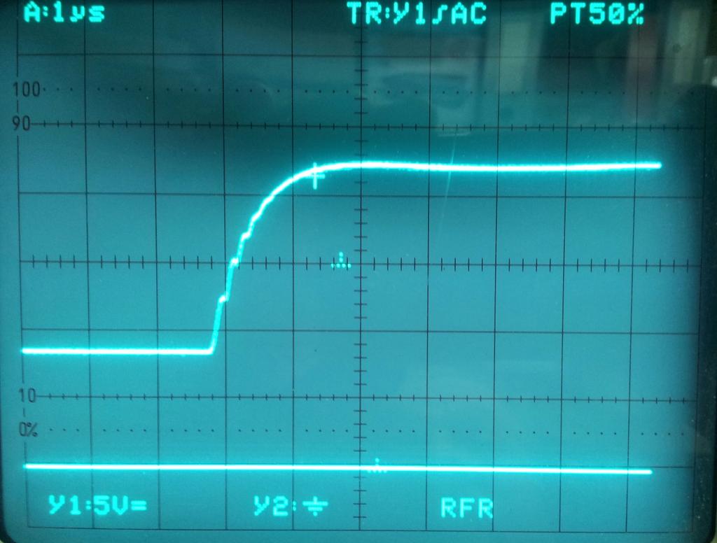

Ringing only on rising and falling edge?
Amp is stable and working fine with TMC. There is only one thing where I can't find the reason why there is this sort of ringing on rising and falling edge. Frequency is about 5-6 MHz.
Anyone has seen this before? Any Ideas where to start "debugging".
Simulation with square root shows some small signs of the same effect...
Or ignore this as we never amplify "square root"?
BR, Toni
BR, Toni
This looks like local ringing at the VAS output. Another thing having to do with an OPS that wants a capacitive source impedance. Try hanging a cap off the VAS output again. Maybe this time it needn't be so large. This is similar to using B-C caps on the drivers, just the current loop follows a different path. Either may work. Base stoppers on the drivers is also something you could try. This issue tends to happen with a high-impedance VAS, which tends to occur when one gets close to optimal compensation. It's not a fault of the VAS, but of the OPS, and while appeasement (lowering VAS output impedance) is the most common approach, correcting the source will open up the amp for more potential.

I'm not sure I understand your question but THD is calculated as the RMS sum of all the harmonics.Is it correct to subtract this known error from the measured 0.0032% or are there other methods for calculating distortion if only spectrum analyzer values are available (relative to fundamental: H2 of output was -86.8 dB and H3 output was 80.9 dB).
ie THD = (H2^2 + H3^2 + .... ) ^ 1/2 where H2 is the level of 2nd harm etc
The code in Eugene Dvoskin’s Total Harmonic Analyzer from the LTspice Yahoo Group makes this clear with a little study.
These have very different effect.Try hanging a cap off the VAS output again. Maybe this time it needn't be so large. This is similar to using B-C caps on the drivers, just the current loop follows a different path.
The Cbc AT the drivers address a 'parasitic' oscillation which is probably not modelled by your sim. C on the VAS output addresses something which shows up in your sim but may have no effect on 'parasitic' oscillation.
Unfortunately, both have the same evil effect on THD
