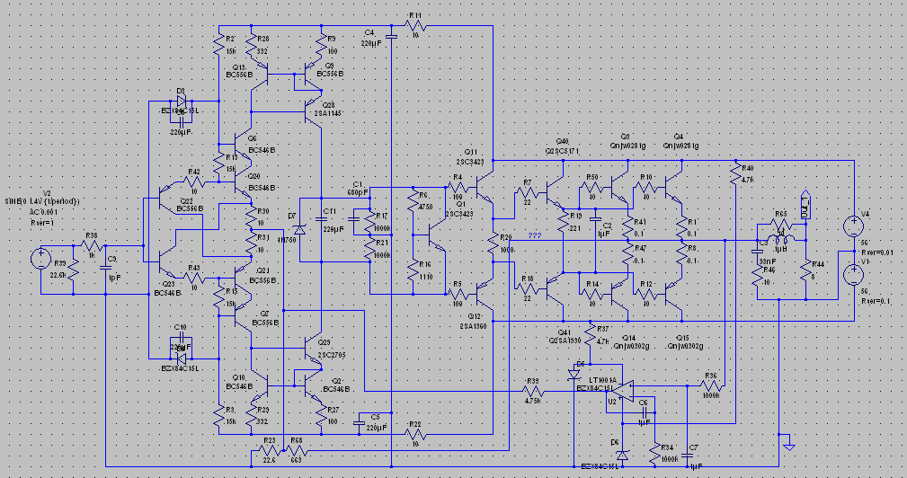

Please don't do this Toni.
Triple EFs are evil. Using them in your excellent design will definitely degrade stability and probably NOT give any better THD. Your design is already better than most designs with triples ... such that it has already attracted favourable comment from triple afficianado, Bob Cordell. 🙂
IMHO, you can get even better performance without increasing the attractive simplicity, with different compensation methods. I see you are already doing this with your variations on TPC.
You might like to try evil TMC and ,, if you are very brave, even 'pure Cherry' http://www.diyaudio.com/forums/solid-state/235188-tpc-vs-tmc-vs-pure-cherry.html#post3474671 😱
Could you send me the latest LTspice .ASC for your amp and also the transistor models? I'd like to see if your excellent circuit can be further improved with 'pure Cherry' .. at least in SPICE world 😀

The capacitive loading of the VAS is significant at 680pF. This swamps out any other parasitics at those frequencies. While this is advantageous for stability, VAS loading is actually larger at treble for this design than for many EF2's.
This sets the dominant pole, to 2.2kHz (approx). There is one important issue: The amplifier needs only 330pF compensation if the driver is 5171/1930. Any other driver needs mosre compensation.
So there is one advantage of this method:The output impedance of the VAS is low at the high frequencies. This means lower distortion in the output stage.

I've heard this a lot, but it isn't true. The feedback loop at audio largely determines impedance at any given point, so the impedance there is virtual. Any signal passing through that impedance will become part of the distortion in the amp. Low or high impedance it doesn't matter, the active devices still must drive the output stage with the same current. Discrete impedances added after the fact only increase distortion because the feedback loop has to work against them. This is a necessary evil where stability is concerned, and the trick is to add impedances where they do not add to the stages' unique distortion mechanisms.
Sajti, this is an interesting circuit.The spice:
Have you some THD and other performance figures to compare with Toni's results? Preferably 'real life' but SPICE will do .

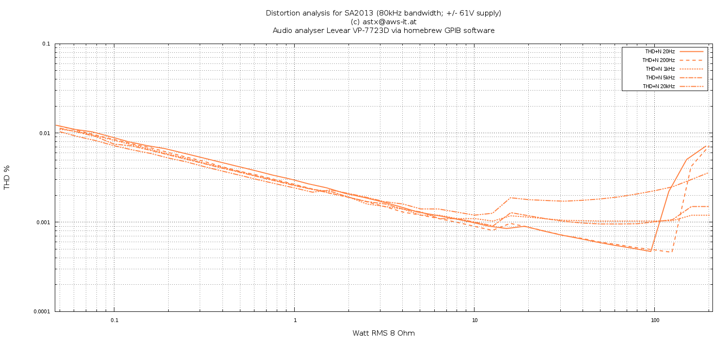

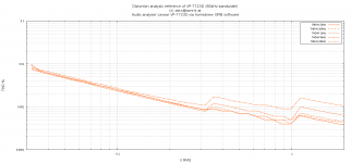

The completed THD power test shows significant higher THD levels from low to high power! 🙁
Perhaps the new drivers needs a rebiasing? The new drivers have better SOA so after some simulations i decided to change R17 from 150R to 68R.
Bingo! 10ppm better THD in real life!
THD20kHz@200W@8R is now at 0.004% (measurement floor of VP7723D is at 0.00106%)
THD1K@200W@8R is now at 0.00130% (measurement floor of VP7723D is at 0.00045%)

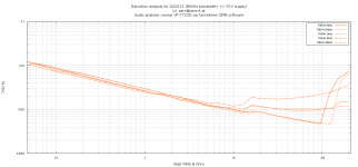

Distortion analysis for R17=68R / 22p removed
All 2SC5171/2SA1930 have been replaced by 2SC4793/2SA1837 including VAS drivers!
2SC4793/2SA1837 are biased with R17=68R
22p bridge capacitor (above TPC) removed.
Note: 20 and 200Hz measurements above 100W are inaccurate as lab powersupply current limiter has actived.
The second plot is the loop measurement of the analyzer itself for comparison.

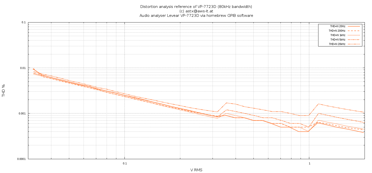

- 2stageEF high performance class AB power amp / 200W8R / 400W4R
