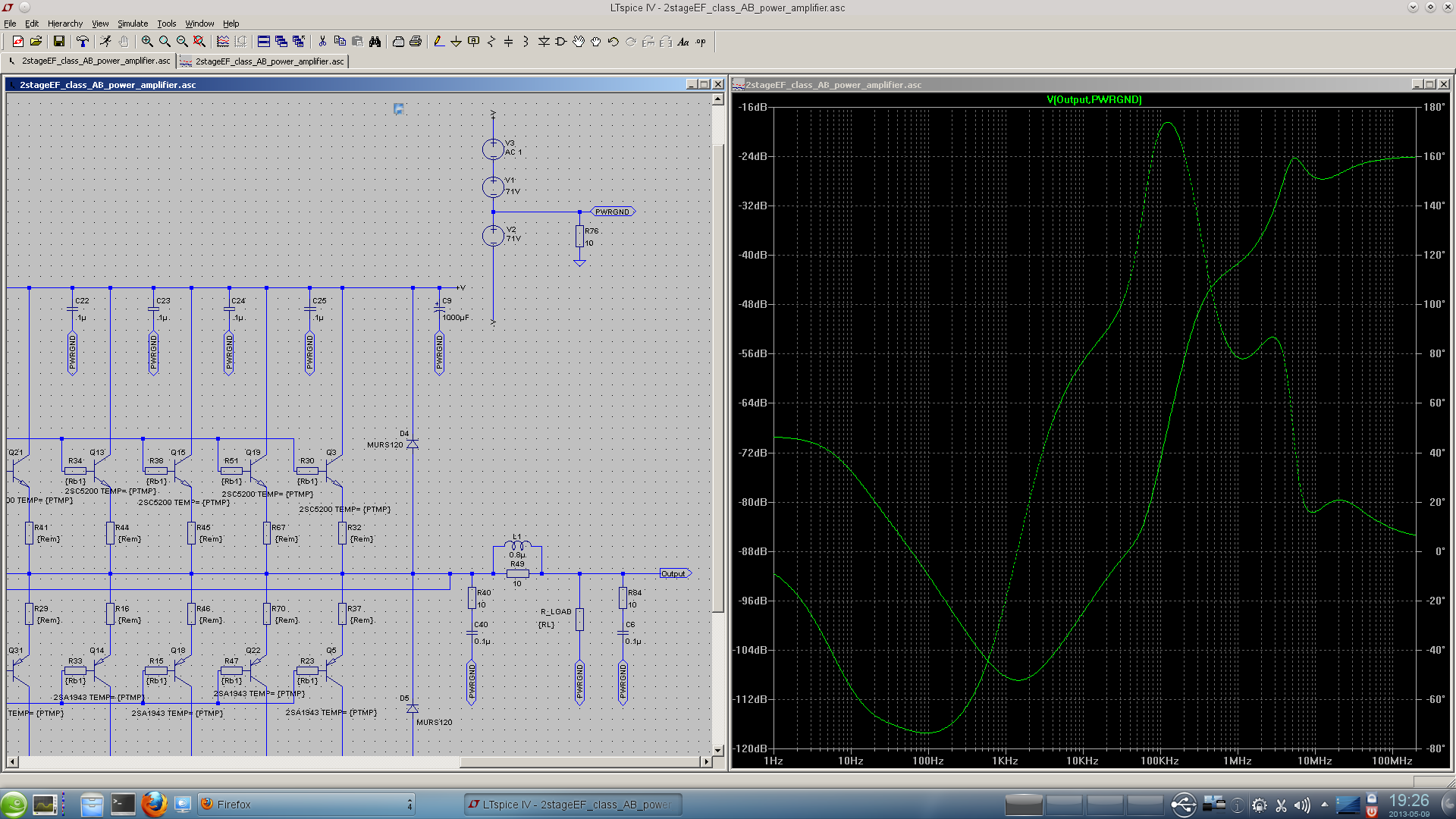

PSRR is 1/Vout, so your chart is upside-down.
To eliminate PSU filtering from the test, I put the AC source in series with ground. Of course you may want to test IPS, VAS and OPS PSRR separately.
PSRR testing by LTSpice
Dear keantoken,
THX. Attached a new PSRR test. Hopefully now correct. Are these acceptable values - do we need here better filtering?
Dear keantoken,
BR, Toni
90db PSRR means you need a -10db harmonic on the rails to cause -100db (.001%) of distortion. So it doesn't seem, as far as simulation is concerned, that PSRR is a dominant distortion mechanism for this amp. I think 90db PSRR is pretty good.

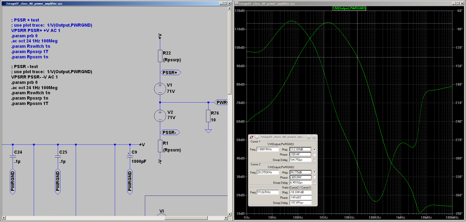

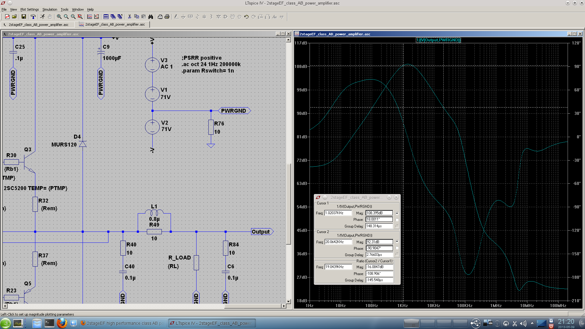

Don't forget that here you have only measured +ve rail PSRR. You will need to repeat the test but with the AC source in series with the negative-rail voltage source.
Dear Harry,
thanks for hints. Attached a PSRR check also from negative rail - better as from positive rail.

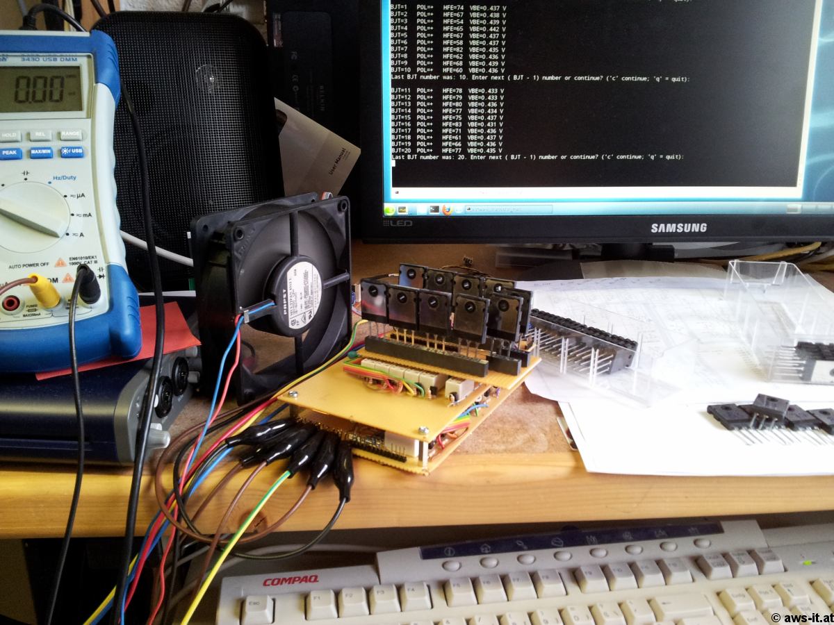

New driver BJT's ...
New driver bjt's (2SC4793/2SA1837 and MJE15032/MJE15033) arrived today! Need matched bjt's.
Will this do with this homebrew "breadboard hellmachine". Can measure 10 pieces of BJT's/JFET's/MOSFET's automatically. 😎
Needs up to 3 USB-controlled multimeters.

Lol very nice, I like it😀
