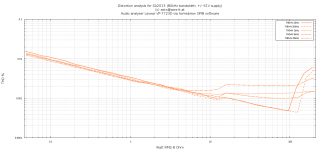

Yesterday made some measurements with R17=150R.
Most of the H2/H3 is produced from the analyzer oscillator output itself.
Load 8R, 200W, 20kHz.
Distortion analysis for current improvements
See attached distortion plot for SA2013
At very high power levels (100W - 200W) the THD values for 20Hz and 200Hz are not representative as the used regulated laboratory power supplies started activating the current limiter ...
(need better test power supplies. 😉)
Can someone compare these results with other real life amplifiers out there to get a feeling in which category the 2stageEF may be now playing?
