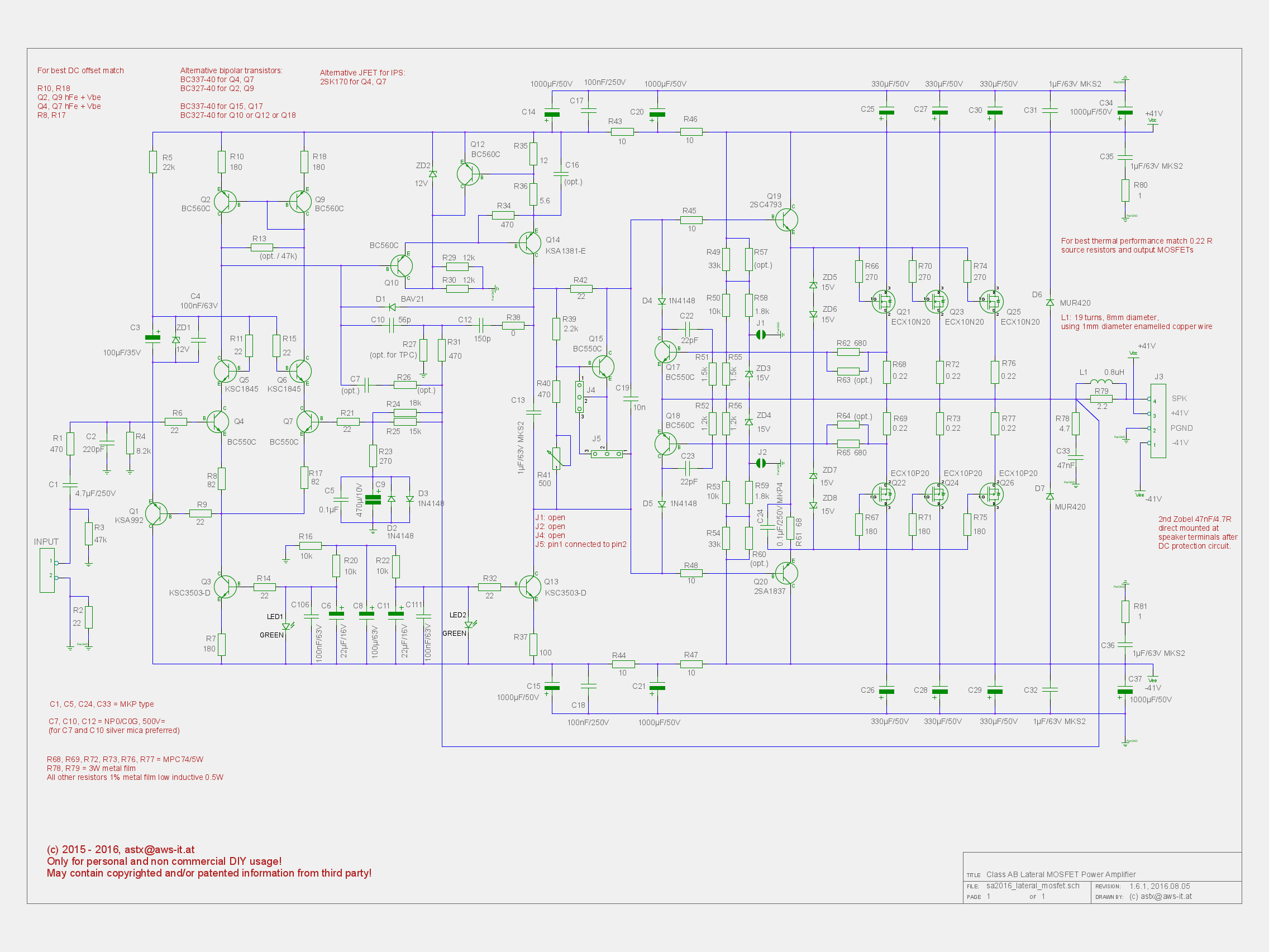

2stageEF high performance class AB power amp / 200W8R / 400W4R
SA2016: using lateral mosfets EXC10N20 EXC10P20
... fixed minor errors
  • nameing schema - SA2016 is the official name for this lateral MOSFET amplifier
  • removed capacitor C16
Just tested another alternative: IPS Q4 and Q7 can be replaced using matched 2SK170GR. THD 20k a little bit higher.
Noise output µV (wideband; bw 80k; bw 20k; A-weighted) with input shorted with 5k resistor (CCS and VAS BC327-40)
Code:
IPS             wb      80k     20k     A-w
                µV      µV      µV      µV
2SK170GR        160     86      42      32
BC337-40        168     92      47      35
BC550C          180     96      50      38
BR, Toni
  • sa2016_lateral_mosfet_rev1.6_schematic.pdf

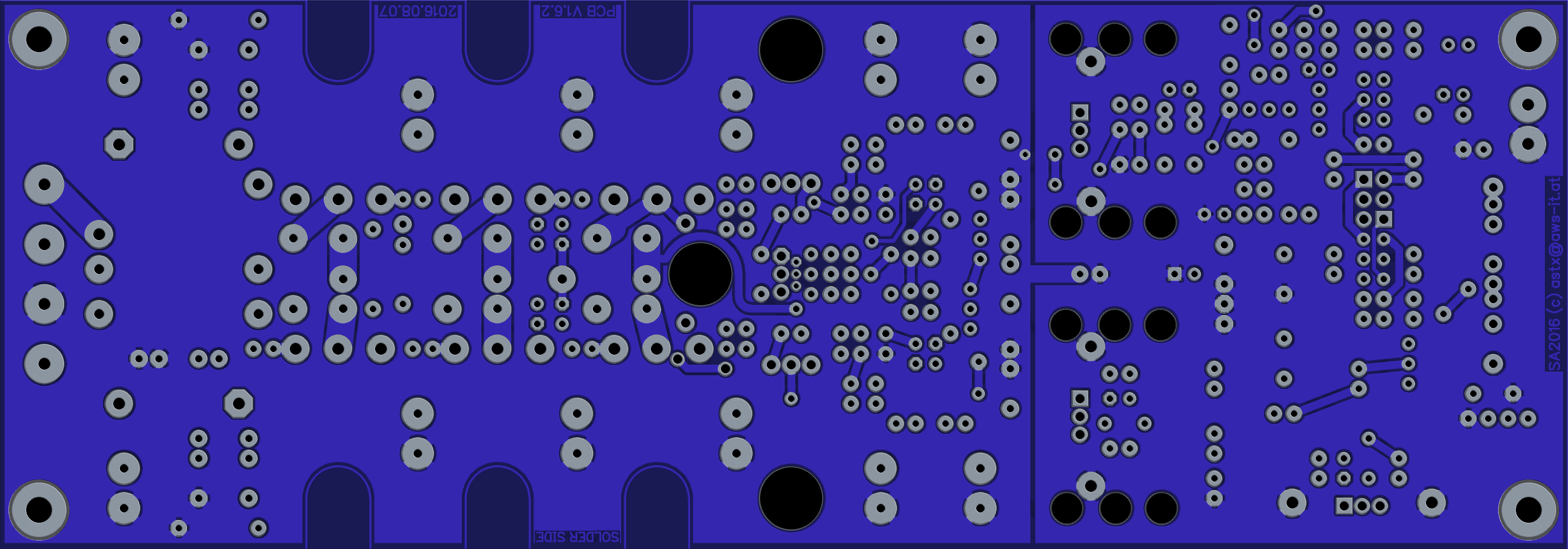

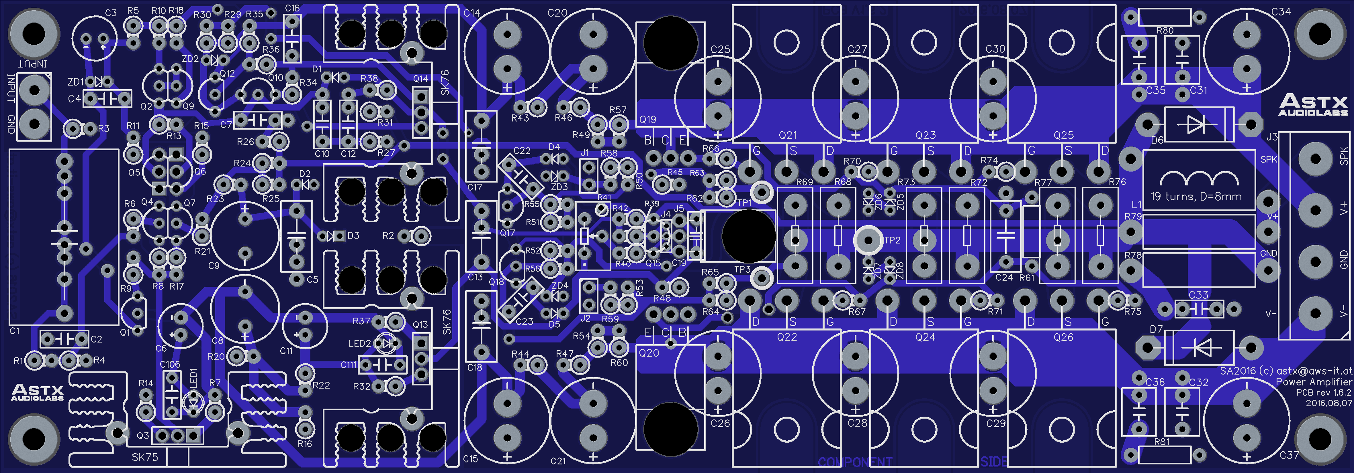

... new pcb's ordered ... hopefully now with no mask error ... 🙂
The design of the IPS has been adapted to be able to use cheap L-shape aluminium as a replacement for the sometimes hard to get small heatsinks SK75 and SK76.

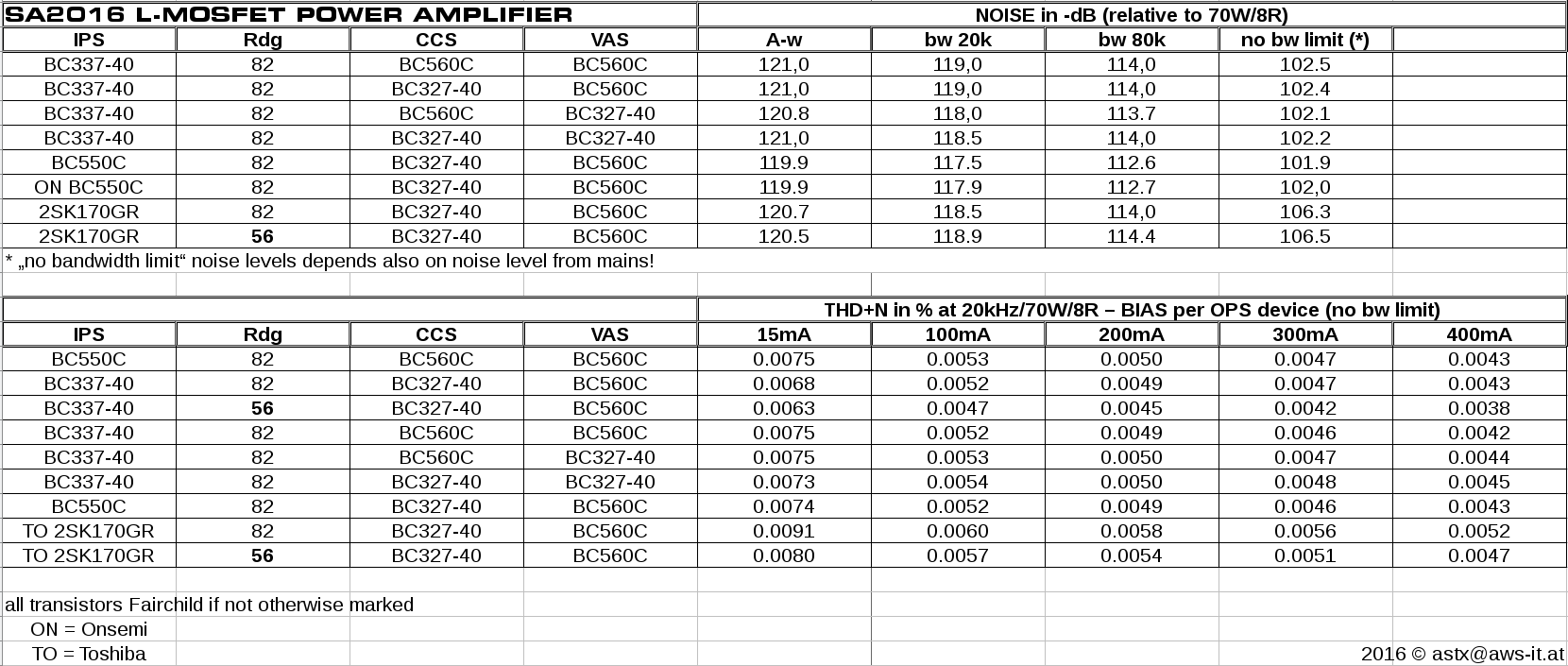

... some noise measurements using different transistors.
There are not really big differences viewable. The "no bandwidth limit" noise levels are dependent on the mains current quality! RF noise due to the many switching power supplies around because.
The noise betters less as 1dB if using BC327-40 or 2SK170GR instead of BC550C. THD levels are very similar. 2SK170 THD level with a lower degeneration resistor of 56R is very close to the BC types using 82R.
If bias is > 300mA per device the distortion residual is free from crossover artefacts at 20kHz full power.
IMHO this makes this amplifier very interesting: you can operate the amplifier with very low bias - 15mA per device - and you still get outstanding THD results. Also for the very important "first" watt!
BR, Toni
by coincidence I installed 51r1 for the degeneration value ready for plugging in LSK170 input pair.
Very good! From simulation result there should be enough headroom regarding PM and GM.
Just tested with 2SK170GR Rdg 47R: no signs of instability. THD+N 20k/70W/8R 0.0035% bw 80k, 0.0052% no bw limit.
Slewrate > 100V sym.
BR, Toni

To change from the ±41Vdc supply rails to using a 35-0-35Vac transformer giving ~±50Vdc you need to change six resistors
resistor ±41Vdc . ±50Vdc
R5 . . . . 22k . . . . 27k
R16 . . . 10k . . . . 13k
R29/30 . 12k . . . . 16k
R49/54 . 33k . . . . 42k?
For the protection locus you may have to also change R51/52
Why are these shown differently in the upper from the lower?
Have I missed any others that should be changed?

Dear Andrew,
thanks for update! Regarding output power you are right: only 8R load is allowed with those Exicons and ± 50V supply.
The SOA protection resistors (R49, R54) need not to be changed. Those are exactly fitted for use with ECX10[NP]20. Otherwise a complete redesign of all values is necessary. A quick SOA check running ±55V showed a enough safety margin for VAS, drivers and other transistors used here.
So effectively you need only to change those values as you recommend:
Code:
resistors  ±41Vdc    ±50Vdc
R5          22k       27k
R16         10k       13k
R29/30      12k       16k
transformers AC secondary
           2x30V     2x35V
max output power 8R
            78W      115W
max output power 4R
           140W       N/A
(my max. output power means: THD+N 20k below 0.01%!)
BR, Toni

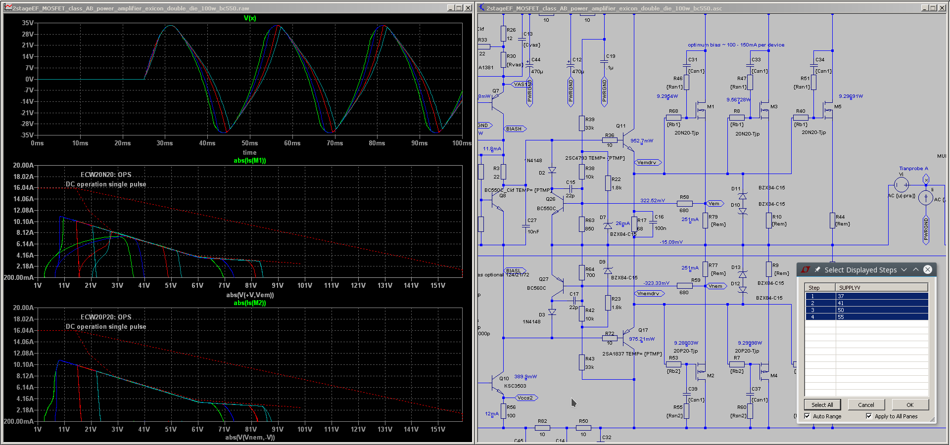

the upper resistor (R49/54) feeds some of the power rail voltage into the protection transistor (prot Q) base.
This base voltage must never exceed the transistor turn on voltage, when the amplifier has no signal and no output current.
That rail voltage is effectively the IV's method of monitoring the V part of the protection locus. And the voltage across the emitter/source resistor is the way the IV generates the I part of IV.
Those two input signals feed into the prot Q base to either keep it turned off, or start to turn it on.
The harder one turns on prot Q, then the more that transistor sucks signal out of the signal feed into the output stage.
If one changes the supply rail voltage, then the base voltage on prot Q changes. The V resistor MUST be scaled to suit the supply rail voltage.
If you don't, then a very low supply rail will excessively delay the prot Q from turning on when needed to limit output.
Conversely, a very high supply rail voltage feeds too much current into prot Q and turns it on even though there is no output, or a very low output that should be considered a valid audio signal and that should pass without IV limiting.
Inadequate design of the IV that either does not limit, or limits valid signals, is not worth having. One must design the protection locus to suit the amplifier's loading conditions and that includes the supply rail voltage.
I was asked many times in an old Thread to redesign the IV for different amp builds. I refused because I knew that every apparent small change in operating conditions changed the IV component values. Instead I issued a few copies of the spreadsheet that showed the IV protection locus to allow the Builder to rescale the component values for their chosen operating conditions.
In principle you are right.
If you change one resistor in this dual slope IV limiter you need to redesign all others and the zeners too.
Stepping the supply voltage in simulation from 35V to 55V the currently implemented VI limiter behaves very well and the SOA limit curves overlap nearly at the same points so nothing to adapt here for the above supply voltage range and the used output transistors.
BR, Toni
SA2016: using double die lateral mosfets ECW20N20 ECW20P20
Attached a SOA plot for the double die exicons with rail voltages stepped from 37V to 55 V. SOA lines overlap nearly exactly - mostly independent from supply voltage.🙂
BR, Toni
