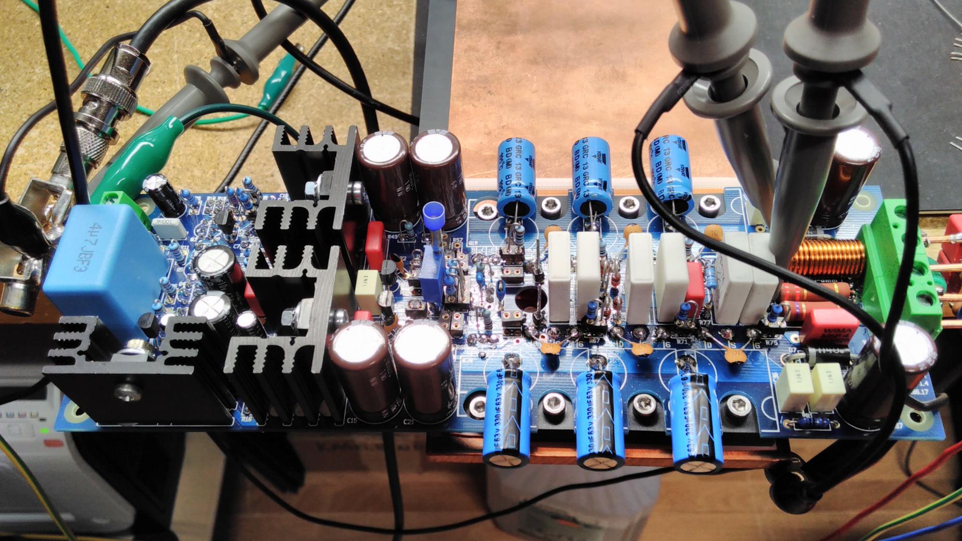

I think this is more a problem of the too less distance between the OPS devices. The gate stopper resistors are less as 5 mm in distance to the OPS devices plastic body - but how to get shorter?

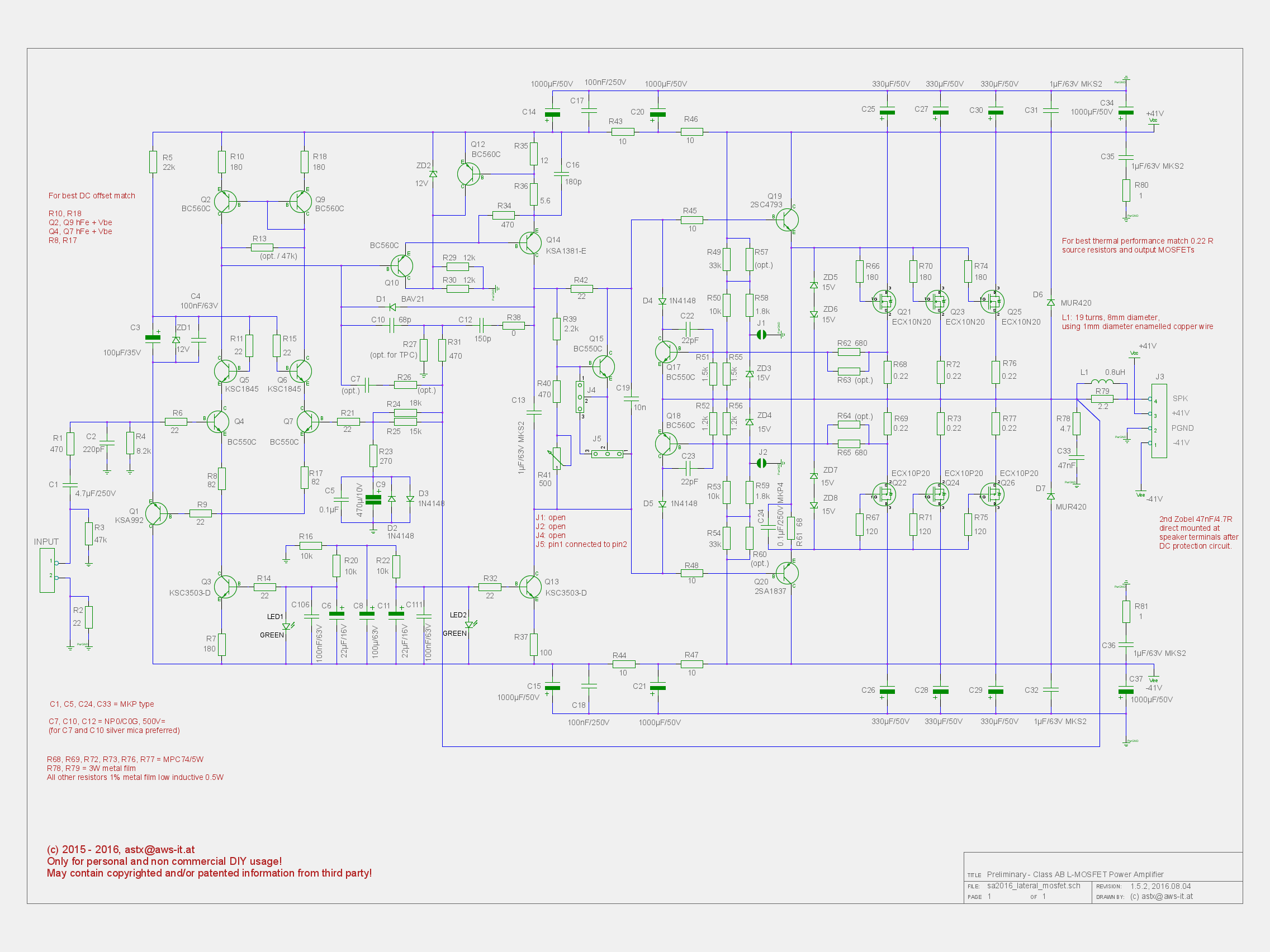

All part names referenced to schematic from post #1700
All exicons Rgate N/P: 180R/120R, CgateDrain 10pF
  • C7 10p - no subtle oscillation
  • C7 15p - no subtle oscillation
  • C7 18p - frequency is around 23.4 Mhz
  • C7 22p - frequency is around 23.1 Mhz
  • C7 27p - frequency is around 21.2 Mhz
  • C7 33p - frequency is around 19.8 Mhz
  • C7 40p - frequency is around 18.4 Mhz
The amplitude of the oscillation is small compared to output signal 2.8Vrms - about 100mVpp.
All caps used for testing (maybe not the best but on stock) MLCC NP0/C0G caps 5% tolerance (e.g. Kemet C317C220J2G5TA 200V/22pF)
C7 + 47R + about 2000 nH is our R+L+C candidate.
The pcb wires (length/loop diameter) can not explain this relative large L and the measured frequencies do not match the calculated ones.
Maybe I was to agressive with the extra compensation caps?
Simulation doesn't show any signs of instability here compared to the real world. 🙁

When you get resonances where too much inductance is implicated, it tends to have to do with the feedback loop of the amplifier rather than the inductance of the wiring. The amplifier can create a virtual 2uH inductance for instance, and than the MOSFET can cause the oscillation between that and it's capacitance.
Another possibility is that it's not Cgd that's oscillating, but Cgs which is much larger. I don't know how that would happen though.
You could check that you output L/R network still has a working R.
Also if you have an output cable connected it's LC could be interacting with the oscillation.
SA2016: using lateral mosfets EXC10N20 EXC10P20
Many thanks! Think you are right here! The oscillation frequency can be changed with different C7 values and the relatively high L must be some sort of electronic/virtual inductance. The calculated R+L+C values shows some difference of the frequency. Lower values of C7 stopped oscillations.
Next step: using C7 10pF, remove all 6 CgateDrain and check again for oscillations.
Have seen some circuits using lateral mosfets (e.g. 2SK1058) which have external caps from gate to source to compensate the Ciss difference to equalize the gate resistors. (Is this a good idea to do so?)
OK so far.
Tested - oscillation is independent of connected resistive 8R load.
Also, your scope probes create a ground loop which is inductive enough to resonate. Try moving the ground clips to the heatsink or somewhere else.
Tested - no influence on oscillations. Scope and spectrum analyzer probes are located at output zobel pi network left side.
BR, Toni
Works!
  • Removed C7
  • Removed R26
  • Removed all 6 CgateDrain
  • C10=27pF, C12=270pF, R31=470R
  • Rgate N/P: 180R/120R (very low so far, mostly in use in other projects is 330R/220R and 470R) maybe I will increase the resistor values for more safety margin.
Stable, no oscillations! Slew far beyond 100V/µs.
Using small signal square wave: signs of instability starts slightly with C10=15pF, better viewable with C10=10pF.
Back to simulation to check safety margins...
Unnecessary to say, that THD+N is also very good.

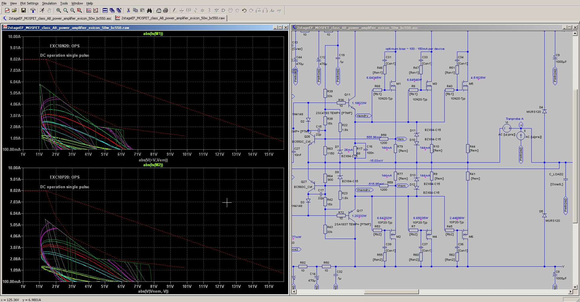

Next step: add current limiter.
Simulation plot file generator used this definition file to generate the plot file (details will follow in the new ltspice/soa thread):
Code:
# PGMR: (c) 2016, astx (at) aws-it.at
our $traces     =       [
                'soa_of'                =>      'EXC10P20'              ,
                'current_sensor'        =>      'Is(M2)'                ,
                'diff_voltage'          =>      'V(Vnem,-V)'            ,
                'desc'                  =>      'OPS'                   ,
                'soa_of'                =>      'EXC10N20'              ,
                'current_sensor'        =>      'Is(M1)'                ,
                'diff_voltage'          =>      'V(+V,Vem)'             ,
                'desc'                  =>      'OPS'                   ,
The current limiter must pass all valid audio signals into all valid audio loads.
That requires the limiter to pass transient currents into highly reactive loadings.
This limiter should also protect the output stage from longer term and even DC currents.
Is there a way to differentiate between DC and long term AC and transient AC currents?
So that these different requirements can be analysed?
Can you show the changes to allow the plots to become LogLog to make the SOA "appear" as the manufacturer shows them?
With a one transistor arrangement it will be difficult or impossible to fulfill all your requirements ...
With this kind of VI limiter - if correctly implemented which is not an easy job - your output stage will be protected very good.
If you want minimized influence on sound better omit the VI limiter.
With my perl tool you can generate plots linear and/or LogLog. It depends on how much SOA data lines/points you have extracted from datasheet. In my example you see a longer line which is useful for LogLog display only. Smaller lines (V,A from and V,A to) are then useful if you want to display linear. This picture, the tool and hopefully more discussion about SOA simulation and how to do this can be found here:
http://www.diyaudio.com/forums/solid-state/294790-using-ltspice-check-soa-violations.html
BR, Toni

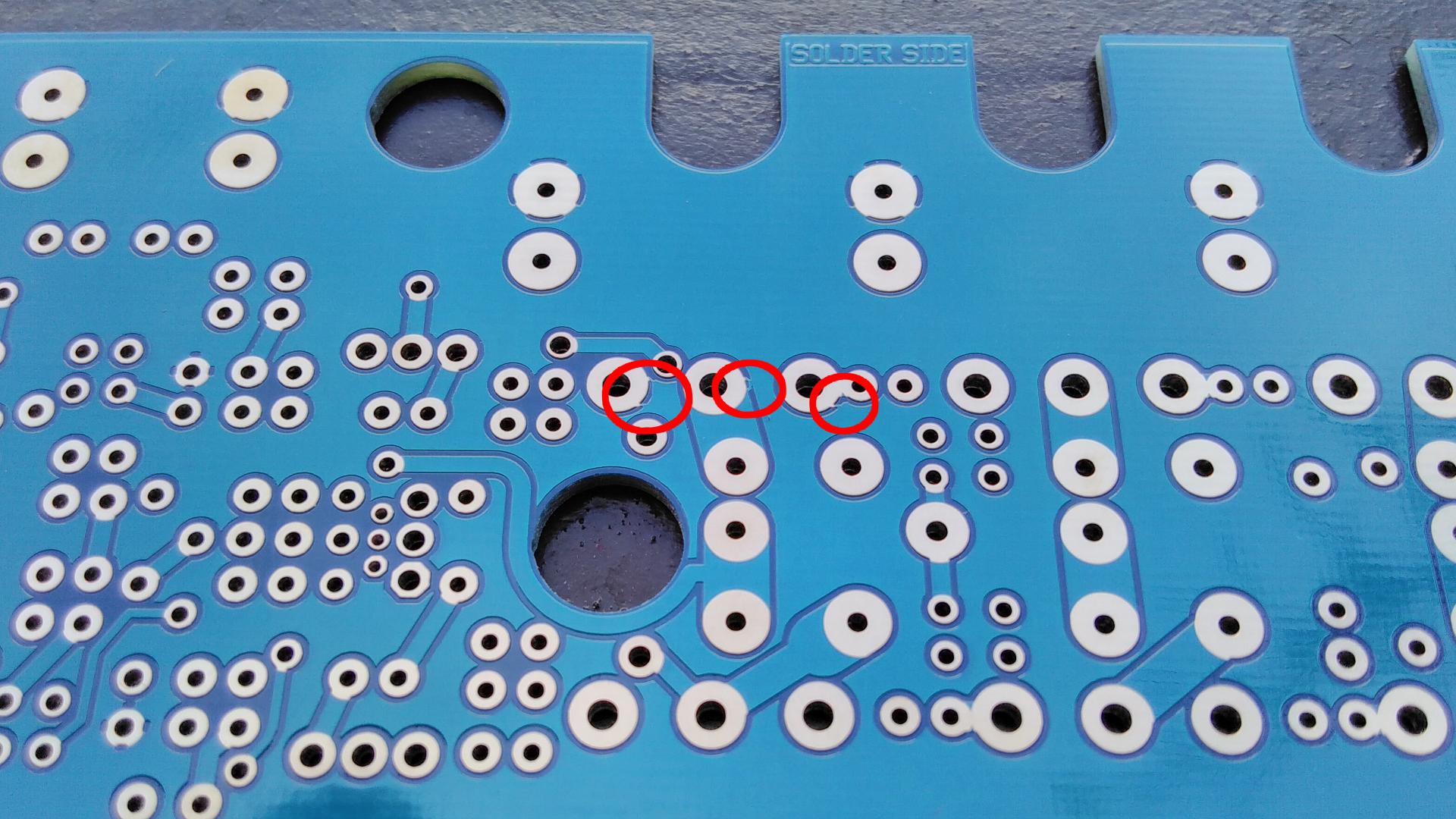

... have a small amount of test pcb's with 3 mask errors for free
(shipping only EU countries; shipping costs!).
Can be made useable using a cutting tool, knife or something else ...
Send an email to
sa2016 (at) aws-it.at
if you like to participate on the beta test ...
BR, Toni
